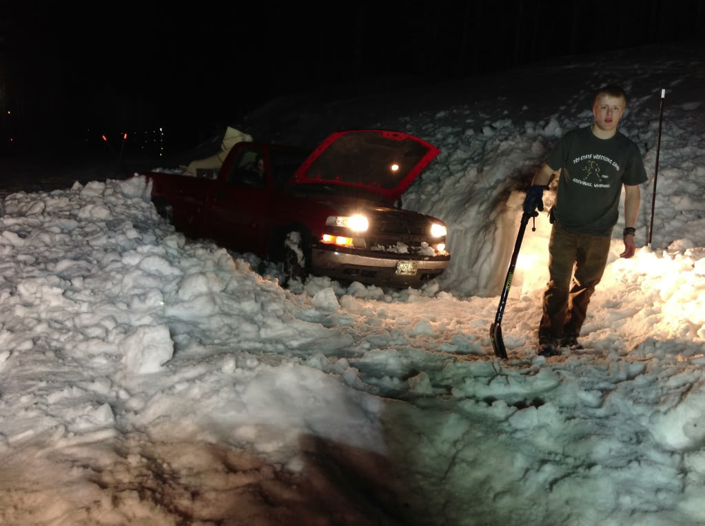

    Yea but when you in those situations where your winching a lot or diging out the truck in the dark like so..
    8ea74492e682013ecc1db3089b225716_zps222b_4497d14fc211f0e3196e578fcce6c91bd7a58749.jpg
    you aren't going to be doing a lot of driving..you idling most the time.
    This was a 12 hour recovery job and once it got dark and all the lights when on and the winch came out..i was not doing much driving. Just idling.
    Ill take the high idle over overall power any day after that trip..super glad i had it.
