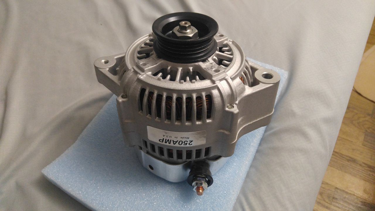

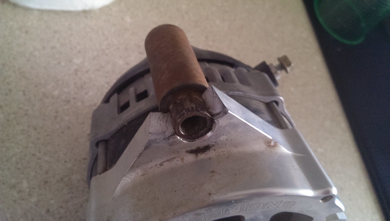

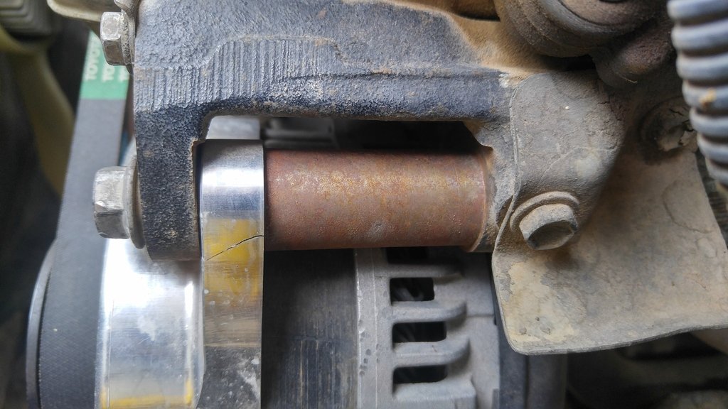

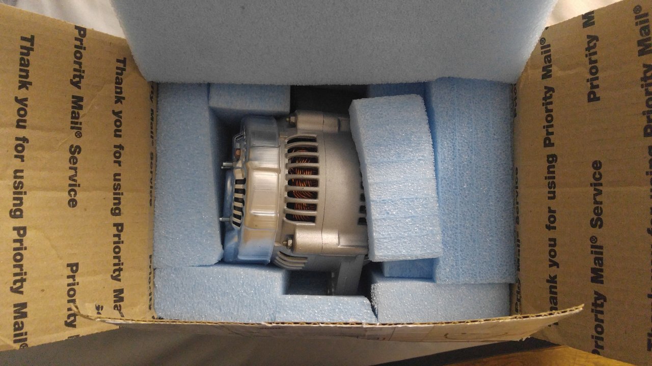

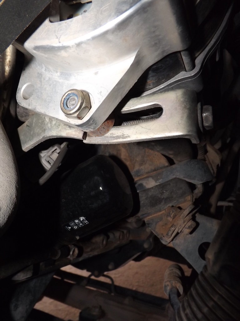

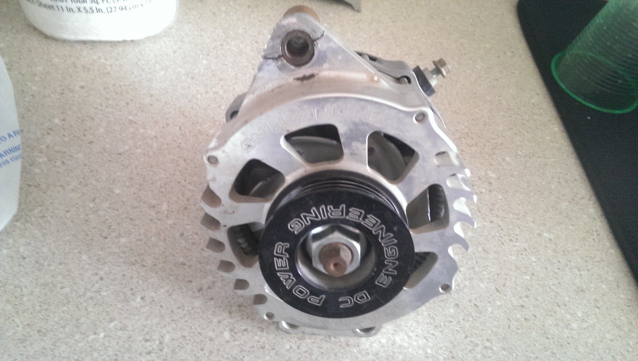

    Mhmm! That's more like it. This case won't be breaking on me for sure. Few unboxing photos, and a comparison to the D.C. alts' mounting system and where it breaks.
