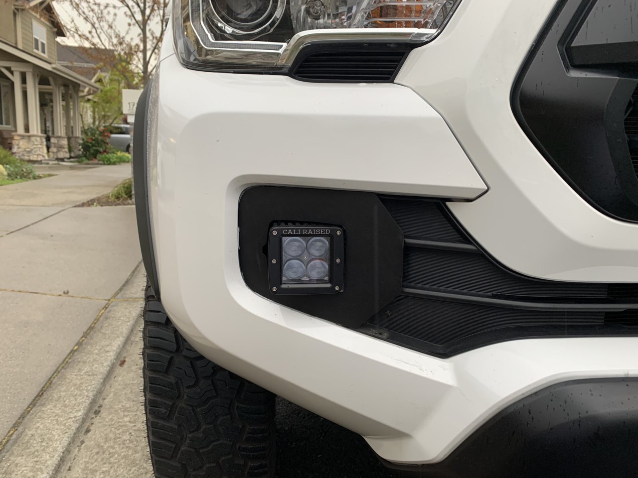

    4EB7A094-713E-449A-A848-561A28B8503D.jpg Amber CaliRaised here as well. No complaints and they “bring things to life”!

    Understands what a fog light is, and recommends the absolute best highest performing option on the market backed by science:
    Fails to understand what a foglight is and recommends illegal poor quality Chinese products that dangerously blind other drivers and do not serve the purpose of a fog light and will be ineffective for the purpose the light was designed for:
    OP, the first group are those you should listen to. Specifically check out the linked SAE thread and the Diode Dynamics SS3 review, you won't be disappointed.

    LOL! Apparently the point went over your head. The Diode Dynamics SS3s are an actual SAE product that have a real engineered fog beam pattern developed by actual lighting engineers to meet strict SAE standards. CaliRaised is rebranded China product with no SAE engineered beam pattern, and definitely not a 'fog beam' pattern in the slightest. They are well recognized for being low quality. Perhaps you should read the thread that covers patterns in detail, including the CaliRaised product:

    The purpose of a fog is to illuminate the roadway shoulder.
    CaliRaised 'fogs':
    Low performance Rigid Pro fogs:
    Diode Dynamics fogs are 2.5x the output of the OEM Rigid Pro fogs pictured above and the highest performing on the market in the same SAE fog pattern. Attempting to tell members to buy CaliRaised 'fogs' and that they are the same as an SAE fog like Diode Dynamics is exceptionally misleading to those that do not know better and demonstrates a lack of understanding of the pattern.
