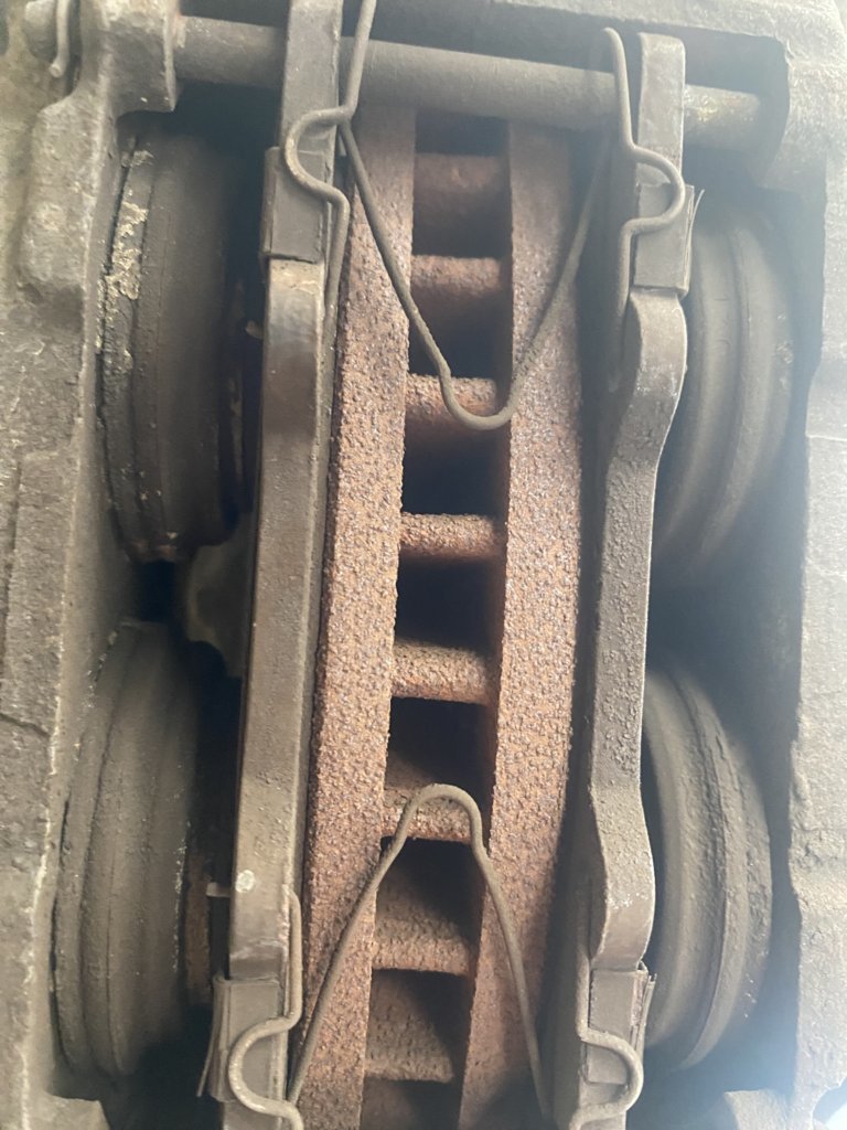

    also here is a picture of my brake pads from November. They have 50k miles on them almost but looked fine to me. But maybe idk what I’m talking about…
    Something I forgot to add was that this sound has been around for a little while. I did my rear shoes and drums not long ago but this sound was here before then. I have noticed in the past that when I braked the sound quieted or almost went away at times. Now it seems pretty consistent and doesn’t seem to change when I brake

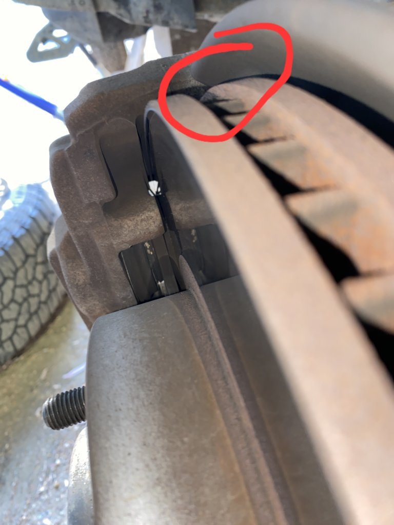

    Is your dust cover rubbing?
    Needle bearing?
    This here looks aweful close.
    Could be the skew of the photo.

    Good idea I’ll take a look at that as well. It’s possible I tweaked it or something when I did my LCAs last year

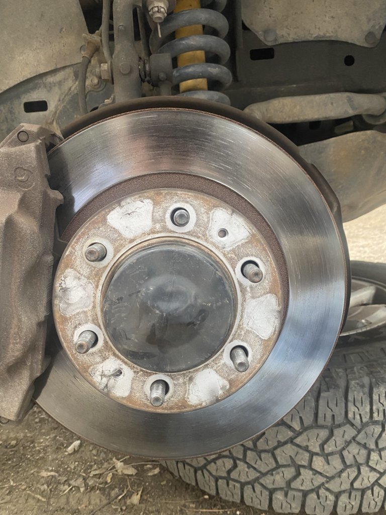

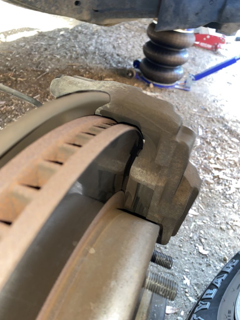

    Ok update: I narrowed the sound down to the front passenger side. Grabbed the wheel at 12 and 6 and tried moving there was no play. Took the wheel off to inspect brakes and noticed that the pads were very thin and need to be replaced. Did not see anywhere where the dust shield was in contact with something. When I spun the rotor I could hear the sound where the pads are. Pads and rotors were done about 50k miles ago. I’m short on money so I’m hoping I can get away with just replacing the pads. The rotor has the slightest lip on it but not bad at all in my opinion. It has visible marks and scratched on it but nothing that I can feel with my finger. I figured I can replace the pads and if the sound persists or if I get other issues from the rotors in the future I can replace them then?

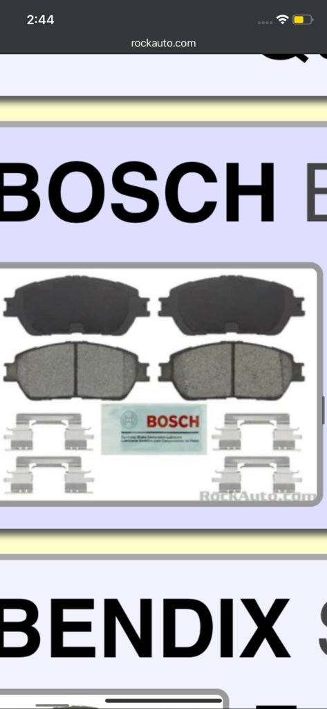

    Anyone have any opinions on Bosch pads from rock auto? I’m trying to be affordable but I’m also weary of cheaping out on brakes of all things

    I put Bosch from Rock Auto on mine. Very happy with them.

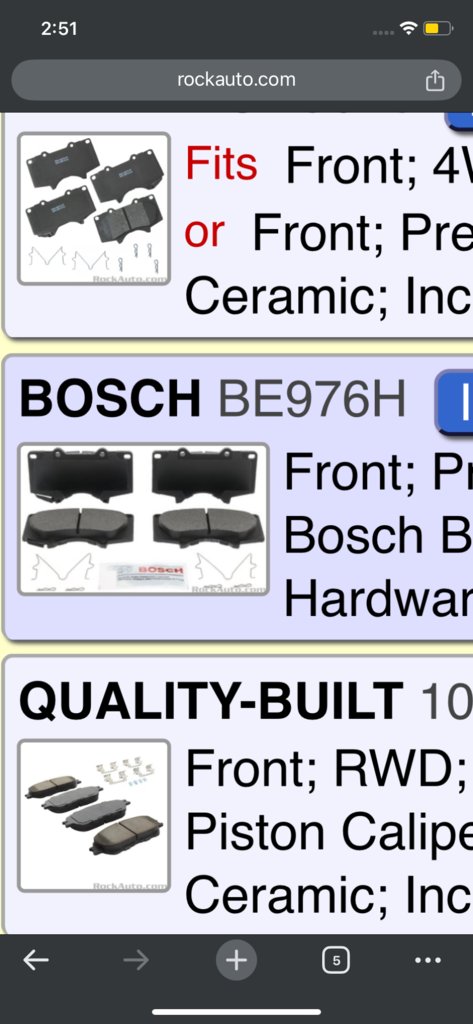

    I noticed that the hardware looks a little different than the ones that are currently holding my pads in. Is that ok? I’m assuming it is…
    even though it says it’s for a pre runner (mine is a base model) this one seems like it will be more likely to accommodate the current hardware

    Wrong ones. Scroll down a little to the ones that say for Pre Runner

    You have no pad left, looks like the squealer hitting the rotor. If thats the case i would replace or resurface the rotors as well. Go with a OE pads or akebono. Make sure to clean up/wire wheel and grease the brake pad slide pins
