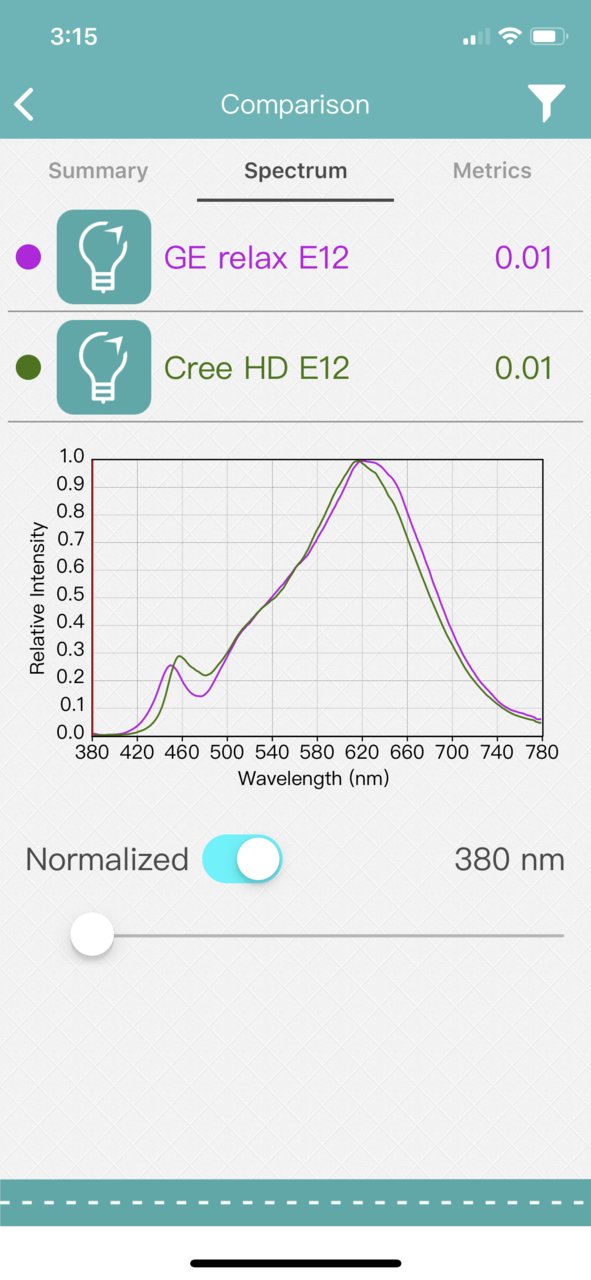

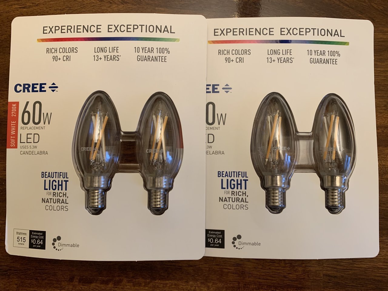

    Had another GE Relax E12 bulb fail today. 3 months and 2 E12 LED failures. Annoyed. The GE E12 design was an older style directionalized light, and Cree has since come out with omni-directional E12 HD lights, so I decided to give those a try instead.
    The Cree’s color quality wasn’t quite as good as the GE (92 CRI vs 94 CRI)
    I think I like the color of the GE units a touch better, but I like the omni-directional light design of the Crees. Switched out the remaining GEs because my OCDness could not handle mismatched lights. The Crees say guaranteed for 10 years.

    Not that it really matters, but interestingly:
    GE: 6.5w 500 lumens
    Cree: 5.3w 515 lumens
    The Crees consume ~19% less power while producing 3% more output.

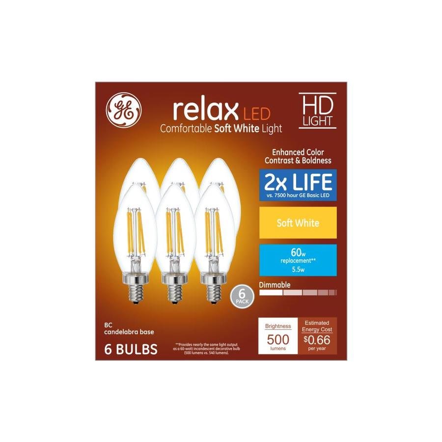

    That's pretty funny. I just bought a 6 pack of new GE Relax E12s today for one of my less used fixtures because it seemed kind of dim and I discovered that it was still all CF bulbs and two had failed. I like the color but they don't subjectively seem as bright as they should be.
    Note that these are 5.5W, so slightly more efficient than your old GE bulbs but still not as much so as the Crees you just bought.
    I find it interesting that these are labeled as "60W replacement" bulbs rather than 60W equivalent, with fine print saying they are "nearly" as bright as 60W incandescents...

    That is a newer generation GE E12 than I was running and do look very similar to the new Crees.
    Nice 500 vs 540 lumens in fine print. The Crees were a tad higher at 515 lumens, but still under the incandescent 540 lumens. You see the same thing with HIRs, they are just a hair less than the halogen equivalent, favoring efficiency over output.
