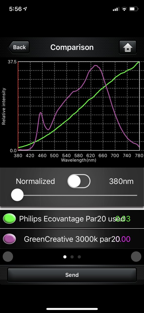

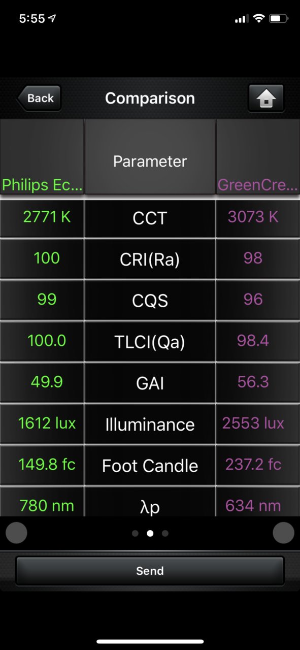

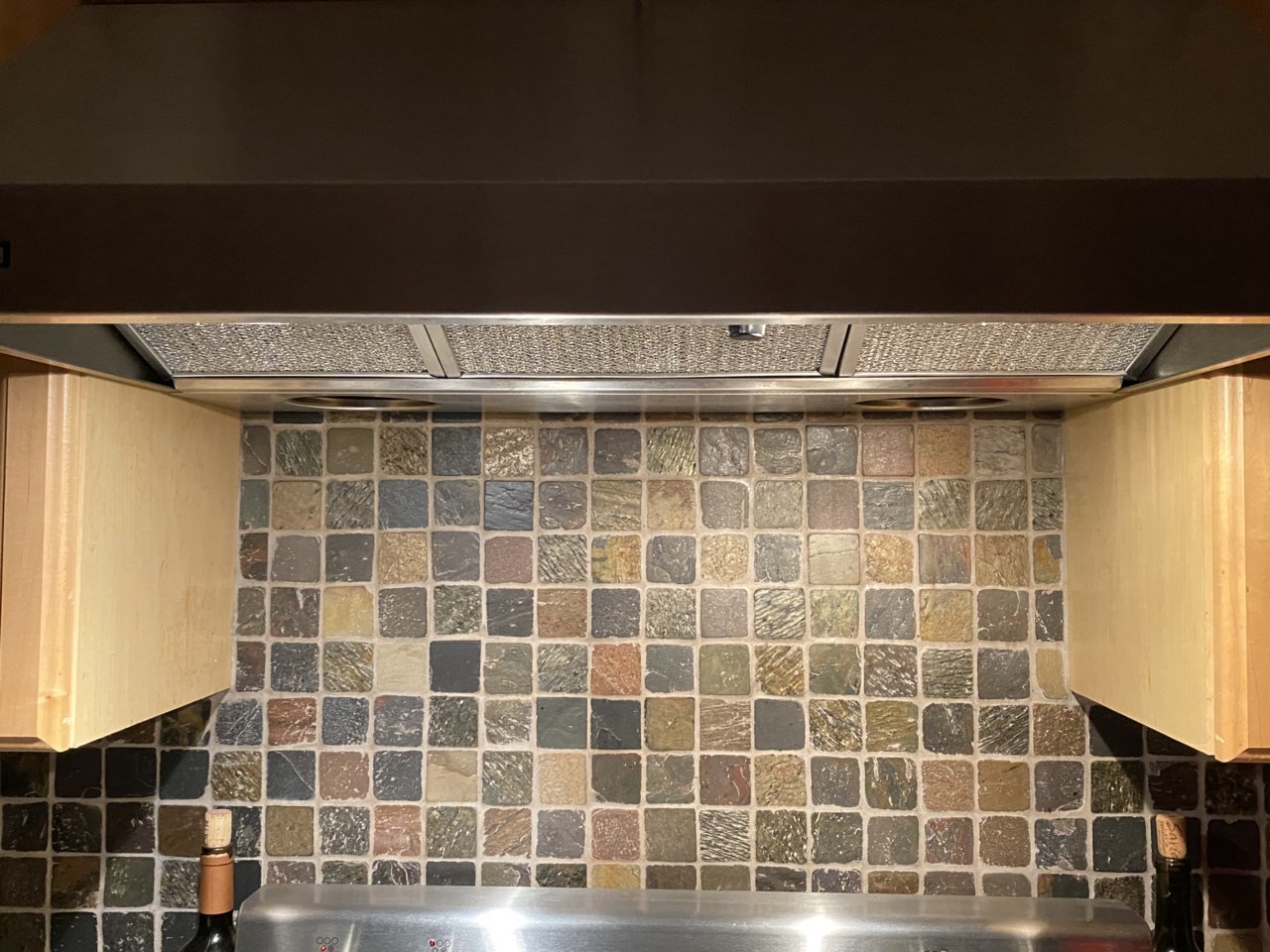

    Tested out the Green Creative 95 CRI Par20s LEDs. I opted for 40 degree flood. The light quality is amazing, but not certain what I think yet.
    GreenCreative LED left vs Philips HIR right
    The LED is noticeably whiter in color than the EcoVantage HIRs. But after checking they are right on the 3000k spec, the HIRs are a little warmer than 3000k.
    These measurements are at end of life on the HIR, they lost a surprising 30% of their output intensity vs first install when I recorded their lux values at 2303 lux.
    The LEDs are a reasonable bump in intensity at 2553 vs new Philips at 2303, without being too bright. The CRI values on the Grean Creative LED are outstanding.
    Halogens dim over time, but I was not expecting a 30% loss. Being that I replaced all the kitchen lights at the same time with EcoVantage HIRs, that likely means all my kitchen output has has dropped 30%!
    Good amount of R9 on the LED
    Spectrum

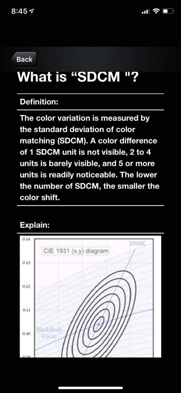

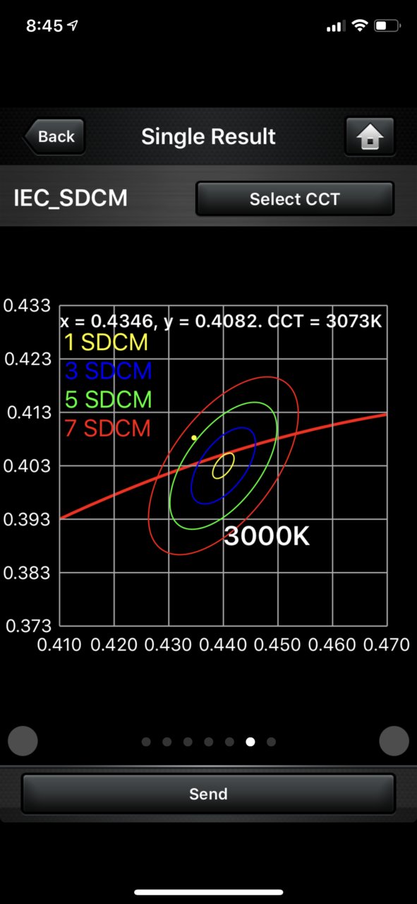

    I thought these standard deviation of color matching charts were interesting.
    The Green Creative LEDs are beyond 5 SDCM, meaning it is ‘readily noticeable’ they are not color matched to 3000k.
    While the LEDs look whiter compared to the HIRs, on their own they don’t stand out as an LED light, though they are slightly higher in color temp than their spec. I’d prefer if it was slightly lower. They are available in 2700k, but I’d ideally not like to go that warm in the kitchen. I’ll have to look into what GU10 MR16 LEDs are comparable to the Green Creative lights for more uniform kitchen lighting color, and so I don’t loose output so drastically over time.

    Im still on the fence on the Green Creative lights, the color rendering performance is outstanding but they are just a touch higher in color temp than I would like.
    I am eying SORAAs for my GU10 MR16 replacements, I’ve got 10 of those in the kitchen so I’ll take a bit more of an experimental approach and try a few different ones as they are pricey! Feit came out with 90 CRI GU10 MR16s which are $18 for a 3 pack, which is appealing compared to the price of the SORAAs. However if the SORAAs look better I am willing to pay more for quality lights.
    I may consider trying them in a Par20 for the hood. Ideally I want all the lights to match color temp in the kitchen and as the SDCM graph shows the Green Creative are just high enough in color temp the human eye can tell they are above 3000k.

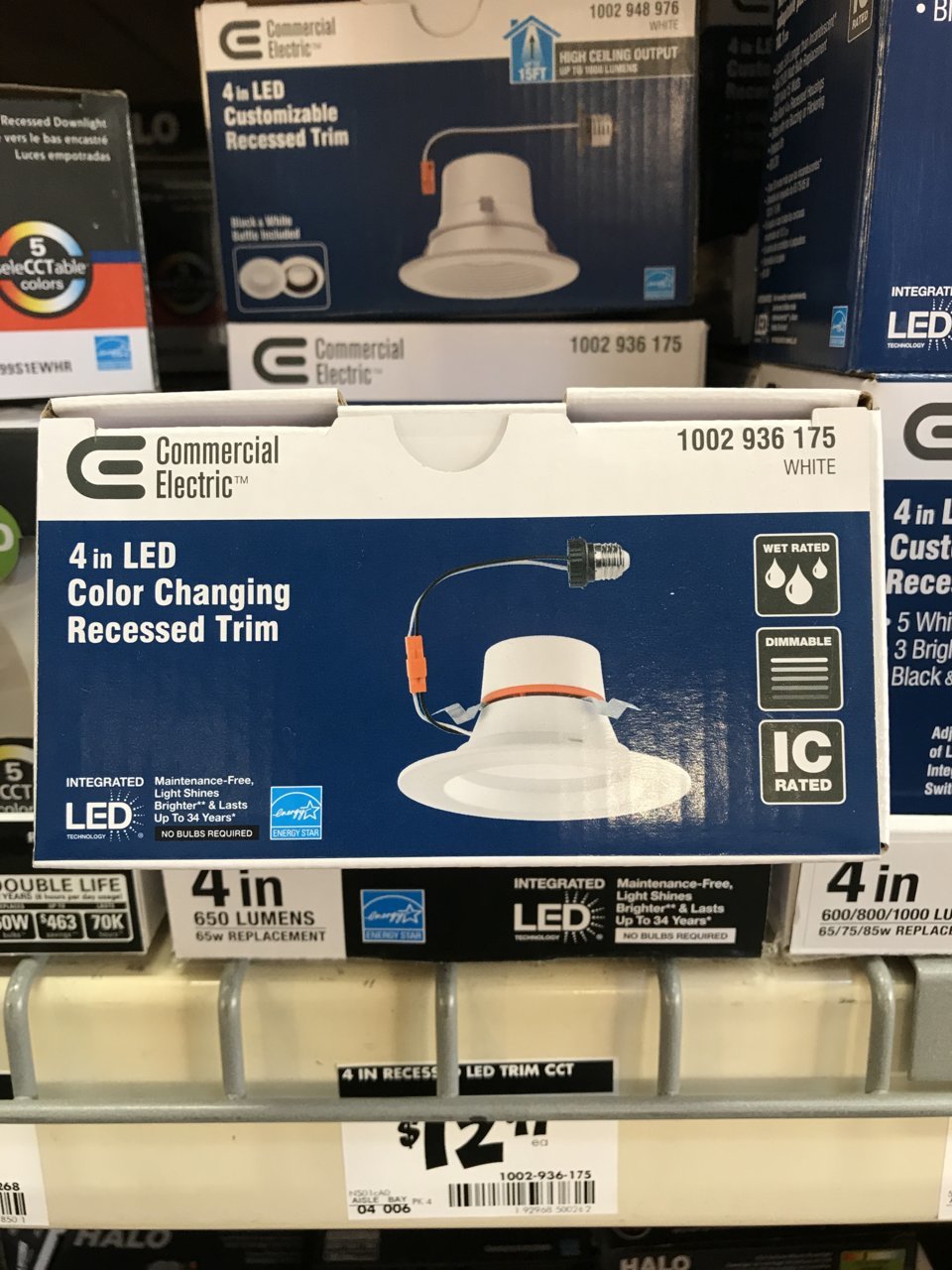

    Hey @crashnburn80
    Just swapped out the recessed lights with these based on my buddy who is an electrician.
    Set them 2700k and they are amazing, both 6” and 4” in 2 different rooms.

    At first I was skeptical of the CRI rating on a color changing light. When I looked at products like Philips Hue in the past, the CRI rating was a low 80 CRI. I liked the idea to color shift the light temperature with the time of day but don’t want to compromise on a low quality light. Based on the specs I found for those (I think they are the same, but the box is orange online), they are rated at 90 CRI, which is among the best I’ve seen in a residential color changing light. Good find! Can you set the color temp on a schedule? Or is it all manual?

    Unfortunately it’s manual, there is a switch on the back of the light housing that slide to witch color that you want.
    The hallway, kitchen and family room are all set to 2700. It’s a nice warm hue that is easy on the eyes.
    The wife is very sensitive to the blue light so she tells me immediately if it’s the wrong color.
