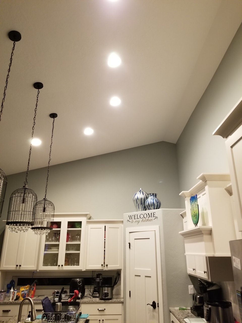

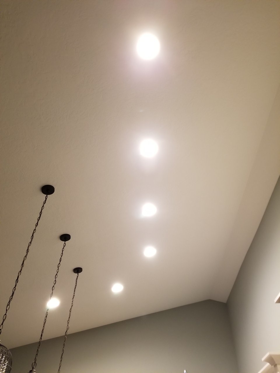

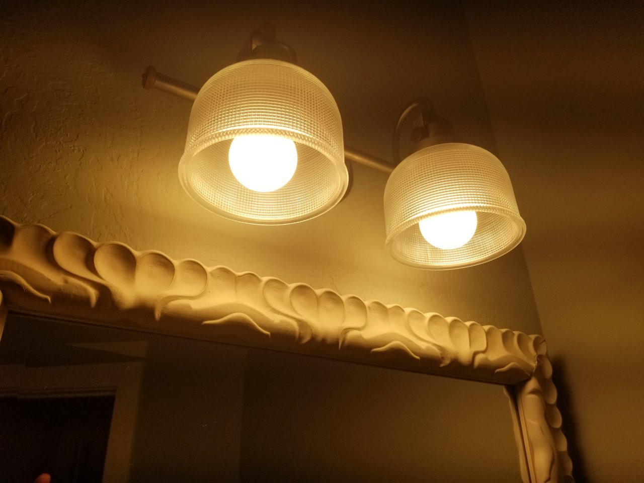

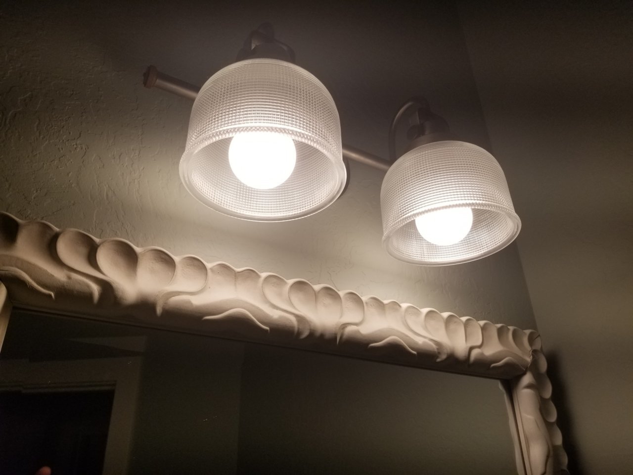

    I was going to try and get a picture of how the light looks (which depending on your screen may or may not work well) but more amusingly than that, my phone was freaking out trying to figure out which white balance to use.
    Those were literally taken one second apart. :laugh:
    The mirror frame is a slight off white so the top picture is obviously more accurate.

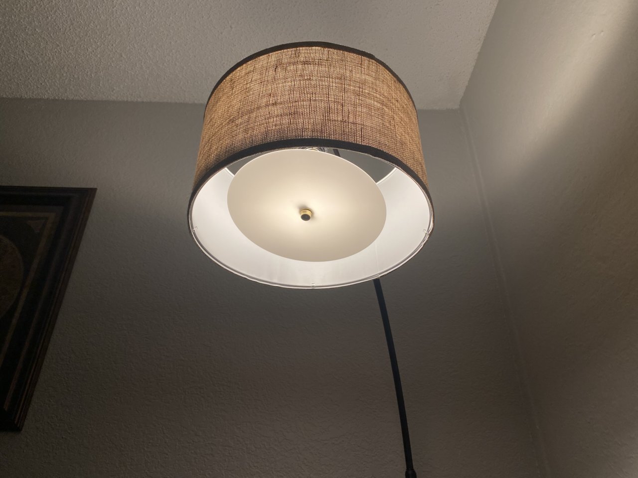

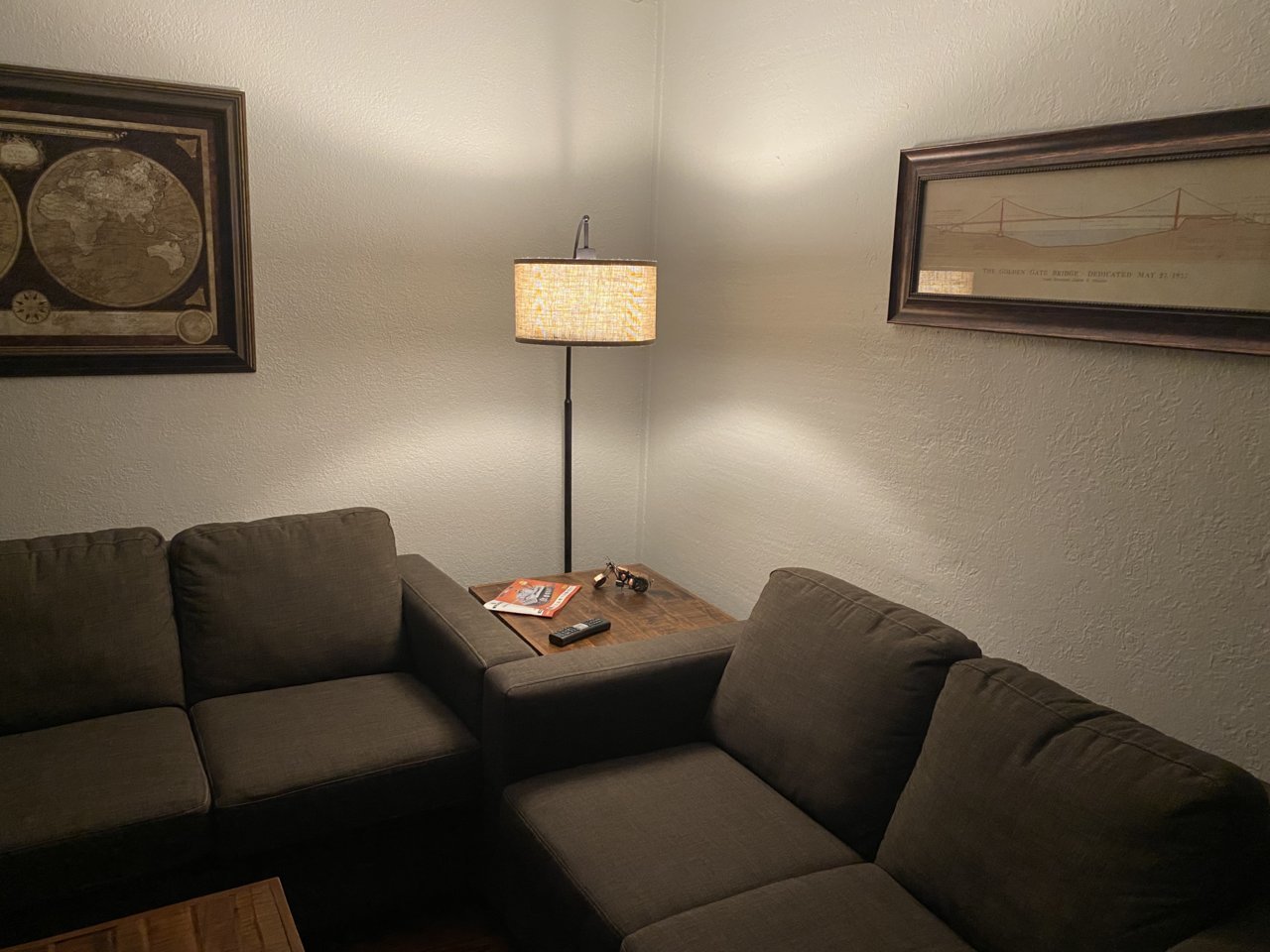

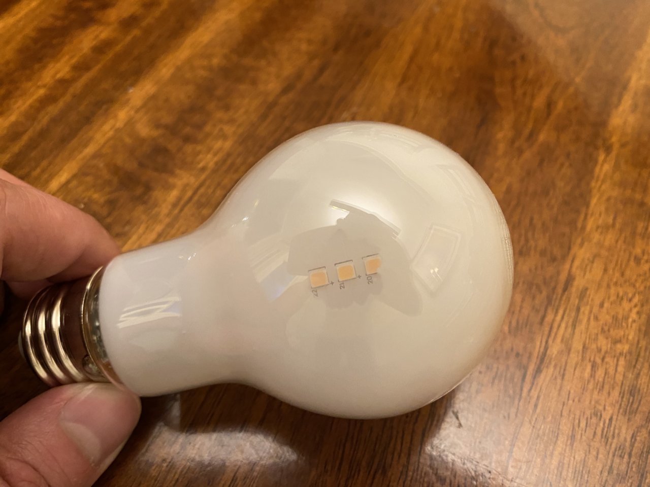

    I used to have a corner table lamp that I never really liked. The lamp looked great but provided too much directional downlight and too little diffused uplight, causing a bright spot in the corner but not much ambient light for the room. I'm not sure why it took so long, but I finally replaced it with an arched open top floor lamp. The pictures do not do it justice, but the amount of uplight that is then reflected off the ceiling provides a very soft diffused light with little shadows covering a much larger area. Output intensity was actually too much with the GE Relax 60w equivalent bulb, so I stepped it down to the GE 40w equivalent bulb, and while drawing less power it provides significantly more light for the room, but in a much softer diffused appearance perfect for late evenings.
    One thing I did not like, is if you were sitting next to the lamp you could directly look at the exposed bulb from the underside, which was harsh and unpleasant. They make diffuser panels for this purpose, though they are often intended to defuse upward light by installing in-between the top of the lap and the lamp shade. In this case I wanted to install it on the bottom of the lamp to defuse the direct down light. Using a lampshade clip (intended to attach a lamp shade to a bulb) and a lamp shade diffuser run on the bottom of the lamp, I was able to solve the direct light problem. I went small on the diffuser panel to let as much light through as possible, but should have gone a size larger. The smaller diffuser requires a slight tilt to block direct light from those sitting below the lamp.
    Overall I am very happy with the light upgrade. I did also purchase a 3 way switch to convert the lamp to be higher power for the daytime and lower power for the evening, but the switch was not compatible with the lamp. With the amount of windows in the room, higher daytime light is really not necessary so I'll leave it as is for the time being.

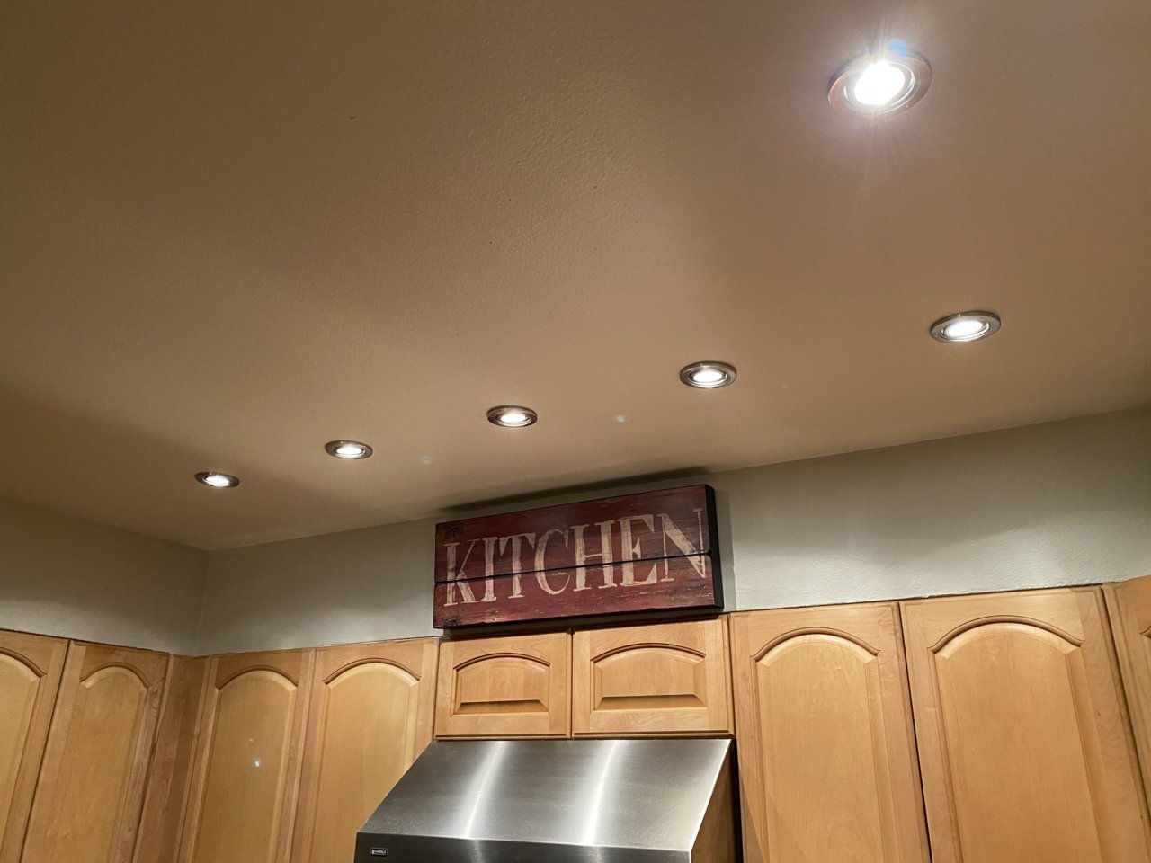

    In the kitchen I have recently lost multiple HIR GU10 MR16 bulbs. I had a few spares on hand to swap out with, but it is clear the kitchen bulb set is reaching EOL as they were all replaced at the same time. I plan on replacing the 10 light set with SORRA LED 95 CRI 3000k 60 degree wide-flood bulbs. I have 6 recessed ceiling lights that follow the counter line, 5 in a row on the back wall of the kitchen and 1 that steps forward in an L shape over the sink as well as 4 that hang down from the ceiling in a fixture that can be aimed. See my basic ASCII art example below. The light that comes out over the sink has a disproportionate amount of counter space to illuminate compared to the other lights, as well as being a primary task area, it should really have 2 lights.
    _ _ _ _ _
    .............| <-sink light
    ...............<-counter area with no overhead light
    My thought was to use 50w equivalent (7.5w) 60 degree wide-flood lights for the entire kitchen and a 65w equivalent (9w) 60 degree wide-flood bulb over the sink area. My hope is that in an area slightly deficient in light, the extra light in a wide flood will seem balanced and not become an obvious hot spot of uneven lighting.

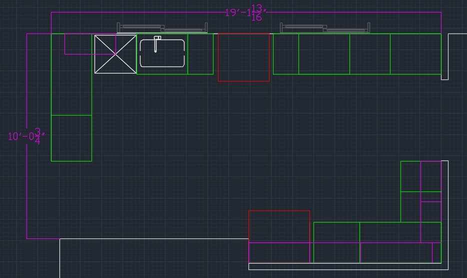

    Anyone know of any useful guides on how many can lights should in a given space? Specifically a kitchen?

    Mine are right about 36" OC.
    For yours, I'd be inclined to consider pushing them to about 6 foot OC the 10' direction to get it closer to your work surfaces.
    Some lighting websites have a foot candle calculator that you can play with. Do you know what kind of lamps you're going to use?
    Edit: Lithonia Visual Interior Tool

    Mine are 16” apart with 8’ ceilings using GU10 bulbs. Ideal spacing will depend on your light fixture type, output intensity, beam spread, and fixture elevation.

    Halo HLBSL 4” was the plan

    Home Depot has them listed at 716 lumens and 3000k. If you're using the Visual Tool, the Juno Lighting 4RLD G3 06LM is pretty close to the Halo. Then all you need to do is put the room dimension and footcandles you want in and it will give you spacing and quantity.
