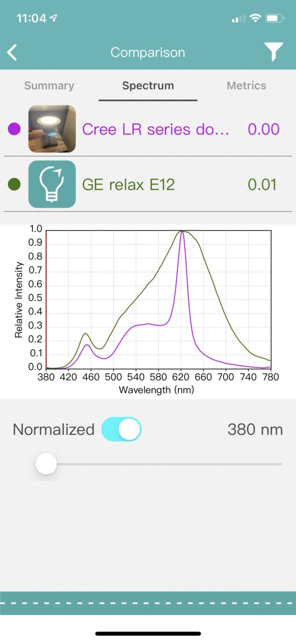

    Interesting. I wonder how that uneven distribution manifests to the eye / brain. I know the failure mode where they end up with a big red shift if the yellow LED fails is rather unpleasant but for normal operations does the brain subconsciously detect this spike even if it doesn’t realize it is detecting it?
    I don’t think I ever measured current draw either.
    I also was not sure if the other bulb with the newer design corrected any of that?
    What I should probably try next is a side by side viewing of the GE vs Cree to get some subjective impressions.
    The last part of their marketing was about the light distribution, it’s supposed to be an even cone out to 6’ or so from 8’ height. Since my ceilings are 10’ I noticed a big improvement in distribution over incandescent bulbs in the halls and closets as well as over the fluorescent tubes in the original kitchen lighting. I don’t suppose there is any way to measure / compare that part of the beam?

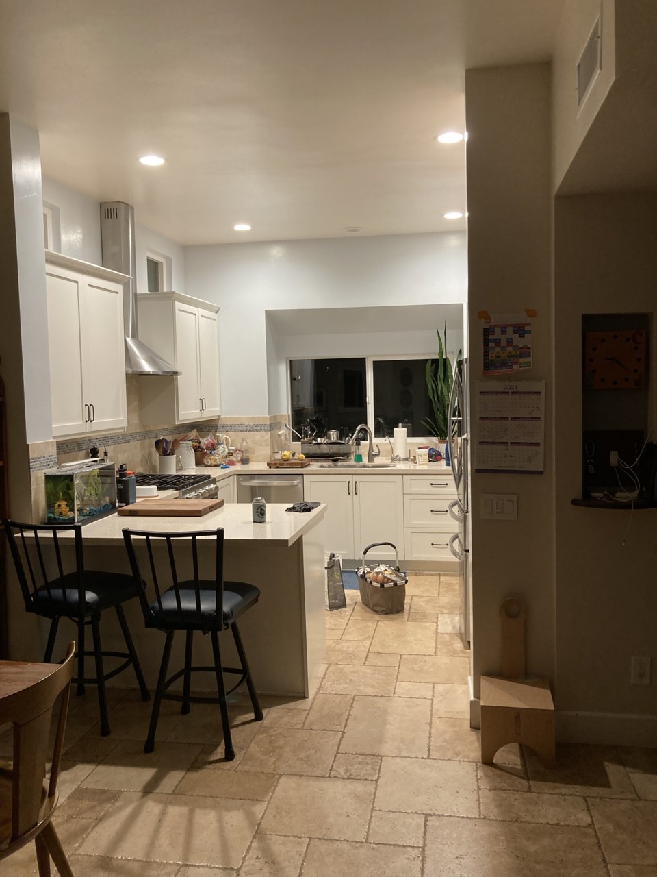

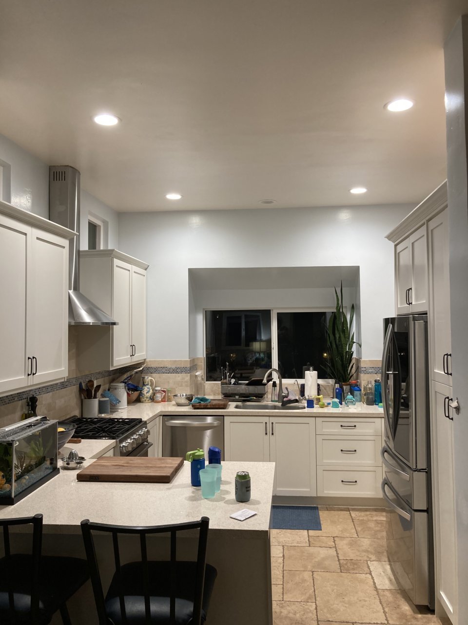

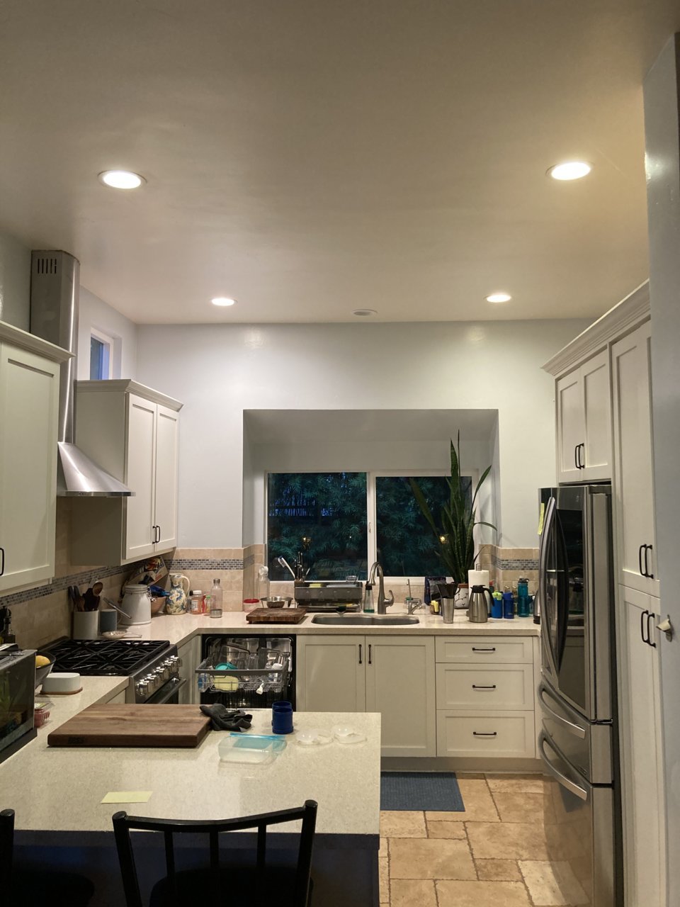

    Photo of one new light and 3 old lights looking directly North. I’m not sure how noticeable the difference is, but like the movie, North by Northwest is where it’s at.
    ETA: I just swapped the other 3. I think I need a dimmer now. These things are rather powerful.
    Consensus is, too bright. I have dimmer switches on order but I am going to try the 100’s to replace these 150’s and move two of the 150’s over the dining table.

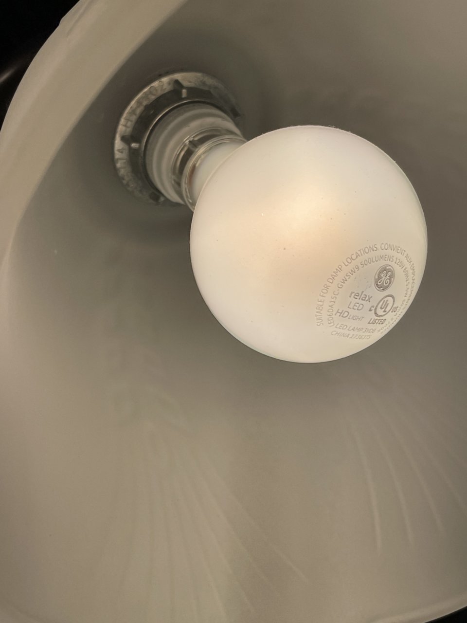

    I use the GE HD Relax b10 in all of my ceiling fans.
  12. May 10, 2021 at 2:25 PM
    #112
    MrMccrackin
    MrMccrackin Well-Known Member
    Nov 21, 2017
    #236566
    1,038
    Gilbert, AZ
    2004 TRDOR PreRunner, 2017 MGM TRDOR 4x4
    Here is what I am working with

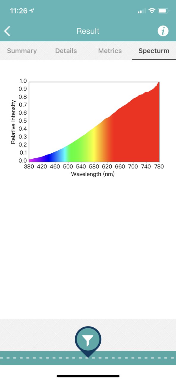

    Insane record breaking 109 degree temps sustained over many days in a region where summer temps seldom top the mid 80s, and where most homes and many businesses don't have AC have caused serious pause for use of halogen lights in the home. All Kitchen HIRs are strictly off limits. Bathroom lights that had been reduced from 4x 50w fronted halogen bulbs to 4x 40w clear bulbs have now had 3 of the 4 bulbs removed from the fixture to only utilize a single bulb to minimize heat output while still providing useful light. Since the garage is under the living space and I installed some ultra high thermal efficiency doors, I've been parking the truck outside to cool down in the heat, rather than parking a hot truck in my cool garage which would use up my cold air storage bank. Ironically I installed the doors to hold the heat in as a workspace in the winter. It hadn't occurred to me I'd be insulating the garage from hell outside to keep the workplace place cool. All lights, even the LEDs, are turned off unless absolutely necessary. But when required LED lights are used when possible to minimize heat output.

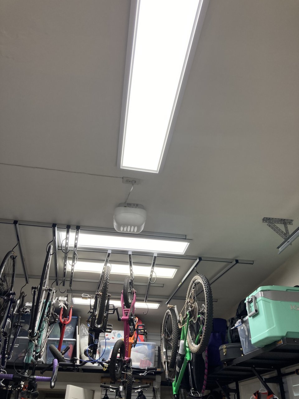

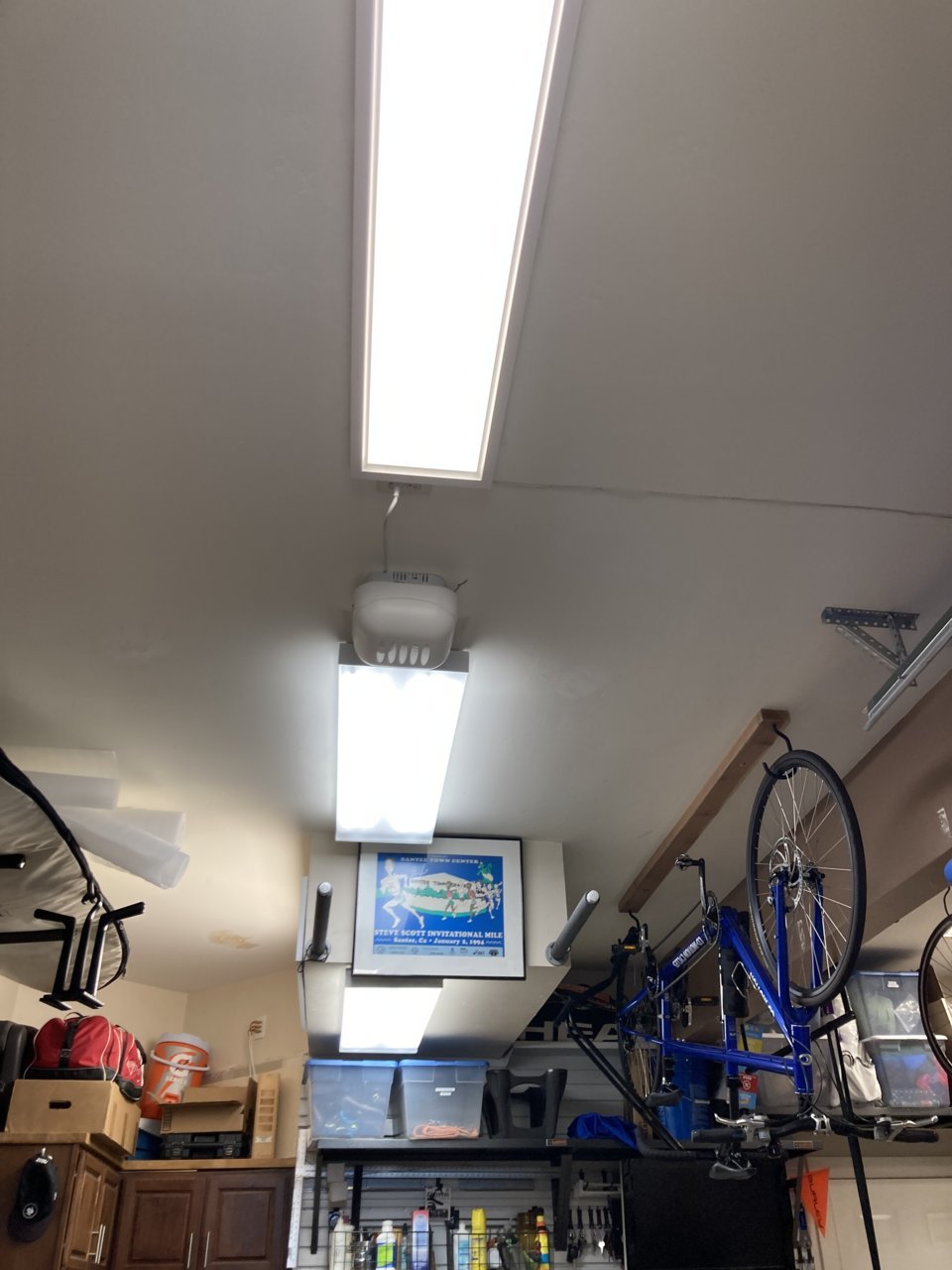

    Costco instant rebate means 2 more of 8 panels converted from fluorescent w led bulbs to straight led panels. I also like the color better. Might finish off the last two this week just to have full uniformity.

    Nice!
    what are they rated to replace 40w?

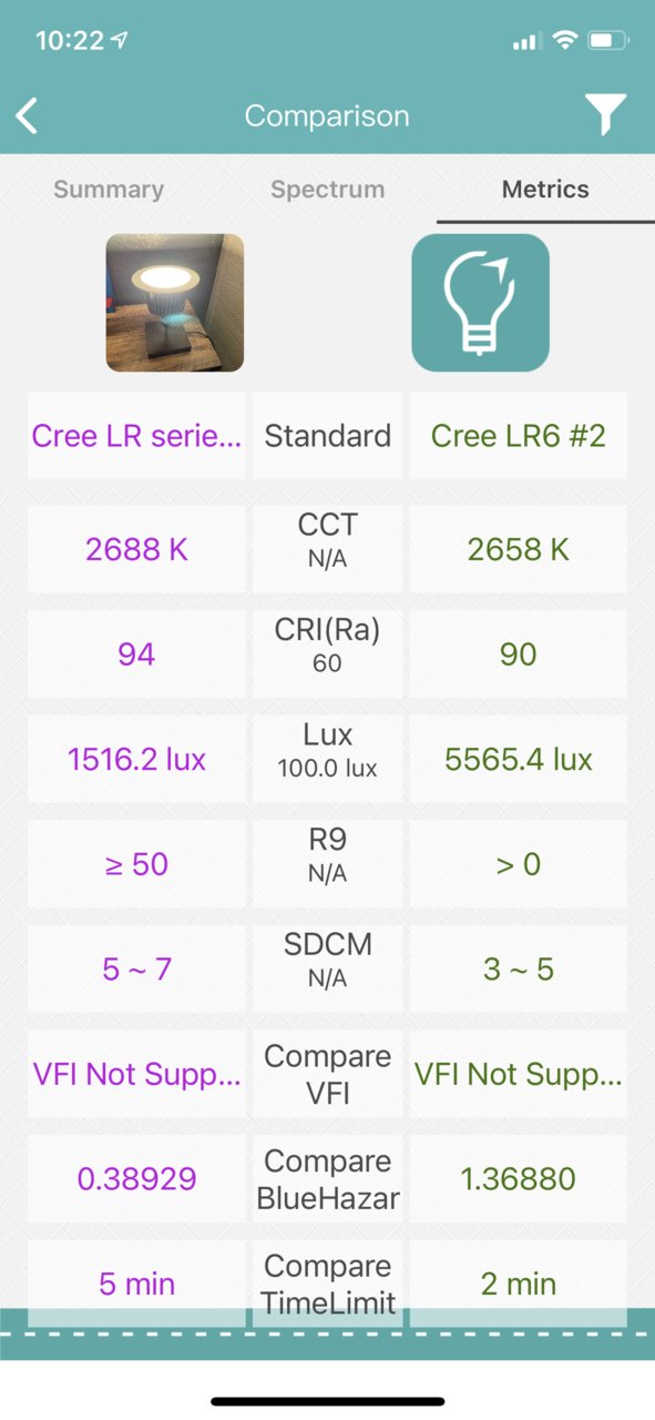

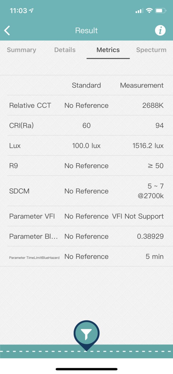

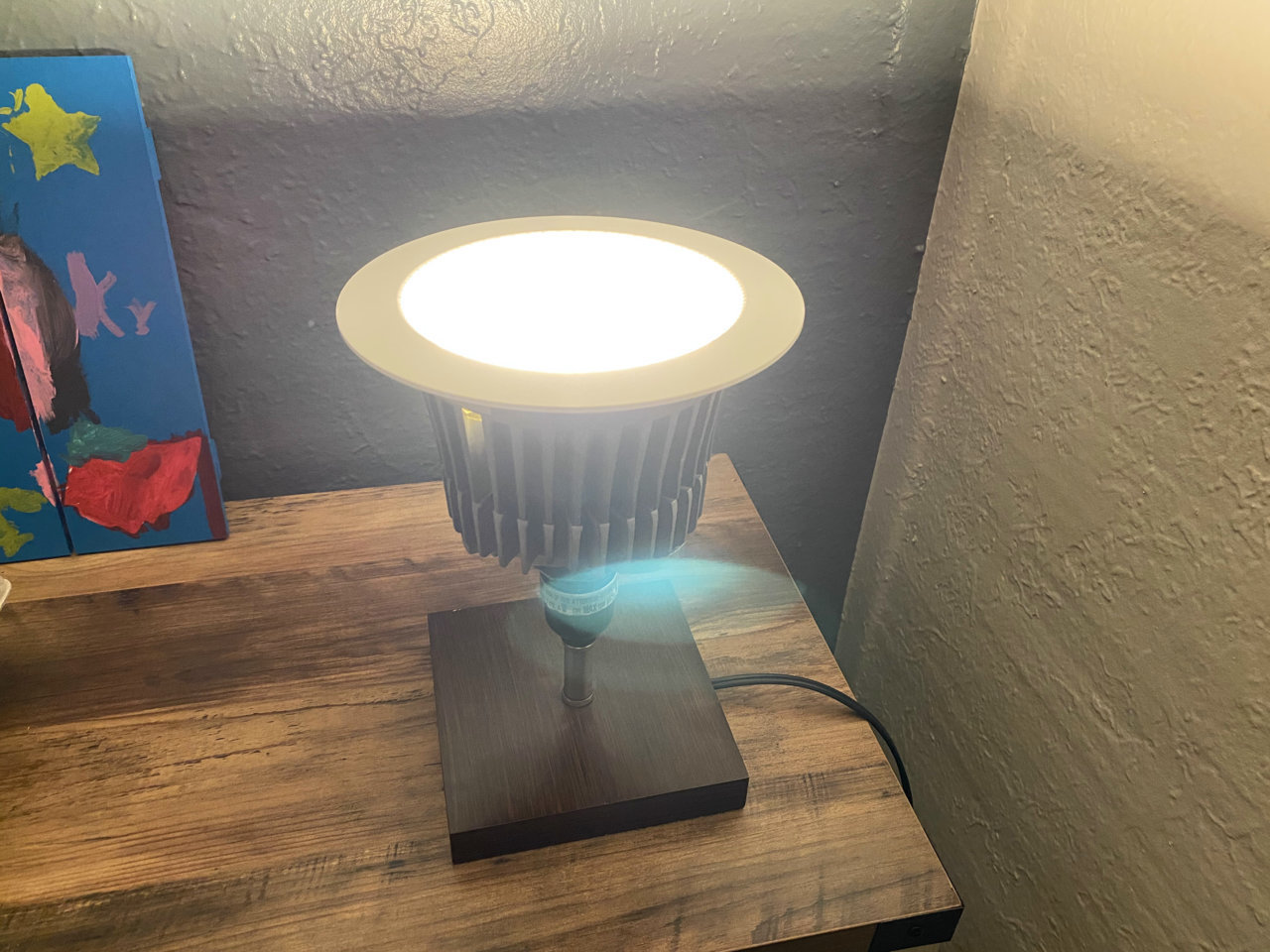

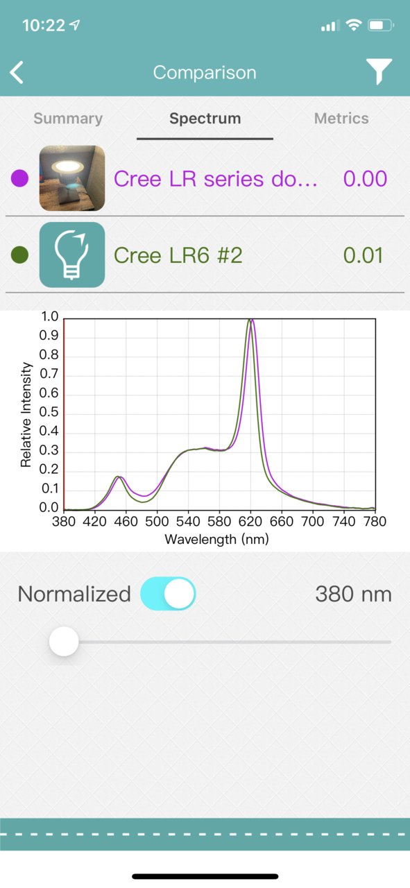

    I finally got around to testing the newer version of @daveeasa Cree lights. The #2 lights are the newer units vs the older original units.
    58C16DFE-3D39-4A82-8663-7420858BF7B3.jpg CE6D4A7B-10D8-4D8C-8C2F-0832D9F257D7.jpg
    The spectrum is almost identical, as is the color temp. Ignore the lux intensity values since the distance was not standardized and is using a normalized comparison, though interestingly the older units have a slightly better CRI value, but both are still in the 'HD' light range (90-94CRI). Impressive performance for older home lighting units as most consumer grade LEDs back then were in the low quality 80 CRI range, which was adequate when competing with the awful CFLs but nowhere near the quality of the outgoing incandescents.

    Sorry I missed this.
    Specs appear to indicate 46W.

    Thanks!

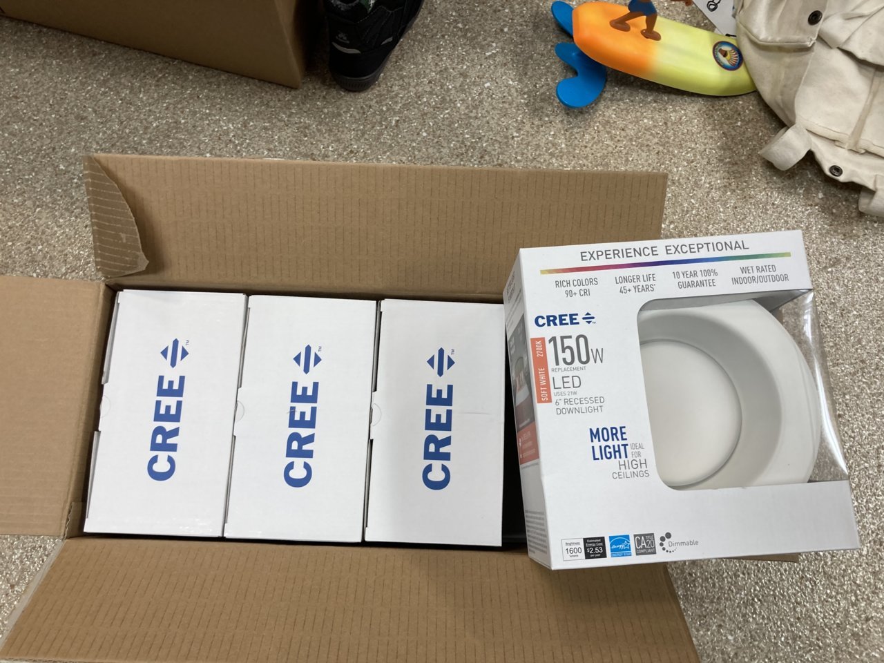

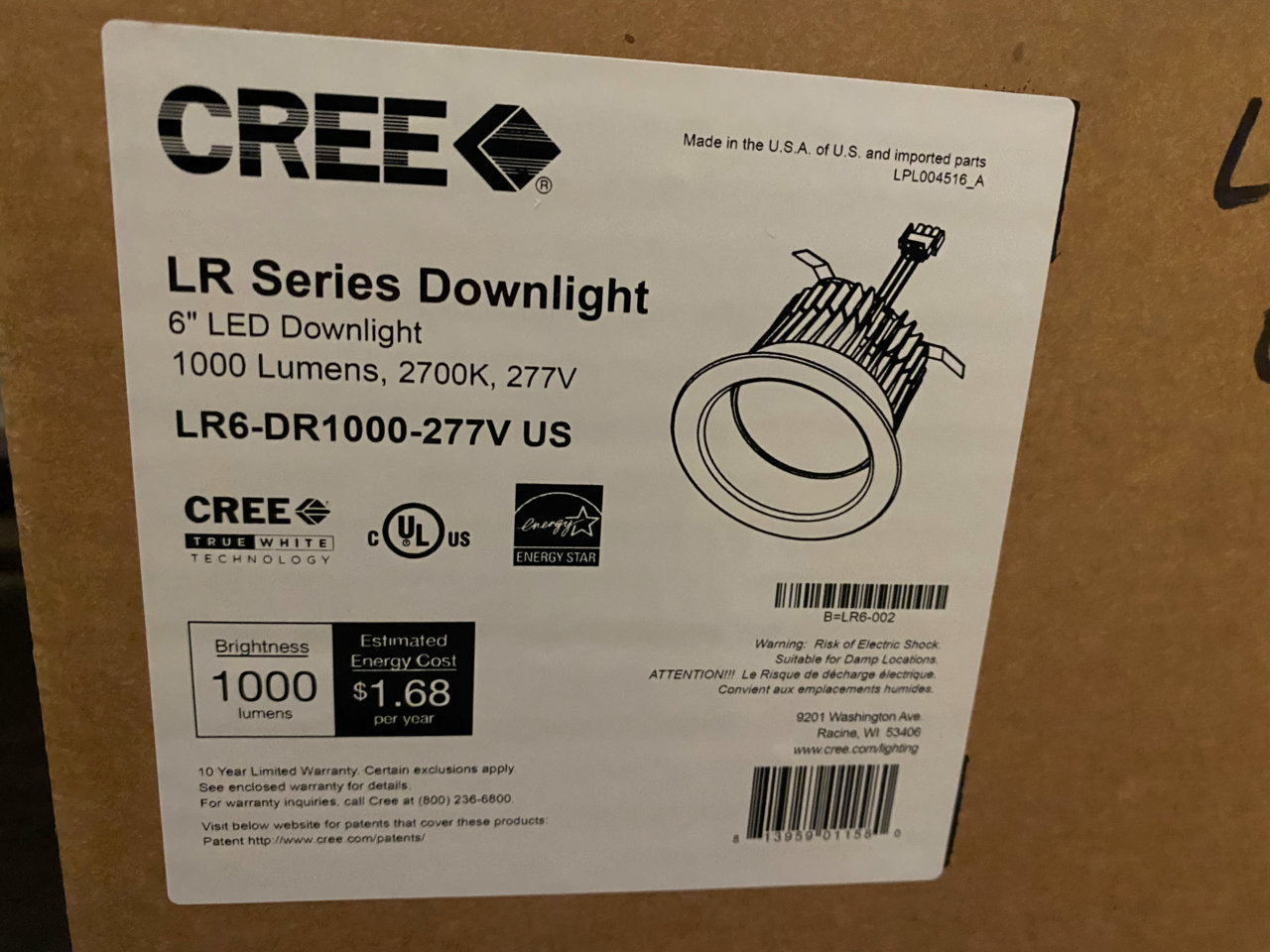

    Based on your testing and review I’ve swapped kitchen and dining room to these more modern Cree 6” down lights. The 150’s were too bright for the kitchen mains even with a dimmer so I moved them to the dining room where I only have 2 bulbs and they work pretty well there with a dimmer. Kitchen is 100w x 4 and then I have a 5th 150w on the sink which just never gets used. I would honestly like to hard wire it to the other 4 and use the switch for under cabinet lighting instead but the time for that was before the kitchen remodel. Oops.
    I’ve been tempted to replace the rest of the old ones (laundry, bathrooms, master closet, upstairs hallway) with the new THD versions but haven’t prioritized it. It is really fantastic that we have seen such improvements in a rather short time span.

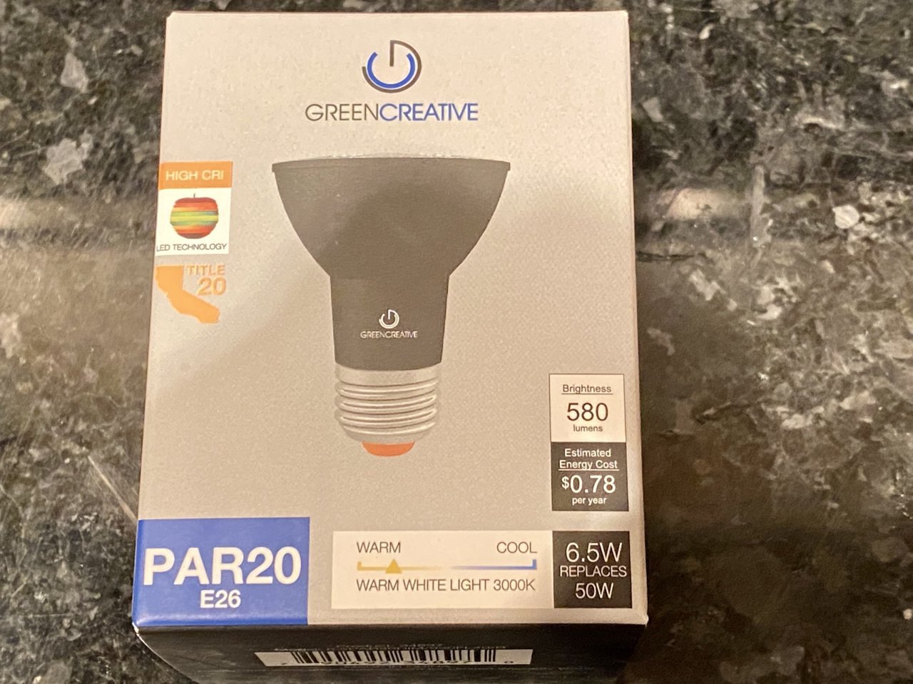

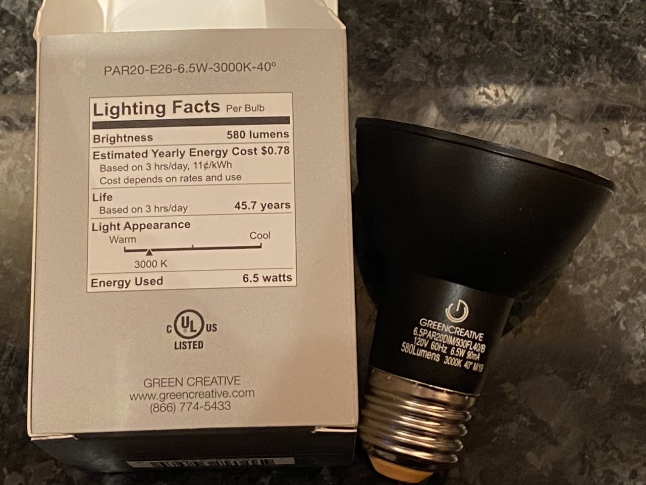

    Somewhat embarrassing to say I finally replaced the defective hood par20 lamp. Of course couldn’t have chosen a worse time as nearly everywhere seemed sold out with product shortages to match my existing Green Creative UHD 95+ CRI 3000k 40 degree flood Par20, but found one place that still had them in stock:
    https://www.beeslighting.com/6.5PAR20DIM-930FL40-B?keyword={bkeyword}&creative={bcreative}&gclid=EAIaIQobChMIg86t3N6q8wIVBBLnCh3G_Qa-EAQYASABEgL2hfD_BwE
    The box lists 45+ years lifetime, hopefully that is more accurate this time.
