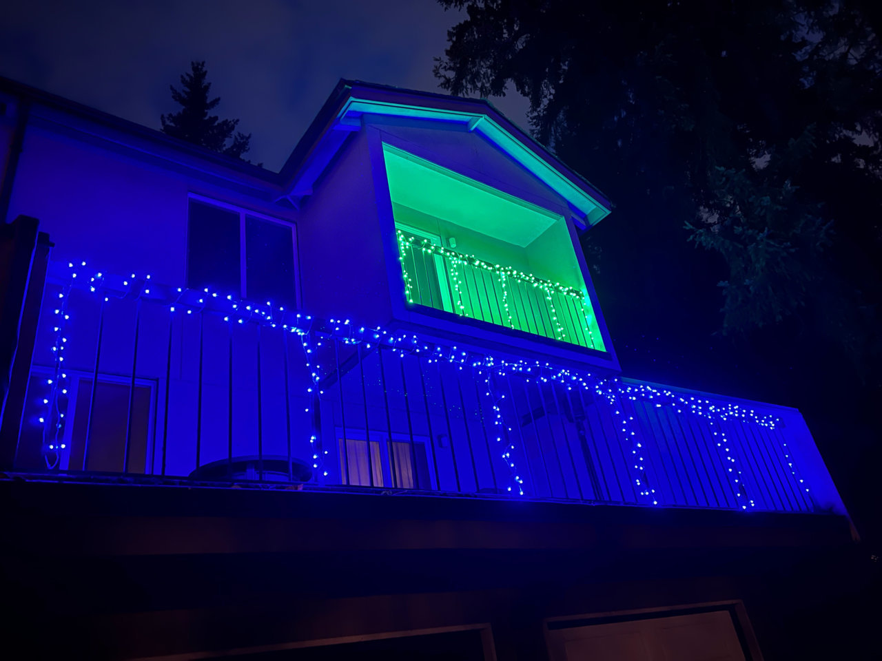

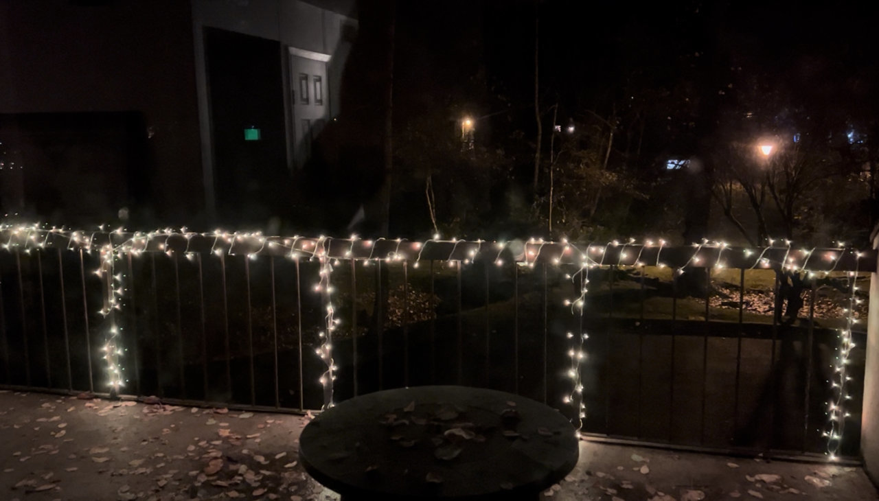

    Made the switch this year to programable LED RGB Christmas lights, change the colors at a touch of the remote.
    For Seahawks game days, switch to blue and green.

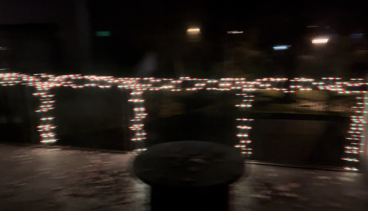

    But. I hate them.
    Forgive the indoor pictures of outdoor lights, but this is the yellow/warm white setting, which is actually very yellow. The pictures look better than they do in person.
    But when you look away, turn your head or first glance at the lights, I see this. The raw Red and Green. It is super distracting. This picture has the lights on the same setting as above but is just taken while sweeping the camera vs holding it still. Only time this doesn't occur is if using only Red, Blue, or Green. It starts to make you question your sanity.
    Next year I'll likely go back to traditional and maybe just put these up for game days. TBD but these are pretty awful.

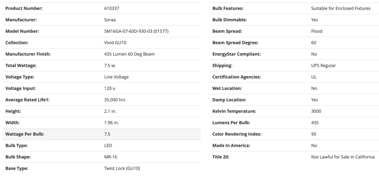

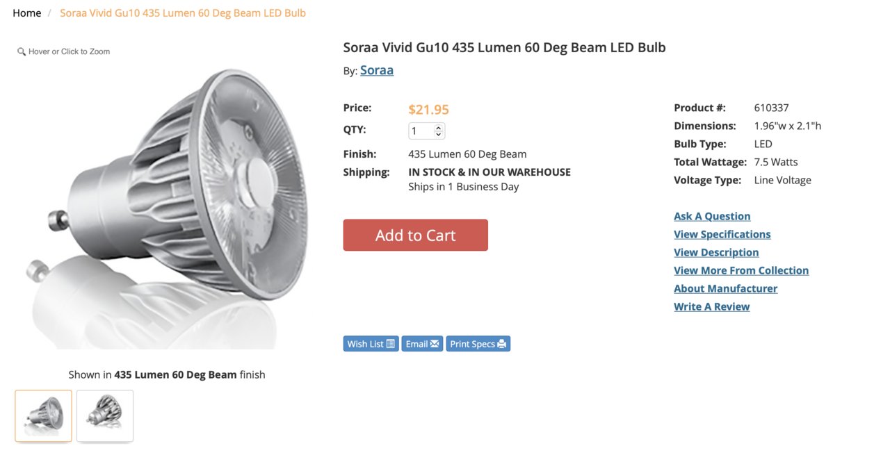

    Lost another GU10 in the kitchen, I'm out of HIR EcoVantage GU10 spares and they don't make them anymore. I had been using some 50w halogen spares but ran out of those too. I found some HIRs on ebay for a pricey $11-12/ea, but I figure it is time to try some quality LEDs again in the kitchen.
    Ordered 9 Soraa GU10s, 95 CRI 435 lumen in 60 degree flood

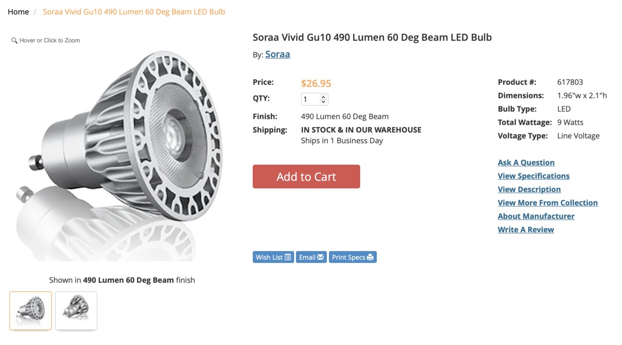

    And one single higher power 490 lumen model for above the kitchen sink, where I'd like a little more light, also in95 CRI 60 degree spread.
    Its worth noting a standard halogen flood 50w GU10 is 410 lumens when new, so the 435 lumens will be a little brighter. Many of the 95 CRI rated GU10s are a fair amount lower than 410 lumens, which I did not want to do. This also makes the Soraas not efficient enough to be legal for sale in California, but they will be far more efficient than the outgoing 39w HIRs and 50w halogens are 7.5w and 9w. The standard halogen flood is 40 degrees from what I could find, the Soraas are available in 35 degrees and 60 degrees. I didn't want to reduce the spread, especially in an LED format, so I went with the 60 degrees figuring the pattern overlap between bulbs would makeup for the wider pattern spread reducing intensity for a single one. Fortunately Destination Lighting has a generous return policy. TBD.

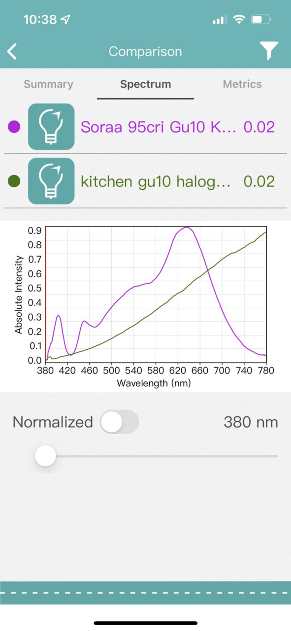

    The Soraas are beyond phenomenal. I opted for the 60 degree 7.5w flood in 3000k for the over counter 8' ceiling mounts in the kitchen. The Soraas hit the 95 CRI mark with significantly brighter output, providing very rich colors. They do have an unexpected spectrum drop out at just over 420nm though color seems completely natural.
    26139CE2-7CC6-4112-A91E-FBEA2F7E9FAB.jpg 37A8E205-BC17-4A24-A58C-0E19640BF73F_1_102_o.jpg

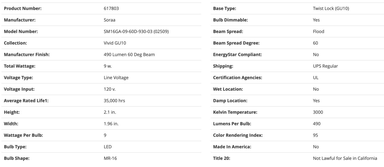

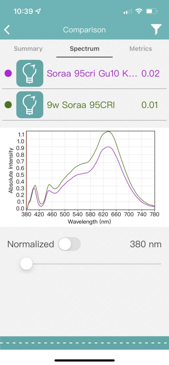

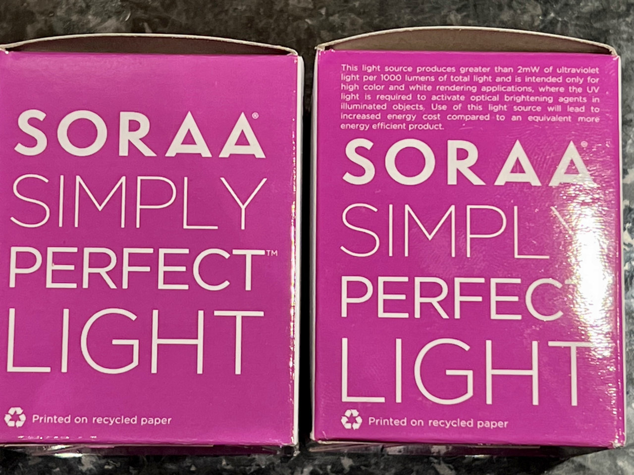

    I desired a little more light over the sink area so opted for a higher power 9w version of the Soraa bulb (vs the standard 7.5w), just for that location. The results were perfect. Measurably higher light output intensity while not appearing obvious to the casual observer.
    95714B0D-25FB-42E0-A0F8-7FE6F4DD5C98_1_102_o.jpg 9366DB35-AE3F-4F8B-BF8F-FB019BABF38B_1_102_o.jpg

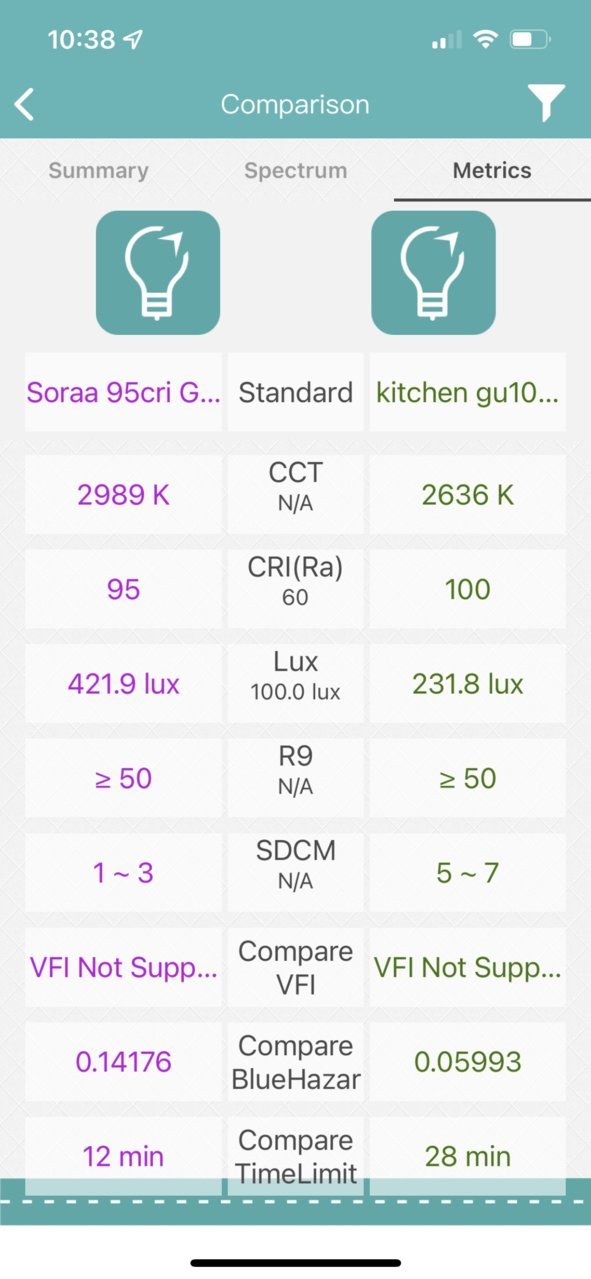

    Interestingly the 9w bulb must cross some threshold, because it contains a UV warning, whereas the 7.5w with the exact same spectum curve does not have the warning.

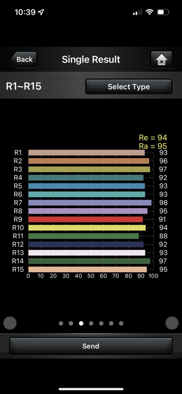

    Sexy AF. Would you look at those R9 values. These bulbs are so amazing. I can't tell you how many LED bulbs I've tried in this application from major name brands just to have wash out, low quality light, lack of red representation etc. There is a reason I've run performant halogens in this location over LEDs in the past.
    One of the issues with a GU10 LED is they do get rather hot, despite the misnomer LEDs don't generate heat. The compact bulb that is often entirely enclosed has limited availability to shed heat. Hence Soraas open fin heat sink design, so even in recessed sealed ceiling applications (like my above counter bulbs) the open air external heat fins still allow for cooling. Brilliant design.

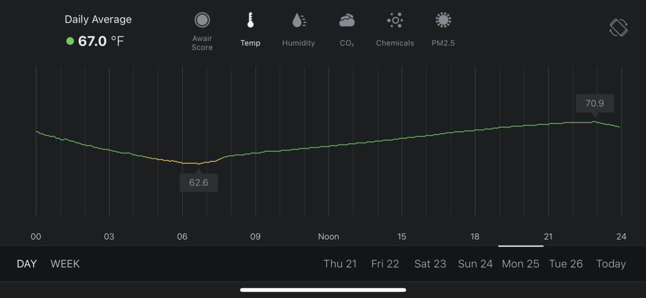

    With our local sustained heat wave of temps in the low-mid 90s for nearly a week straight in an area where homes don’t have AC, I’m really appreciating the kitchen swap to LED. The 10 50w halogen bulbs put off some serious heat that is now a non-issue for the LEDs.
    Not light related specifically, but I also like the data provided by my Awair air quality monitor, where I can plot things over time to better understand the dynamics in the house and how to most effectively manage them.
    Awair Element Indoor Air Quality Monitor, White/Grey Trim https://www.amazon.com/dp/B09NF6JCBM
