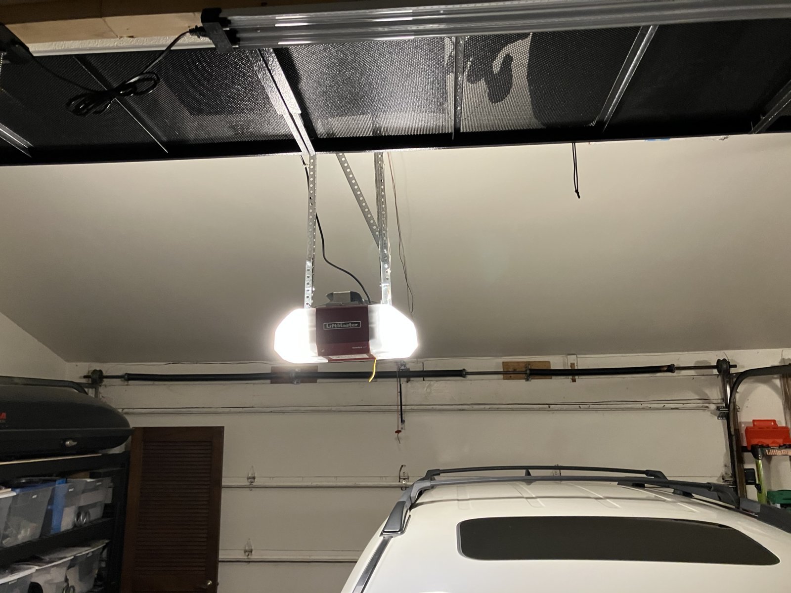

    Looks like a good find, I’d favor them over 4000-5000k alternatives of other brands. Opener lights are really more about output than quality, and the ability to mitigate interference.

    Happy enough with these.

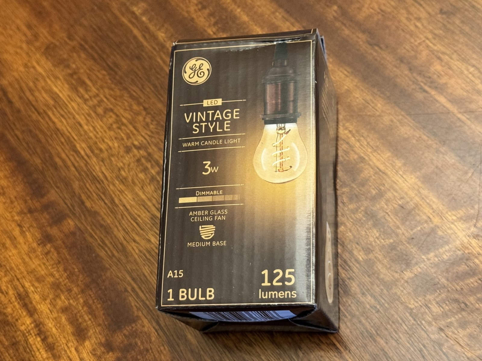

    My kid has started reading or writing/drawing after he goes "to bed". The 40w equivalent GE relax bulb in his table lamp was too bright for the late night task. I instead swapped it with a lower output GE Vintage style LED bulb. Rather than 450 lumens with the 40w Relax bulb, I told it down to 125 lumens and a much warmer color temp more ideal for circadian rhythm. I initially I went with a 350 lumen GE vintage bulb, but still felt it was too bright.

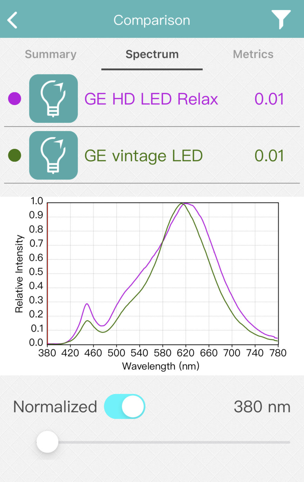

    I'm a big fan of these for late night use with the warm color temp. I added these to my office as well with 60w equivalent bulbs for use at night. Light quality certainly take a hit, but for the use cases where I'd utilize these vintage style bulbs I'm not concerned. Color temp is about 2250k vs the Relax 2700k, and CRI drops to 82.
    The spectrum profile some interestingly somewhat similar.

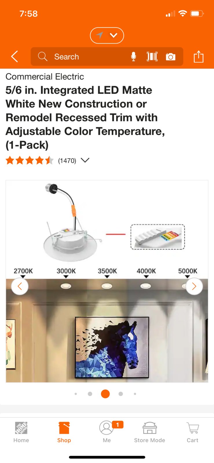

    Almost finished remodeling the house, had some LED can lights installed in the dining room - they set them to 3000k.
    The kitchen and family room cans are set to 2700k
    I was very surprised to immediately see a notable difference of only 300k!

    In interior lighting it is pretty noticeable. Why 3000k in the dinning room but not in the kitchen?

    No idea why the electrician set them to 3000k.
    Easy fix though, pull the lights down, flip the selectors to 2700k and push them back into ceiling. Thankfully there were only 4 lights :rofl:

    Not sure if this is the exact brand/model but this is the same selector switch .IMG_8258.png

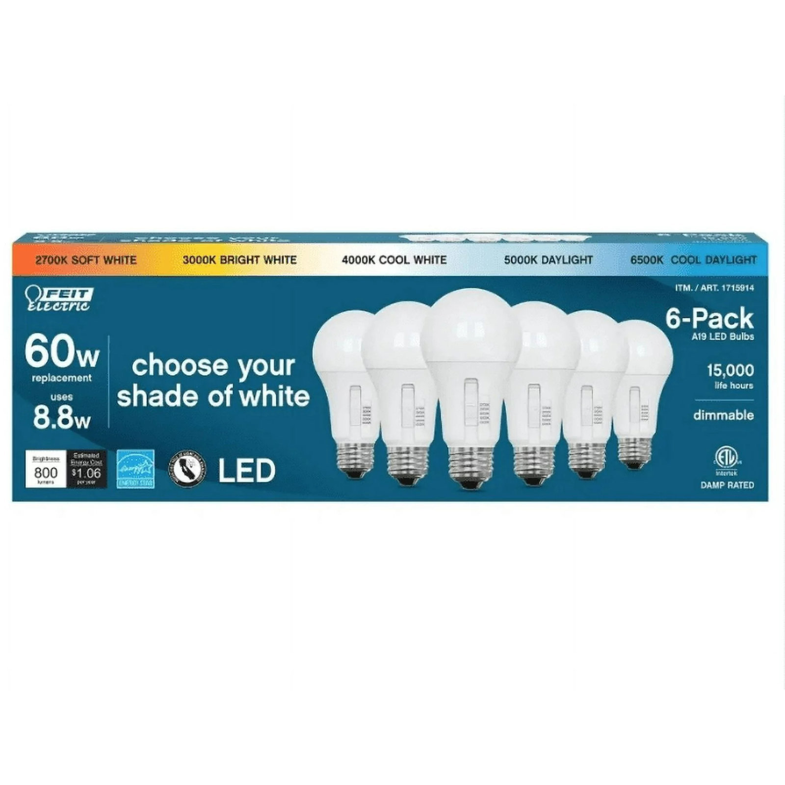

    Costco has some Feit Electric bulbs that are selectable. A19's and a few other styles. I bought several boxes of the 60w A19's and set them all at 2700k. They're brighter than I expected.

    I’d favor buying the desired color temp and getting an HD light vs lower CRI with the ability to color change, as it seems unlikely you’ll switch it once installed.
