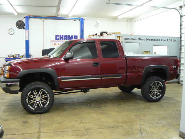

    I HAVE LIFTED A TON OF TRUCKS THIS WAS THE FIRST QUESTION I ASKED WHEN I BOUGHT MY TACOMA , I HAVE 2 SILVERADOS LIFTED 6 AND SEVEN INCHES, AND JUST SOLD MY CHEROKEE THAT WAS LIFTED 9 INCHES ( big mistake ) BECAUSE I FEEL JEEPS BAR FAR ARE THE MOST VERSITLE OFFROAD VEHICLES. MY FIRST INTENTION WAS TO GO 6 INCHES BUT SQUIRMED WHEN I FOUND OUT I WOULD HAVE TO CUT OUT THE MAIN FRAME CROSSMEMBER, I OPTED FOR ICONS FRONT AND REAR AND AM WORKING MY WAY INTO HACKING THE TRUCK UP. MY TRUCK IS AT 3.5 INCHES FT. , 3 BACK AND TO TELL YOU THE TRUTH VISIBLY NOT MUCH DIFFERENCE FROM 6 INCH. I REALIZE LACKING A V-8 OR TORQUE MONSTER 4.0 REGEARING WOULD BE NECESSARY WITH THE TACOMA. PLUS MOST PEOPLE DONT WANT TO SHELL OUT 1500 - 2000 GRAND LET ALONE THE FULL DAYS WORK TO PUT IT ON PLUS I LIKE THE RIDE AND EASE OF ENTRY AND EXIT ON MY TACOMA AT ITS HEIGHT. FEEL FREE TO CK IT OUT,
