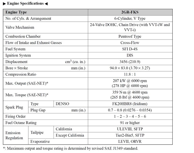

    My experience while working in R&D at a large OEM engine manufacturer, common practice to test new engine designs was to run the engine on the eddy current engine dyno at peak torque for 40hrs continuous. No breaks, no stopping. If peak torque was measured at 4600 rpm, then the test would be ran at 4600 rpm for 40 Hrs. Same if the peak torque was measured at 7400 rpm, test would be conducted at 7400 rpm. Immediately following, the engine would be disassembled and inspected/measured and NO part could be out of design tolerance or the test would be a failure.
    Toyota is very thorough in their testing and design parameters. Their choice for this engine to be used in the Tacoma I'm sure wasn't taken lightly. The design of the 3.5 engine is such that 4600 rpm is not considered high rpm (heavily oversquare design of 94.0mm Bore x 83.0mm Stroke) with a piston speed of 2505 FPM @ 4600rpm (peak torque), the 4.0 engine was a very slightly undersquare design of 94mm Bore and 95mm Stroke, and had a piston speed of 2493 FPM @ 4000 rpm (peak torque). So with this comparison it is easy to see that both engines run at nearly the same speed (piston wise) at their point of peak power.
    On the other hand, one interesting thing to note, one of the main killers of an engine is detonation. And even with the relatively high 11.8:1 compression ratio, the engine is likely designed to tolerate 87 octane fuel, by trimming back ign. and cam timings when knocking is detected, high load duties (such as towing and hauling) would surely benefit from quality higher octane fuel (91) as the engine would be able to deliver power to its full potential without having to limit timings due to knocking.
    Edit: After reviewing the white paper specs of the 2GR-FKS engine, I see that the MIN recommended fuel octane rating is 91 or higher.
