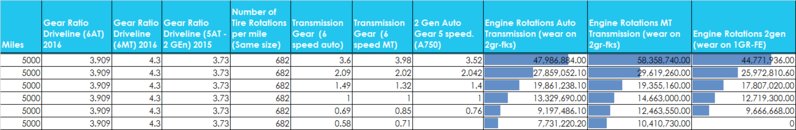

    I moded 1999 Taco so much it had turned to Land Cruiser
    Its a gear <> Engine rotation calculator :notsure:
    I think it answers your question pretty well.

    This is assuming that less rotations always equals a longer-lasting engine. But wouldn't that mean high-revving Hondas should crap out at a younger age? That doesn't seem to be the case.

    Sorry You are asking philosophical question in response to mathematical calculation. I wanted to provide numerical value for your question.
    Honda engine vs Toyota engine is philosophical dilemma that is fro you to decide.

    I think he is really just surprised that you posted an accurate, detailed and logical post... Starting to think you do have a brain but just enjoy trolling...

    Pretty interesting chart.
