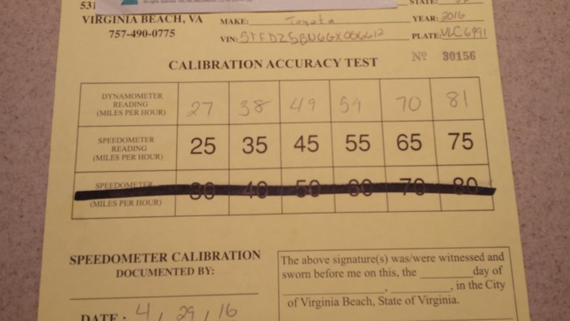

    Depending on weight and width of your new tire and wheel package, plus the height you're probably lucky to see 5th at +70 and without a speedometer re-calibration, probably tracking closer to 80 at that speed. You're probably never in 6th anymore especially if you use cruise a lot.
    2 years ago I upsized +1 my stock OR tires to 265/70/17 then shortly after got a speeding ticket. I had the speedometer checked when I went to court and below are the results.
    Dyno operator told me he usually sees a +/- 5% error for all factory calibration values on stock tire diameter so the +1 upsize and +5% error from perfect calibration gives me the value recorded.
    https://www.tacomaworld.com/threads/cold-feet-about-larger-tires.442229/page-5#post-12874487
    First get an idea how fast you're really going then correct as needed. FYI when I'm certain I'm in 6th gear at 70mph I'm usually running about 1800 rpms.
