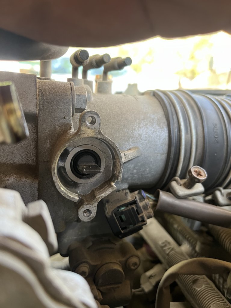

    I do well maintenance intake maf got some sand but it’s not much, filter is also in well condition could be changed right about now tho, I haven’t open up the throttle just yet. Will post pics when opened up, any ideas so far?

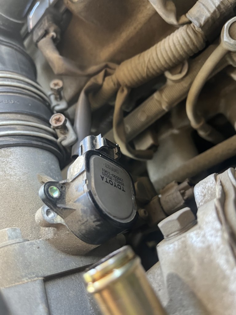

    Took the throttle body position sensor out and it’s looks way back compared to the actual sensor

    Is it supposed to be like this? Or am I tripping, that pic I post first the black thing won’t move unless it do but i didn’t apply much pressure on it
    Edit: so found out it do move when the throttle is turned so does that mean the throttle sensor went bad?
