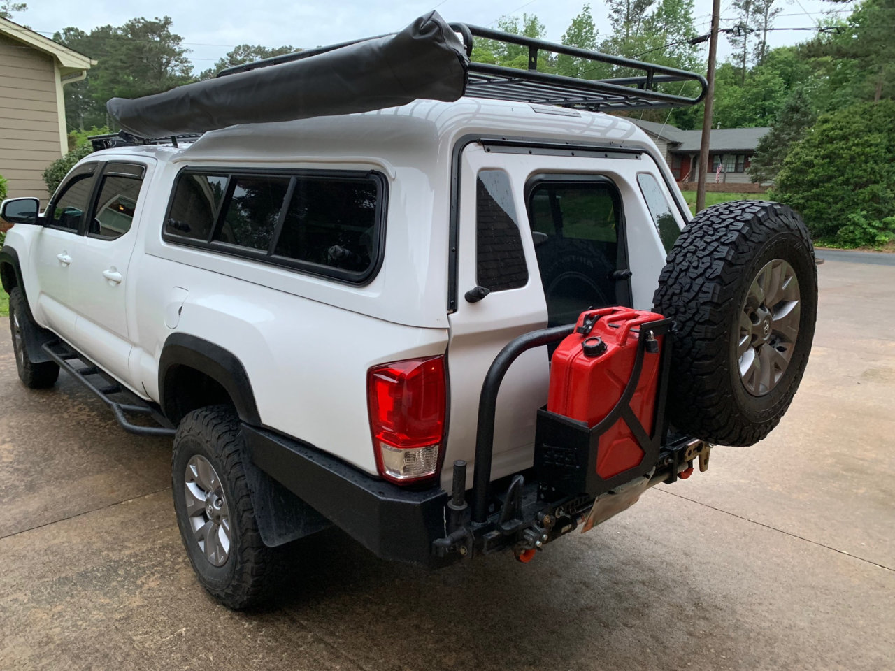

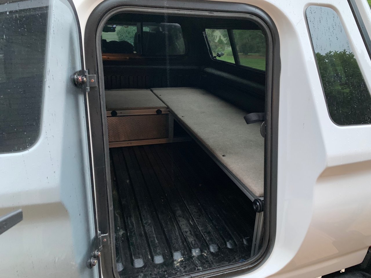

    My top's a hightop and I built a platform inside it for similar purposes. It's an ARE MX with the walk-in option:
    I like this config because there's no setup time required... Just unroll the sleeping bag and snooze. I'd never set up camp somewhere I didn't feel safe, so I've never really been worried about access to the truck in the night.
    Camping in a 5' bed would be a challenge. I'm 5'10" and wouldn't be able to make that work. I have a 6' bed and part of why I got the walk-in option on the ARE MX was to add a few inches of length; the longest part of the bed is 6'4" with the walk-in option, and even then it feels just long enough for me. Unless you're short or sleeping diagonal, you may have trouble snoozing in a short bed.

    I love your set up! Yes, I have a 5’ bed but I’m not to worried about being able to stretch out completely. I’m 5’5” tall so it kinda works. My main issue is I can’t be hot or warm while I sleep. I must have an AC unit of some sort. My concern with the generator is they are expensive, loud, and get stolen often. I will be alone most of the time and I’m worried about leaving anything outside.

    Would you ever consider selling?! Thats such a dream setup
