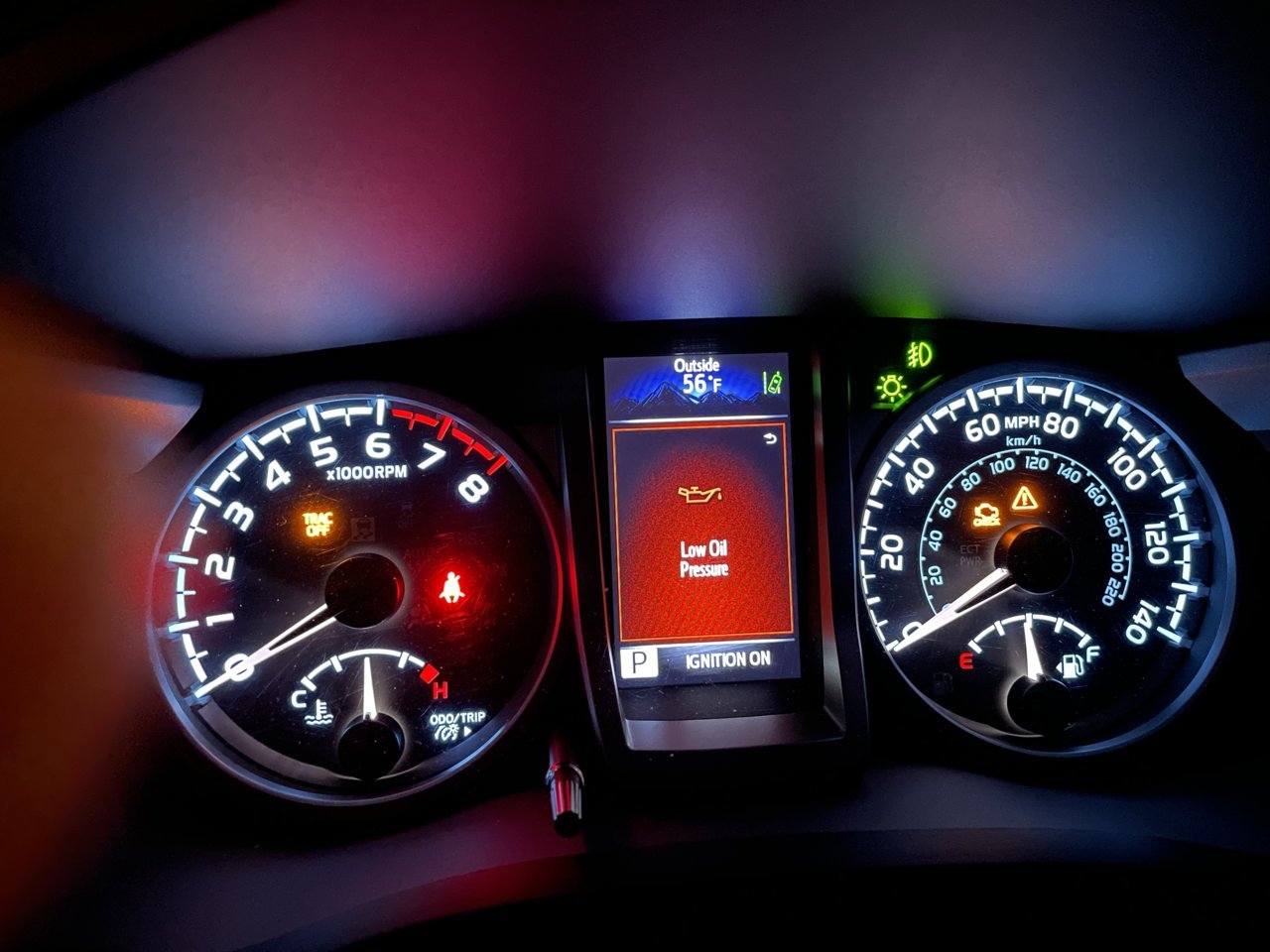

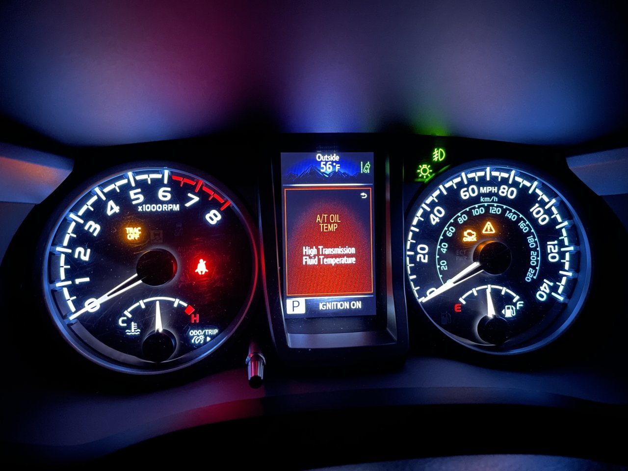

    Hi all, I had the following issue happen last night and experienced the following faults: High Transmission Fluid Temperature, Low Oil Pressure, Check Charging System
    I did see several posts with similar faults, but no conclusive results after "googling.”
    Truck is a 2019 TRD sport w/ premium and technology package, 19,000 miles, No electrical or mechanical mods. Fuel Pump recall completed about 12 months ago. Truck has been trouble-free since new.
    Some background: Drove 20 miles in moderate rain, parked outside for about 1 hour and after normal start and driving less than 1 mile at 25 MPH, truck lost power, shuttered and stalled. Received a TRAC OFF and Check Engine Faults. I shutdown, waited a few minutes and restarted. Idle was rough and had low acceleration before second stall. The following faults were displayed: High Transmission Fluid Temperature, Low Oil Pressure, Check Charging System.
    Tried two additional attempts and managed to position the truck into a safe parking space, and left it for the night.
    I am returning this morning to try and see if it will start and drive safely to local Toyota dealer, otherwise will have it flat bedded to dealer.
    Any thoughts? Thank you in advance.

    That looks like all the warnings people with a bad crankshaft position sensor would get.
    1. Check Engine Light
    2. Trac Off Light
    3. Check Charging System
    4. Low Oil Pressure
    5. High Transmission Fluid Temp.
    6. Yellow Master Warning Light

    You really need to pull codes...
    The same warnings will come on with a failed ECU; you'll have a bunch of injector codes. There was one lady on this forum who had hers replaced twice IIRC, before it was remidied.
    cryptolime likes this.
  14. Dec 12, 2021 at 6:47 AM
    splitbolt
    splitbolt Voodoo Witch Doctor
    Mar 7, 2010
    #32761
    7,858
    NW Arkansas
    2016 TRD OFFROAD DCSB MGM
    Also, IIRC, the crankshaft position sensor(CKP) doesn't throw a code...you have to measure it's waveform.
