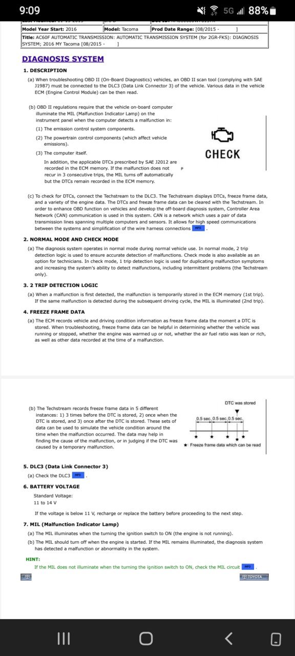

    You sure it would generate a DTC?
    As I understand it, to generate a transmission DTC, normal mode(regular vehicle operation) detection uses a 2-trip logic; check mode(requiring Techstream) uses a 1-trip detection logic.
