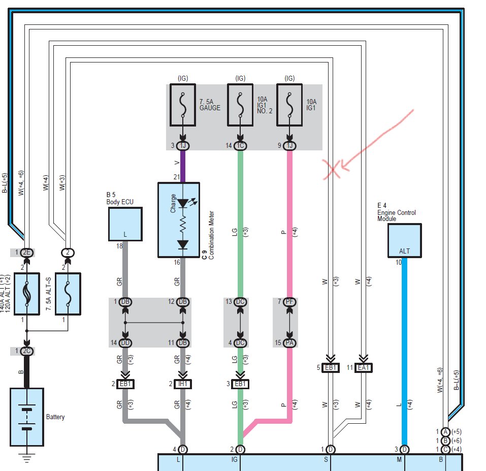

    Problem Solved!! So it turned out to be the white wire from the alternator connector back to the fuse box connector was corroded. I monitored the voltage while I sprayed water on the wire harnesses and within a couple minutes my voltage started varying between 13 - 18V. I checked the resistance of the three wires leaving the alternator and the white wire was over 10Kohms and constantly changing. I took apart the wire harness and found the white wire cracked and green with corrosion, replace the wire and everything is good again!

    Good find. I would bet that's the Alt-S circuit wire for voltage regulation

    That's correct, it's the 'S' wire shown below. Not sure how this could even happen as it's protected in wire loom.
