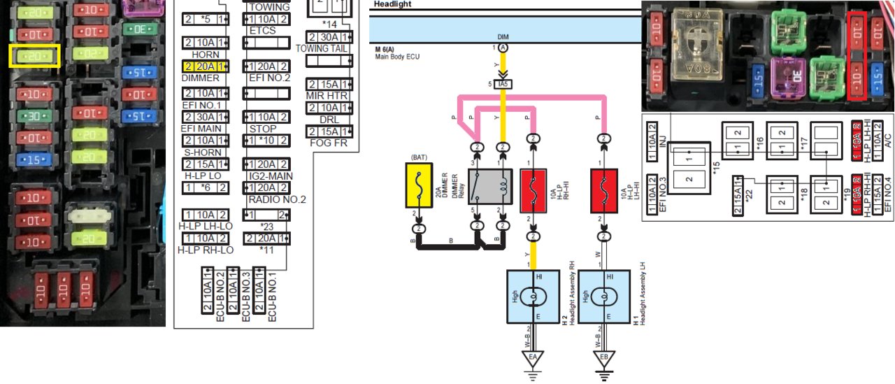

    My highbeams are out and the high beam cable connector is barely getting a read from voltmeter. (.02). Low beams, DRL are working. I checked the fuses under the hood. Can't find a high beam fuse. Any troubleshooting tips are greatly appreciated.

    It’s in this file. Good hunting!

    Did you check the high beam relay? There should be a high beam fuse as well (at least there is in 2nd Gen). Look at the underside of your fuse box cover for the fuse mappings.

    Caribe beat me to it.
    And as always, did an excellent job:thumbsup:
    20A Dimmer fuse to the Dimmer Relay
    Dimmer relay to 10A H-LP/RH-HI and 10A H-LP/LH-HI fuses
    Dimmer relay is controlled by the Body ECU
