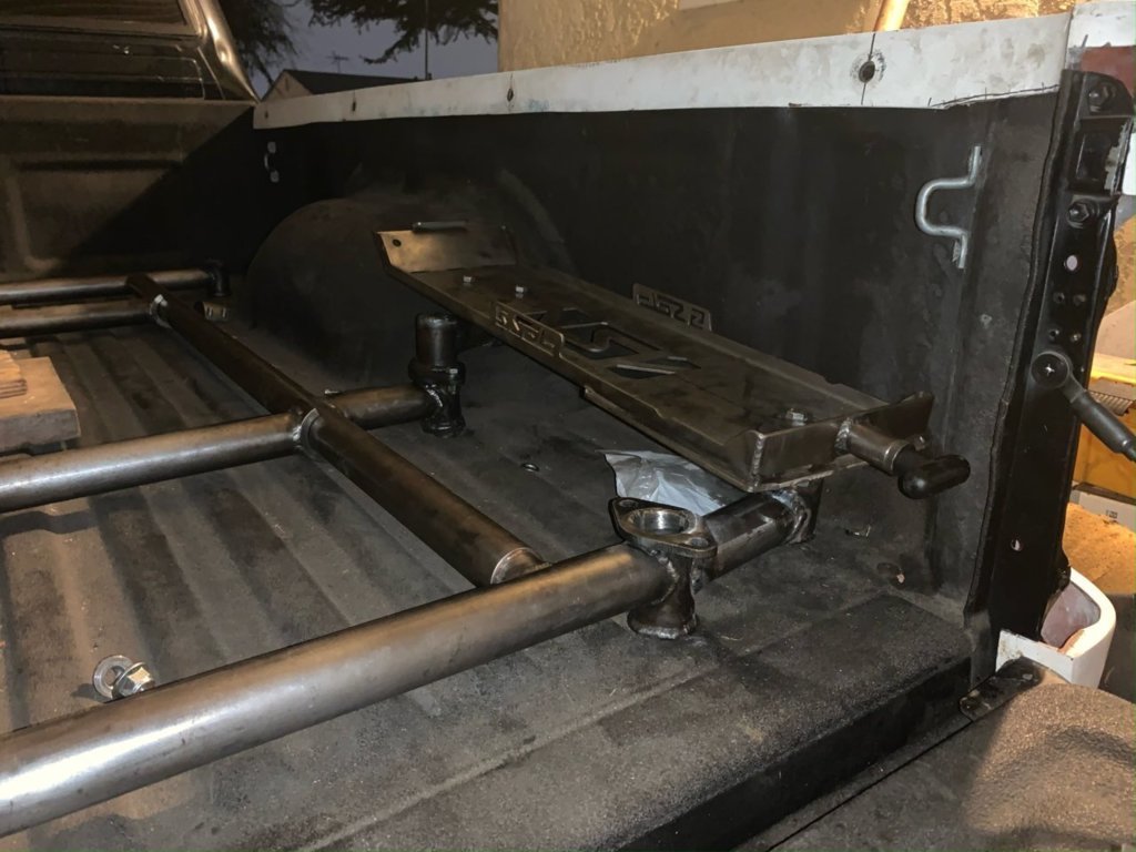

    After seeing this the HL jack didn't look as fun to use... I'll get one eventually, but I'm the meantime I got this:
    https://www.solomotorsports.com/shop/parts/general-parts/harbor-freight-jack-mount-skid-plate/
    An extension for a floor jack will get most people off of the ground off-road. There are of course a couple instances where it wouldn't work. I bring jack stands with me out in the desert with some plywood like @Crom uses for the HL jack.

    If I weren't making a bed cage, I'd probably riv nut some threaded inserts into the channels in the bottom of the bed and drill some holes in the bottom of the holder to make it completely removable with some bolts to thread into the riv nuts. It'll be welded onto my bedcage though.
