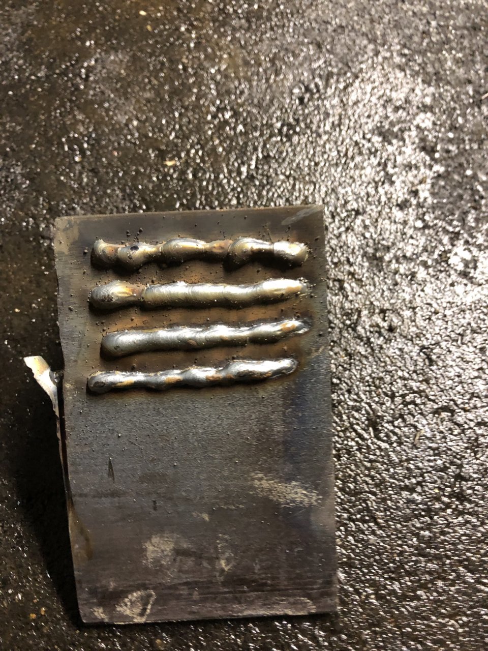

    Nice. Like someone previously mentioned, you'll be a lot happier with shielding gas.

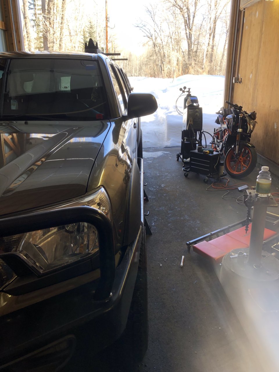

    And the shielded gas welds, they look and feel soo much better. The top I had a slow wire feed setting but once I boosted it up the weld puddles came out much smoother. I haven't hit them with a wire wheel yet nor did I prep the surface.

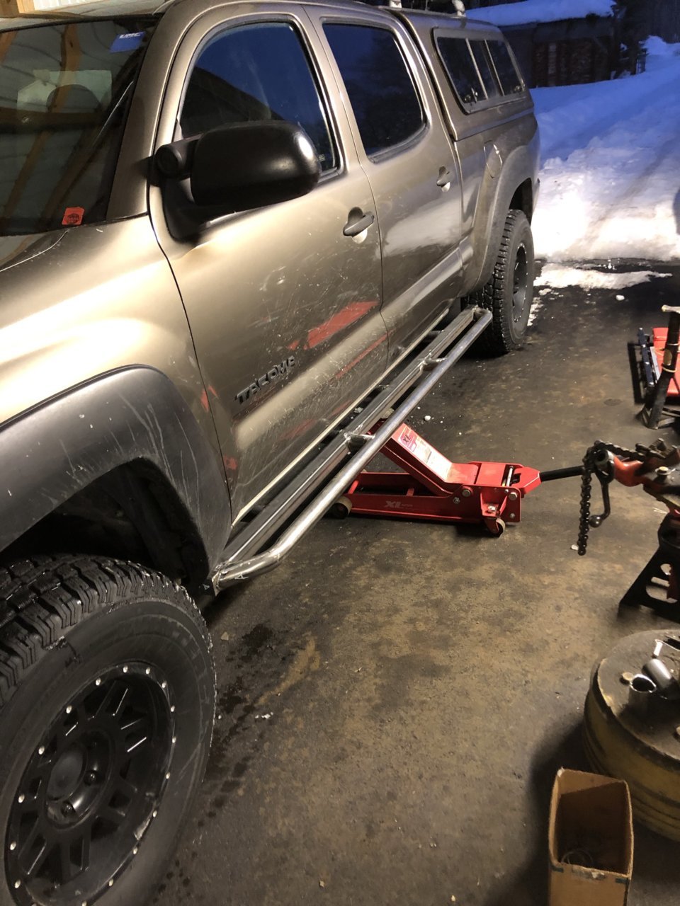

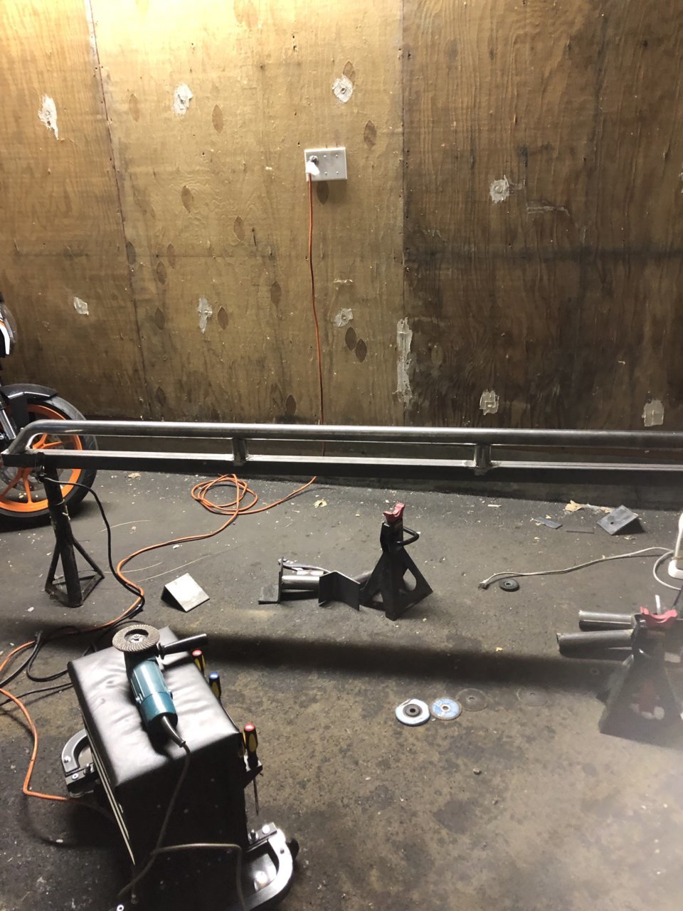

    ETqv9DbkQ9ibtNJw9%jU6Q.jpg uie401UOQ%CijSAv2wo0+g.jpg WlIhXmpmQ0qV1lOWAzOo5A.jpg
    Got the drivers side finished, now that I have a system for how it should go together it will go much faster for the passenger side.

    I would add another tube between the round and square tubing on both front and back. It looks like there's a huge area where if you hit a rock the outside round tube doesn't have much support.

    I think they look great. I agree with @svdude about adding a couple more round intermediate tubes to help with the strength at the ends of the sliders. One other recommendation would be to add some gussets at the feet to the legs in order to limit any upward deflection of the sliders when taking a big hit

    The holes for the brackets are directly above the legs so I don't have the space for a gusset but I don't plan on reusing them if I do take a big hit. I just wanted some rock sliders for the truck and needed something to do for my senior project. If/when they get bent or hit I will definitely redesign to add more supports and gussets. I would like to have added a fender rail like they do in Australia and a rear kick.
