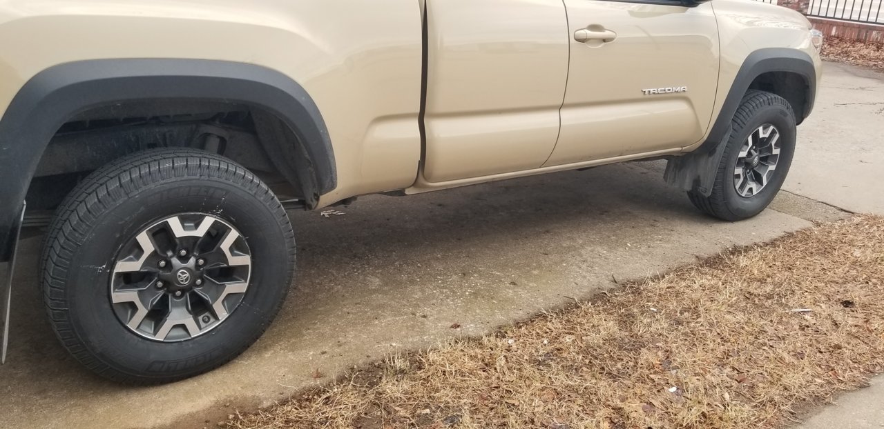

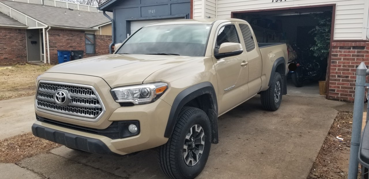

    With very few miles so far, I'm impressed, but I should be.... going from 50k miles on wranglers to brand new Michelins. I have no doubt these will be fine for my purposes. Will probably handle construction site mud just fine.
    For any curious what 265/70r16 Michelin LTX M/S look like on a bone stock 2017 OR suspension......20201230_170624.jpg 20201230_161322.jpg 20201230_161344.jpg
