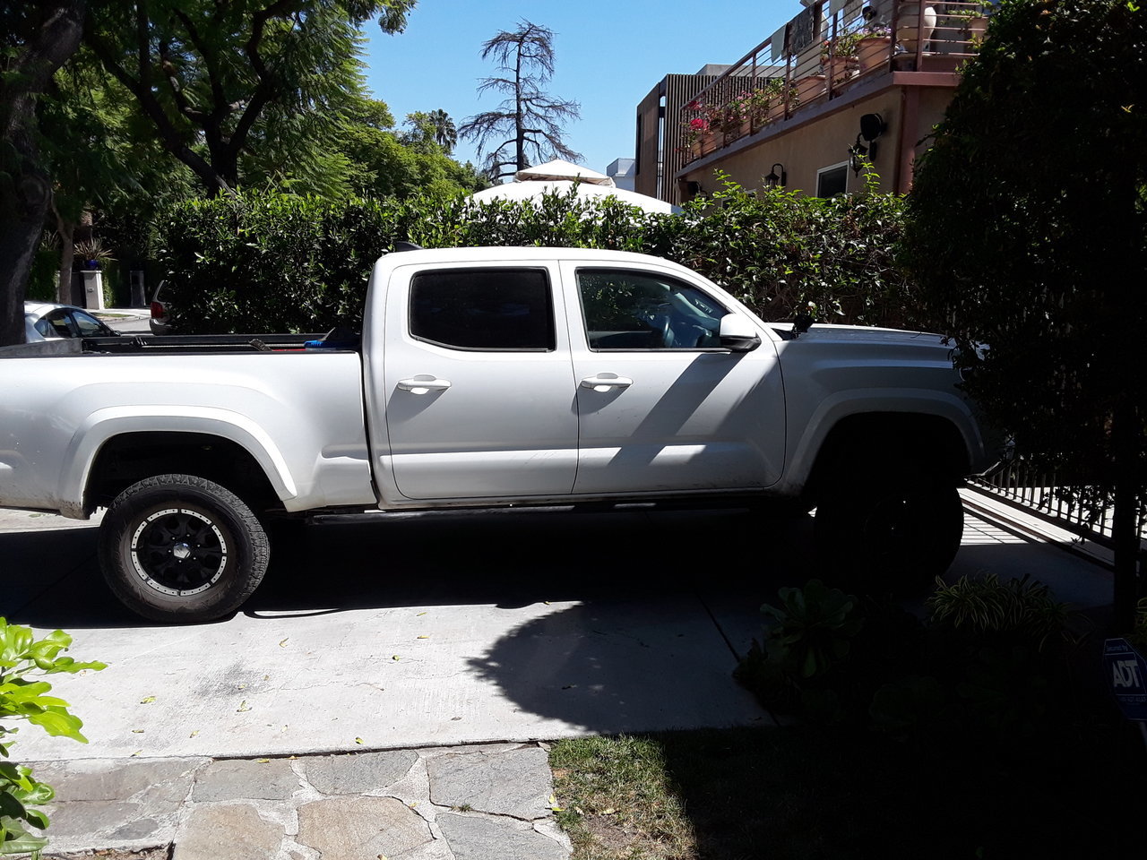

    This one is mine. I am around 4.5 I. The front and 4 in the rear. Had drive line issue before I lifted the rear end to almost level. I have the stock or wrangler with Kevlar. I put the spacer in and it helped, but didn't eliminate.
