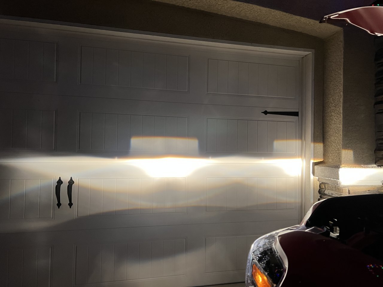

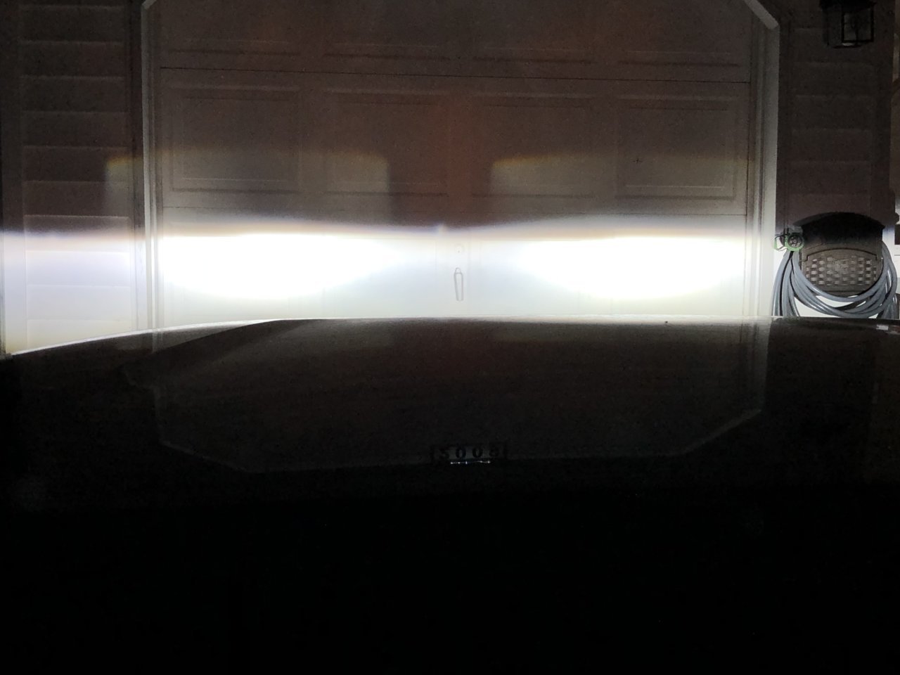

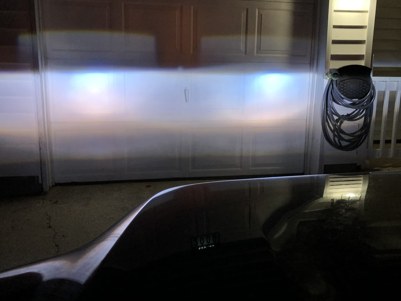

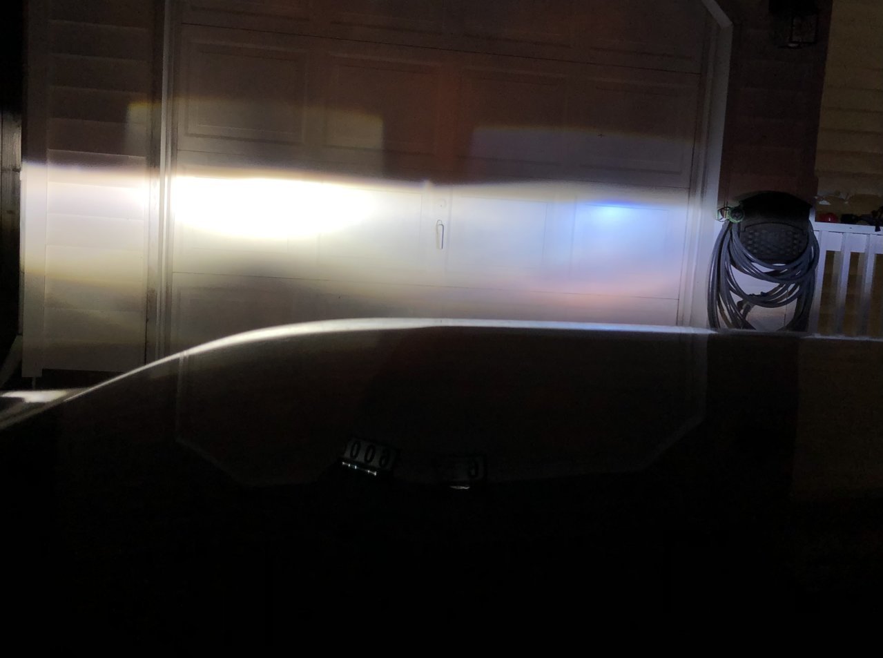

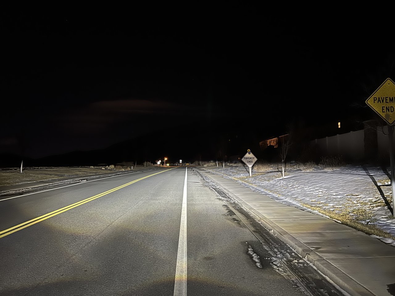

    I know there are a lot of LED bulb threads with reviews on Hikari H11 low beam bulbs in there (I've done the search... hence why I bought the Hikari's) but no dedicated ones with pics.
    Vehicle: 2022 Tacoma TRD Off-road with DRLs and not the full LED package (obviously)... I would have added it in but I had no real options b/c of vehicle allocations.
    1st pic (stock halogen bulbs)
    2nd pic (left Hikari, right stock halogen)
    3rd pic (stock halogen bulbs both headlights) taken on same road as below but obviously different background lighting conditions with sunset
    4th pic Hikari's
    I know not all the housings are the same...and yes I did read that pessimistic thread with all the temperature measurements and light dispersal with LED bulbs. But seeing is believing....and if you can't see the difference well then move on.
    For what it's worth, the Hikari bulbs I originally got one of them was defective...and did not turn on hence the initial pics up close with only ONE Hikari Led and one halogen. I ordered another one and returned that package.
    Hope this helps others decide "

    The third and fourth pictures show how much better the stock halogens are at illuminating distance.

    Not a great test when the grounds covered in a highly reflective cover. The difference in color temperature all else being equal would skew the visual results. The hikari ultra earned its spot at the go-to recommendation for an LED retrofit type bulb because it works well enough, but that is not the end-all be-all of bulb recommendations. It outperforms the long-life H11 that comes stock, but it causes an increased intensity level lower in the beam pattern without an equal or greater increase in intensity in the hotspot. This effectively works to decrease your ability to see things at a distance as effectively as a halogen bulb does.
    Did you lock your camera settings for all of your comparison photos? If so, please post what they were for each set of pics. Unlocked/auto-adjusting camera settings don't provide any ability to make a fair comparison.
