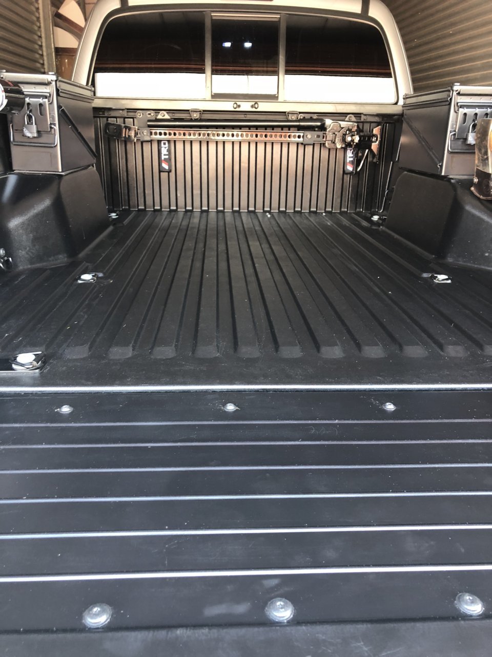

    Pretty much your only option other than mounting one in the bed for the look.

    I’ve got one for ascetics. Also, have a large bottle jack along with the OEM jack, which I’ve never used.

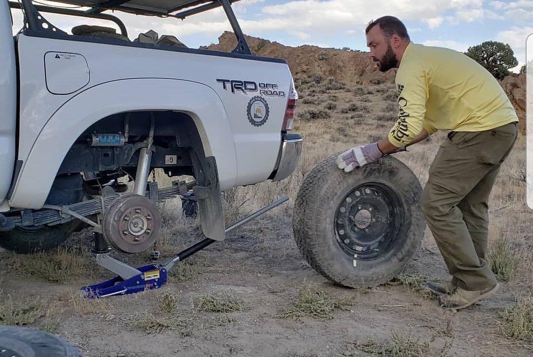

    A floor jack works the best, next up is a bottle jack. In the event of a flat, you don't need to lift your entire truck, just the corner you're working on.
    ex: front flat - lift from lower control arm
    rear flat - lift from rear axle
    If you lift from a bumper, or even the sliders, you have to lift the full range of suspension travel before the tire comes off the ground. Lifting from the LCA or rear axle means you don't need to lift the truck nearly as high which is safer.
    If you can, use wheel chocks to prevent the truck from moving, and use jack stands to prevent the truck from falling.

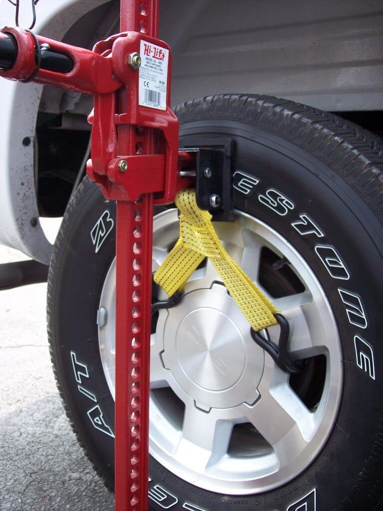

    "Y" strap. They sell a "y" shape lifting strap that fits in spokes on gen 2 stock wheels, has metal hooks on each end of strap. havent tried yet on my 2018. Worked on 2014 SR5
    Works great to get a wheel in air or out of a hole BUTTtttt, for changing a tire you still need to block up the wheel to take off as you can't hold wheel in air and cange it too. ;-)
