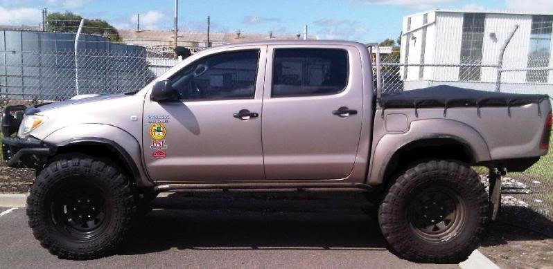

    Had a quiet morning at work so I played a little with MS-Paint and a pic of my hilux.....raised it slightly mroe and made the tyres look bigger....tried to get em looking like a 35" but I think they look closer to 37 in the pic below....hmmm maybe one day.
