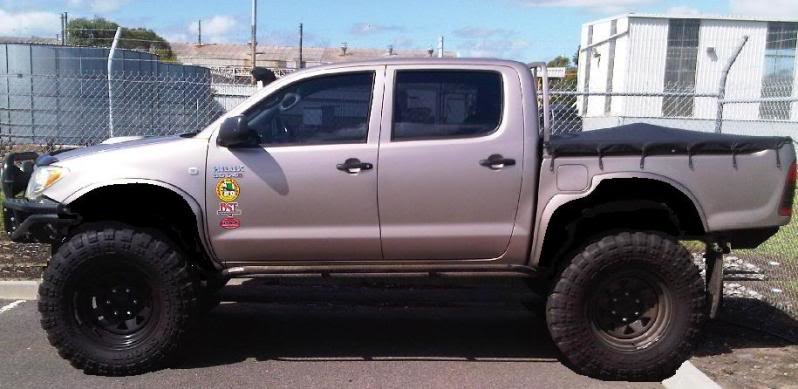

    the tyres are called Silverstone MT117 Sports...size is 285/75x16 - 33x12x16 when new.
    Its a Malaysian tyre.....very very tough mud terrain.
    heres a better pic -

    OK OK.....so I got the angle grinder out on MS-Paint and made some clearance for the tyres to get more suspension travel out of it without rubbing -
    Now to try and do it to the real thing :cool:

    ive played around on paint like that befor but how did u blow up the tires and make them look biger while keeping the rest of the the picture actual size?

    I opened two windows of MS-Paint...one I zoomed in and cut around the tyres then when I copied it over I streched and skewed it by a small percentage and pasted it in. If that makes sense.

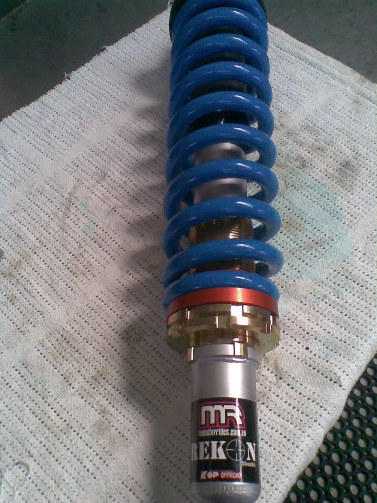

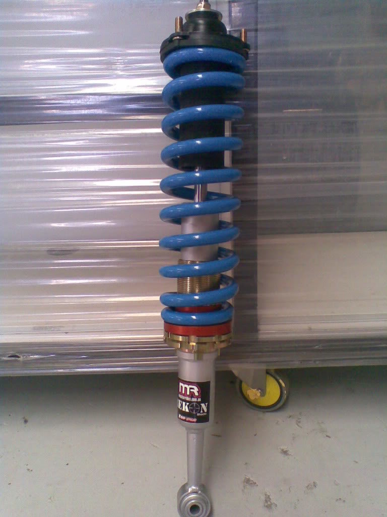

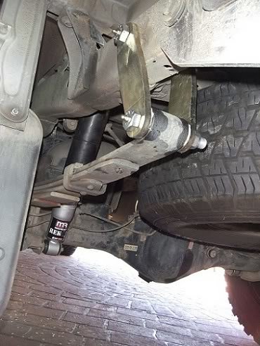

    Finally gonna see some changes made to the hilux this weekend.....
    Monster Rides has finally completed their first batch of adjustable height coilovers for the front -
    They will be set to 4" on the front....with the diff brackets already fitted the cv angle shouldnt be any more than a 2-2.5"
    Getting an extended rear shackle for now to give me an extra 1-1.5" height to suit the front better. At some stage Id like to get a custom length longer top leaf to get some better shackle angle and invert the rear shocks.....I beleive Monster Rides is working on something similar to this and also possibly a 4-link rear conversion kit.

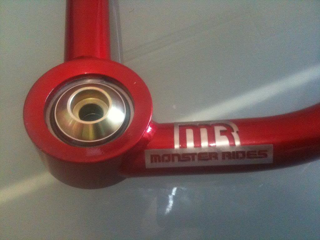

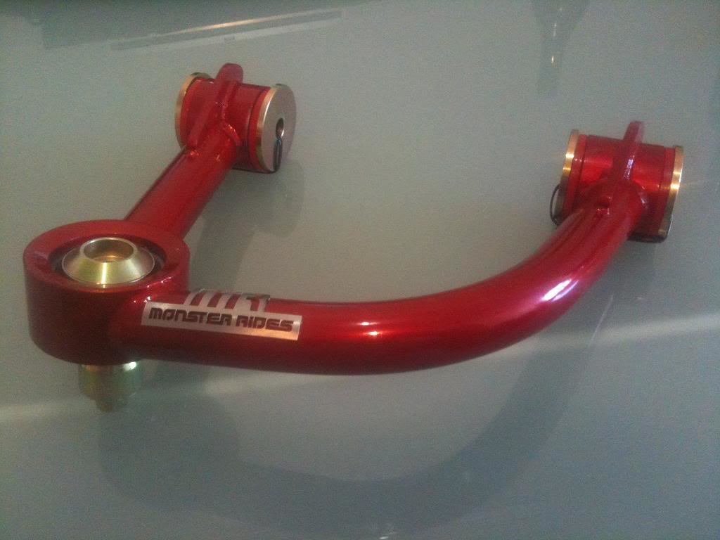

    Uniball Monster Rides Upper Control Arms....these have a shitload of castor adjustment available -

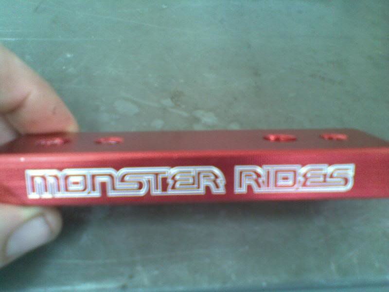

    Swaybar relocators -
    Not sure if Im getting the beefed up swaybar links sent aswell...will see...these bits are getting sent to me mates workshop who will fit them this weekend for me.
    I also have to organise tyres by weeks end.....the hilux will be on display at the Monster Rides Vendor Stall at Tuff Truck Comp the following week.

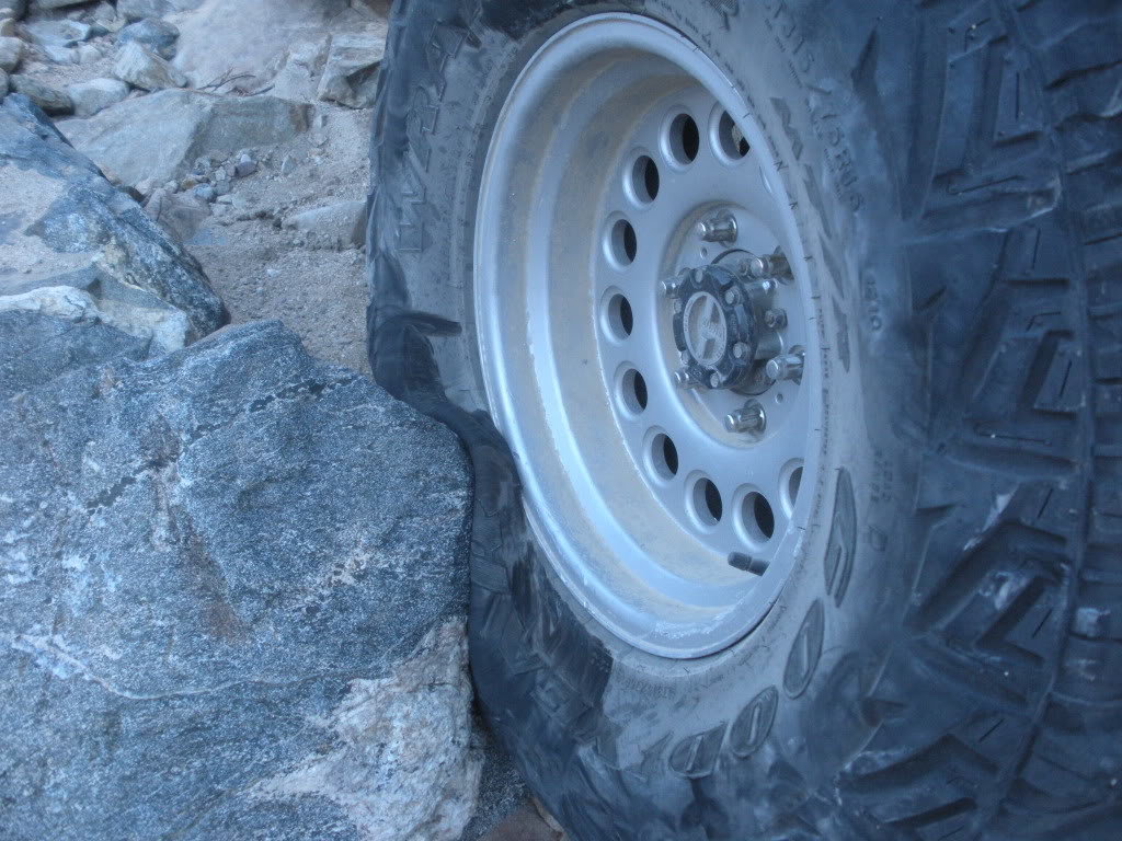

    The Toyo rep hasn't come to the party yet and I couldn't leave this any longer so went ahead with it and got the MTR's.
    Thanks to Scuba on ttora for posting the pic of the MTR Kevlar sidewall flexin (see below - no beadlocks aired down to 12psi) and also want to thank Bovads and his truck for inspiration....I got the below pic as my computer desktop picture at work and the goodyears look damn tuff!
