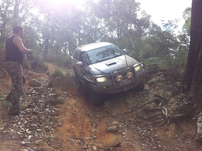

    1st obstacle of the day was a rutted section of track....big wash out to the left that a JK Jeep came unstuck on -
    My lux crawlin up it - http://www.youtube.com/watch?v=bC0k...xt=C3eefd40UDOEgsToPDskL-sTgykoBoFCP0fcy6ZfnN

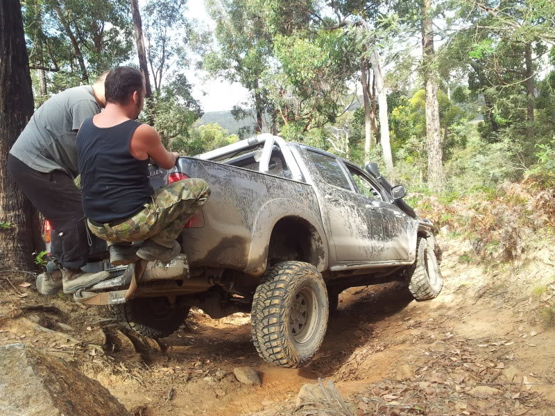

    Heres me towing Rocky in his non locked torsion bar'd Hilux up as he couldnt get traction anywhere not too mention these things dont flex at all -
    http://s61.photobucket.com/albums/h68/mmaaxx1977/Cobaw-Feb12/?action=view&current=IMG_0522.mp4
    Heres me crawling up the same section of track -
    http://s61.photobucket.com/albums/h68/mmaaxx1977/Cobaw-Feb12/?action=view&current=maxrockytrack2.mp4

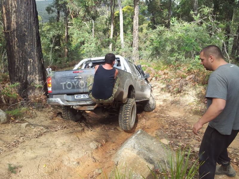

    The very off camber nature of that segment meant you couldnt steer left too hard around the tree as the more left steer you put on the higher the RHR would go.
    So we had to drive straight into the opposite embankment to lower the rhr before we could begin to turn which was another problem as all the weight of the vehicle was on the RHF now making steering difficult.
    George coming down from top view......needless to say I had to jump my fat arse on the rear end to stop it going over.....
    My arse obviously wasnt enough as it kept lifting requiring another fat arsed gentlement to hop on too -

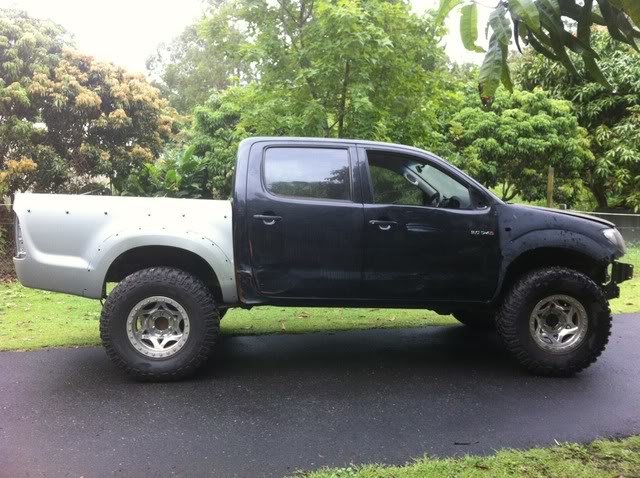

    Heres a couple of pics to show it can be done on Monster Ride's Test Vehicle -
    In pic below hilux is still on standard suspension, front fenders and body mount have been trimmed and tyres (315/75x16 MTZ's on -20 offset 16x8's) almost clear everywhere on full compression and steering lock-
    Pics of Fender trimming -

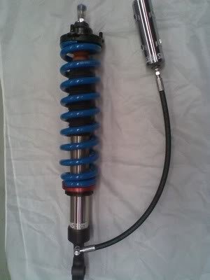

    5) New 2 way adjustable front coilover will be going in for me to trial out in not too distant future.
    Thats about it for now...will update further as I get stuck into the next round of mod's.

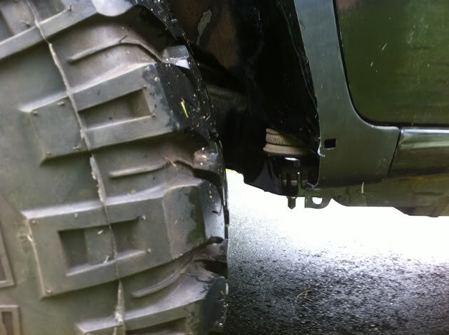

    I have fitted 17x8 Alloy wheels from a GU Nissan Patrol (+10 offset) and 35/12.5x17 Maxxis Bighorns. Also removed the bed and fitted a custom steel flatbed. Rear bed fenders are removable aswell.
    I out the spare on the back for a little more weight at the back.
    Between the top of the tyre and the underside of the tray frame i can "just" fit my fingers. At the same point the progressive rear bumpstops are starting to work and the rear leaves are starting to invert.
