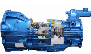

    The time has come to see what is required to swap a Hilux RC60F into a Tacoma, which uses the RC62F. The reason for the swap, as many know, is to improve the gear ratios... and while reverse certainly tops the list, the ultra low 1st gear, better second gear ratio, and deeper .64 6th gear OD will certainly be beneficial... especially with 4.88 or 5.29 axle ratio gears.
    Now, with that said, I always try to plan for the worst, but hope for the best. So, I expect there will be a difference in input shaft length when compared to the RC62F. It will be longer, or shorter, and it will be dealt with. The transfer case appears to be a bolt up, at this point.

    Order has been placed. When the unit arrives, we'll start the process. As usual, comments and criticisms welcomed.

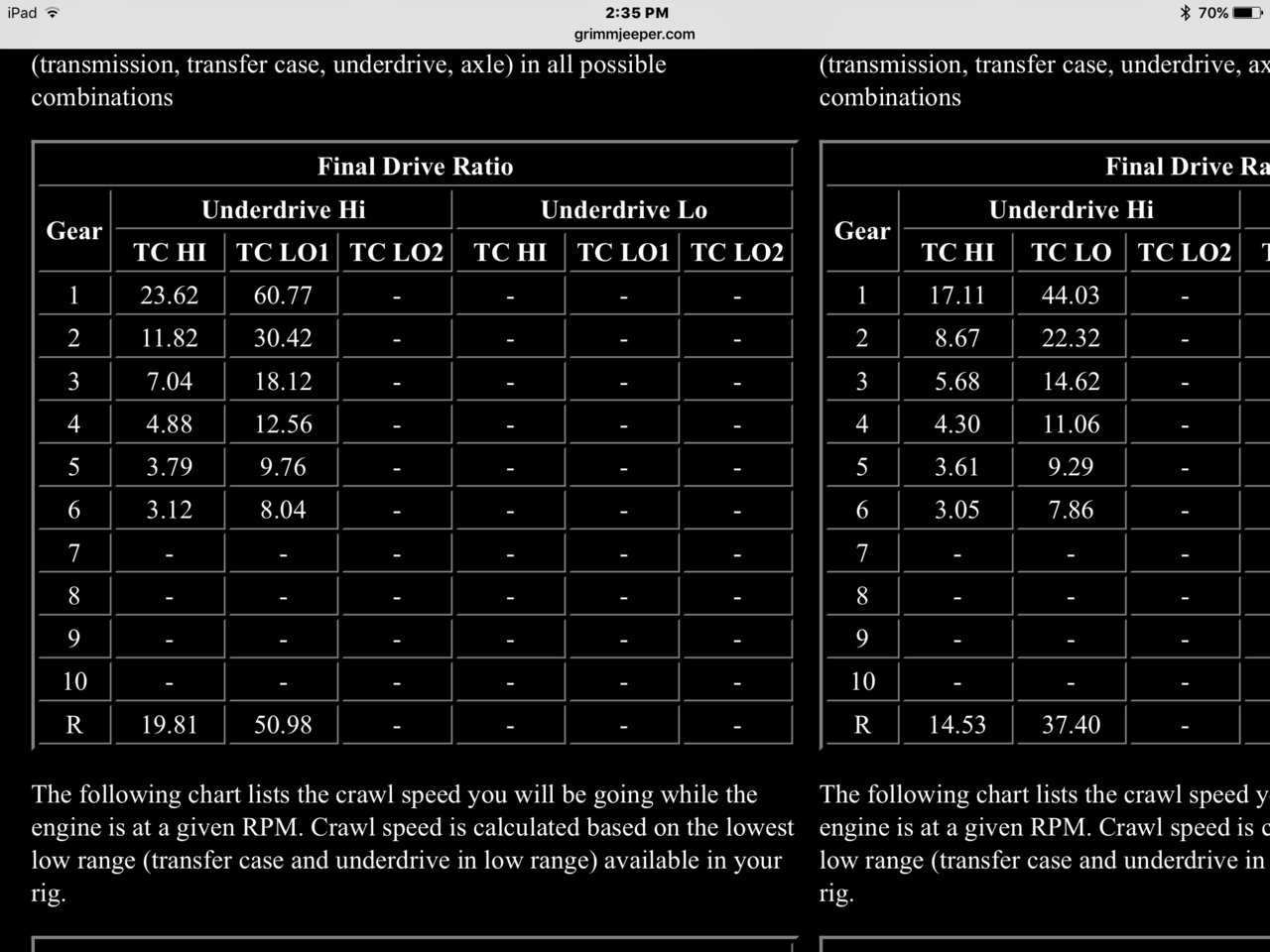

    Here is the ratio comparison for my truck. RC60F with 4.88 and 285/75r17 (33.4") vs RC62F with 4.30 and 31.5" tires.

    tony
    Lynnwood, WA
    Holy Variables, Batman.
    Either way, the ratios on true 33s look great compared to stock.
