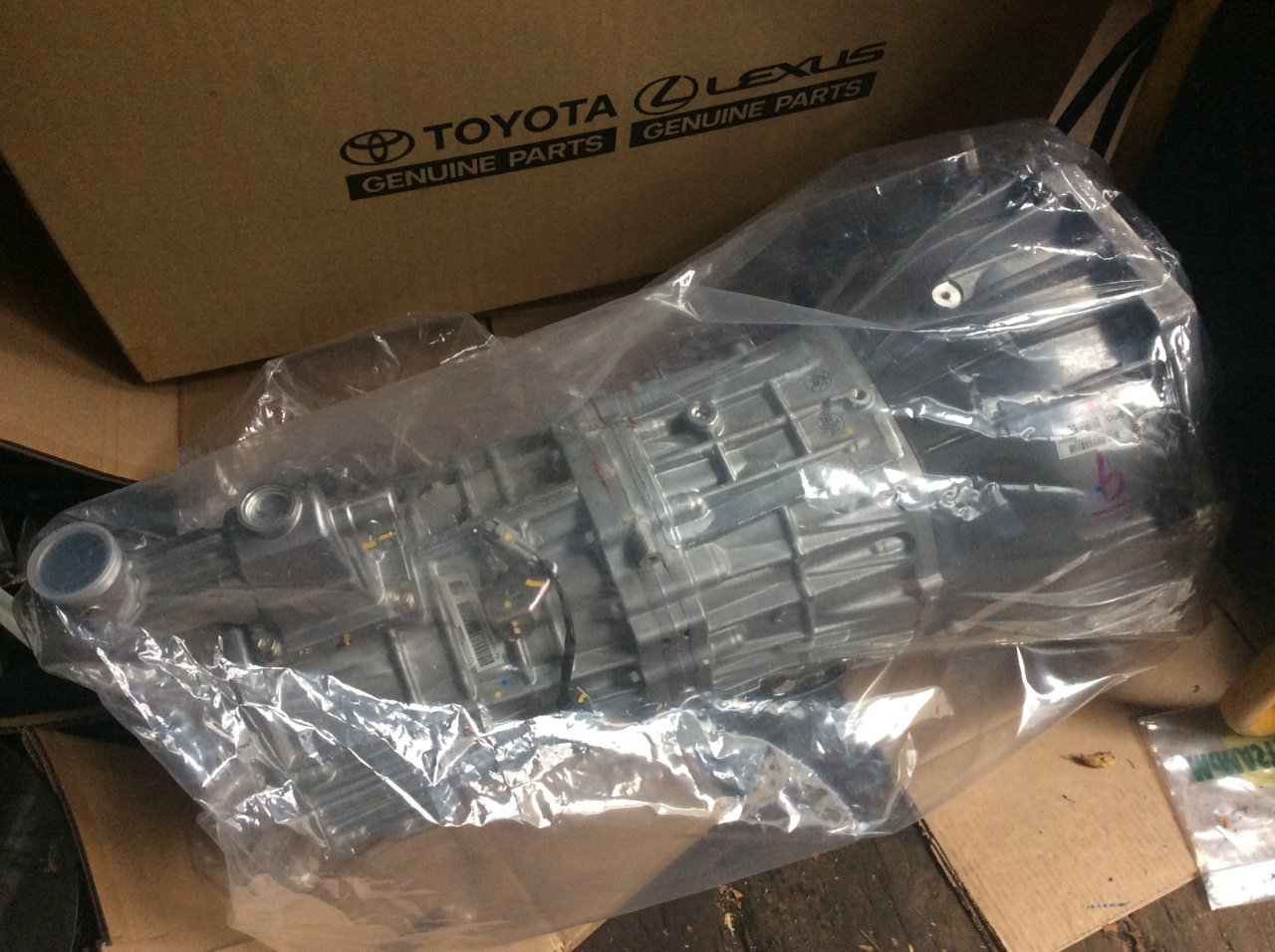

  9. Oct 1, 2019 at 6:34 AM
    #49
    Jowett
    Jowett [OP] Well-Known Member
    May 5, 2016
    #186182
    1,616
    Brian
    North Adams, MA
    Unpacked, inspected, OK'd. The shift extension is interesting, it moves the pivot point rearward 4.5", and up about 2". I won't be using it as it won't allow room for the manual transfer case shifter.
  10. Oct 1, 2019 at 6:56 AM
    #50
    ian rogers
    ian rogers Well-Known Member
    Nov 28, 2018
    #274183
    215
    Ian
    Sf Bay Area
    69 fj40, 2019 OR manual
    Locked Sliders Roll cage H41
    Wow — looks great!!
  11. Oct 1, 2019 at 8:27 AM
    #51
    shakerhood
    shakerhood Well-Known Member
    Aug 9, 2015
    #161370
    36,446
    Southern Ohio
    2017 MGM DCSB Off Road, 6 Speed MT, P&T
    That is a thing of beauty!

  13. Oct 1, 2019 at 3:17 PM
    #53
    Jowett
    May 5, 2016
    #186182
    1,616
    Brian
    North Adams, MA
    The bellhousing is a bit shorter on the RC60F, 188 mm vs 208 mm on the RC62F. Hopefully the input shaft is the same length. If there's enough time this week, I'll consider dropping the transmission from the Taco and comparing.
