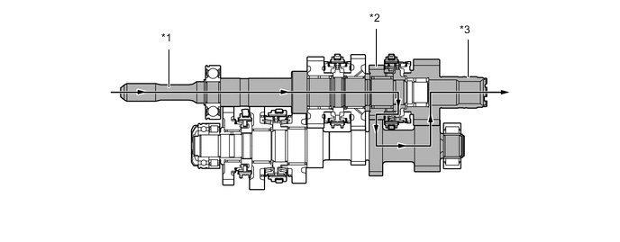

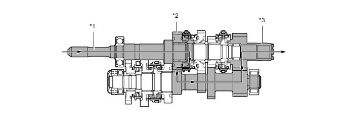

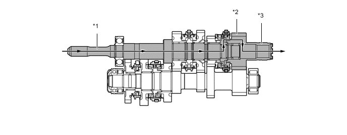

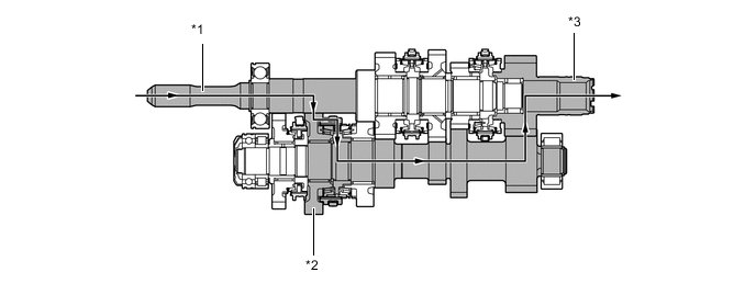

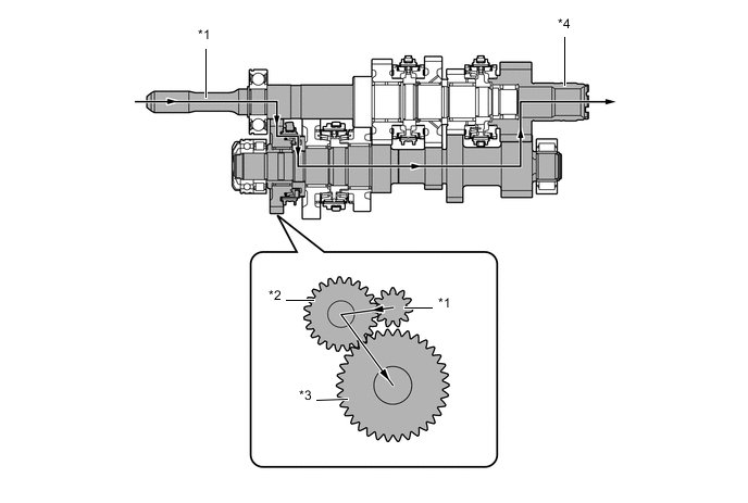

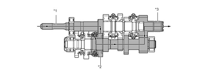

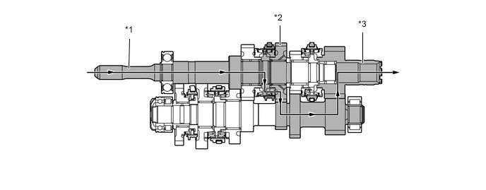

    I am just curious if either of you have a power flow diagram of the RC6x family of transmissions.

  9. Aug 17, 2022 at 3:21 PM
    #149
    Jowett
    Jowett [OP] Well-Known Member
    May 5, 2016
    #186182
    1,616
    Brian
    North Adams, MA
    1st
    2nd
    3rd
    4th
    5th
    6th
    Reverse

    Thank you. That is an interesting use of the counter shaft and output shaft for gear arrangement. Makes sense too, makes it more compact.
