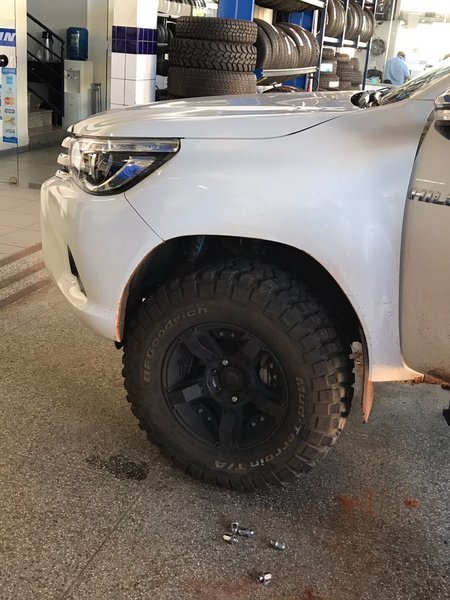

    Testing the kmc wheels rockstar with bfgoodrich mud ko2 285 / 70R17.

    Looks very good!​

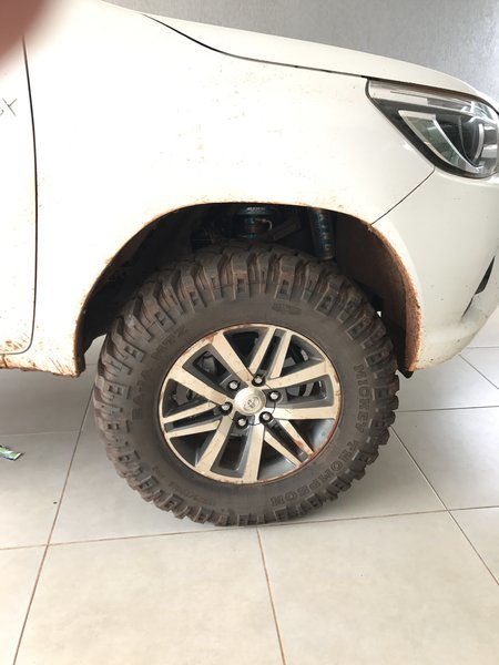

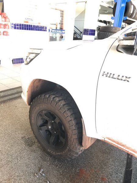

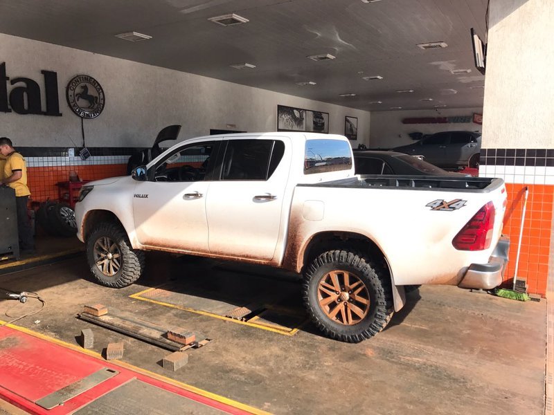

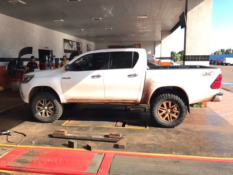

    275/70R18 Mickey Thompson lowers MTZ.

    how much trimming did you do?

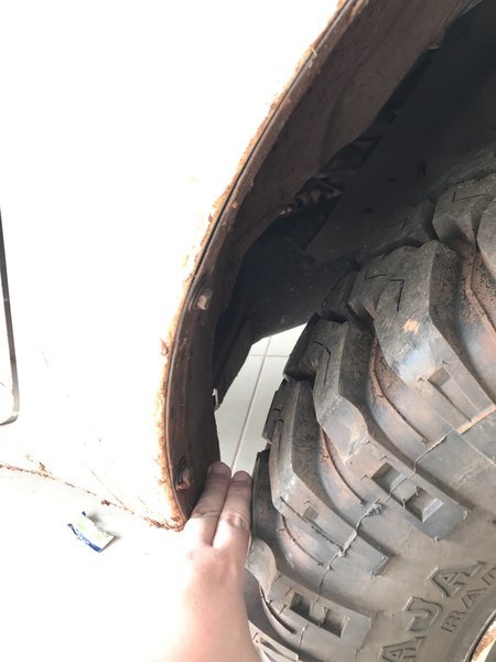

    He did not have to cut anywhere. It came in like a glove. But he will only come in if he changes his upper arms.
    The original arms do not support these tires. You will need a wheel spacer and lift at least 60mm. The joke is too dangerous.

    You didn't have to trim at all?
    Even with my 4" lift and 265/70 tires I had to roll in the lip a bit because when turning hard when off road it clipped the inner fenderwell. The pic looks very very tight.

    Incredible as it may seem, I did not have to cut anything. Jafo 4" you mean 40mm? Because 4" is too much for our hilux would give 10mm of lift. Your tires can scrape because of the width and offset of the wheel because here we use 265/70/17 with the original pickup, without mods.

    The body clearance of mine is significantly larger than yours and you are now riding on a much larger tire. I have plenty of room now to house a 285/70 tire.

    To ride those bigger tires I needed to get my mudflaps. They are 275/70/18, in conversion to inches it from 33.15 ". A little higher than the 285/70/17.

    I can put nearly 4 fingers in between the gap as you posted. What is the ground to middle of wheel well opening on the front?
