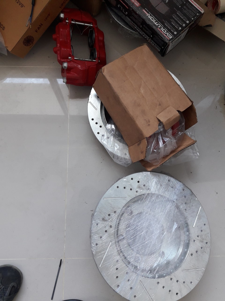

    I have the tundra brake upgrade kit for the tacoma.
    It won't fit on my truck.
    It's the best kit they make. Big calipers and the drilled and slotted rotors with the sink coating and carbon pads. The tigerr is a cross between the hilix and the sr5. my rotors bolt to the hub where the us tacoma it slides over20210306_111109.jpg

    Yeah the Tacoma uses "Hats" for rotors. My 2016 Hilux is the same platform as the 2016 Tacoma. Everything I took off my Tacoma bolted right onto my Hilux here. My Rear disc brake set up is off the Fortuner which is likely the same as the 4runner.
    Your Tiger is probably just like the Sr5. The new Tundra stuff will not likely fit with out mods would be my guess due to the platform changes. As they say in modifying vehicles..."Its always something"
