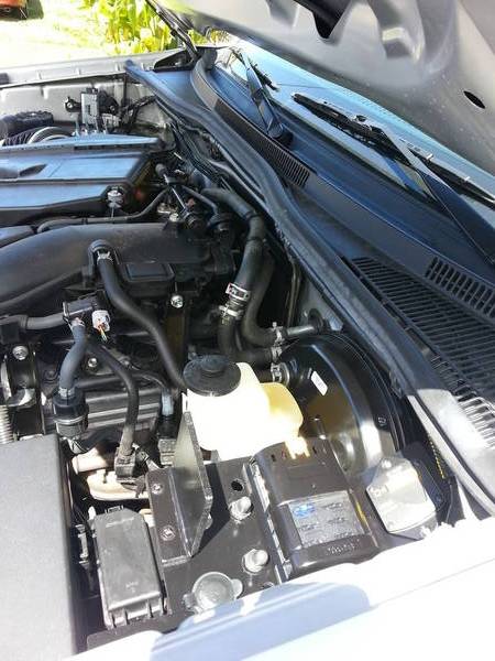

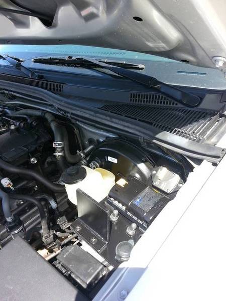

    Here's my aux fuse panel. Not wired yet. 100 amp breaker by the firewall. Same fuse box everyone else running next to that. Forward of that are two switches. One will be for my 12 volt outlet. Haven't decided what the other will be for yet. Was running out of room so I made a vertical section to mount relays to. Had to omit the section that could've made more room inboard cause hopefully someday I'll be able to mount a catch can over there.
    Made it out of some thick polycarbonate I found. Don't know yet if it'll need any reinforcement/support yet. Just gonna keep an eye on it.
    Built this to keep me busy while more funds were being raised or waiting for more parts to come in.

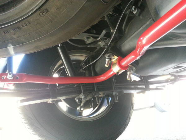

    This was my first try. Tundra racing drop kit. Flip kit and flipped shackle.
    Added the hellwig rear sway bar. 3/4" if I recall. Big difference over no sway bar. Wasn't impressed with the rubber bushings on the sway bar side of the end link. Was considering going with polyurethane mounts and bushings but decided to try something else instead. Highly recommend going to home depot and getting regular nuts instead of the deformed thread nut they give you. Plain old double nut. 9/16" fine thread I think. Then would suggest plastic dip spraying everything. The end links rust in no time. Plus the shiny new hardware kinda stands out.
    I also added hellwig helpers to keep from sagging as soon as I put anything in the bed. Jury is still out on those. May try running without them after I finish the front just to see. Couldn't just add a leaf since it is a flip kit. No way to be sure the lift from the spring would compensate for the amount it raised the axle or dropped the body depending how you look at it.

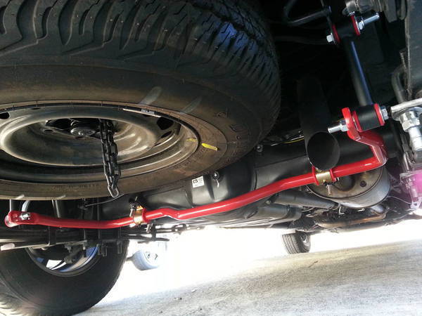

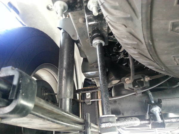

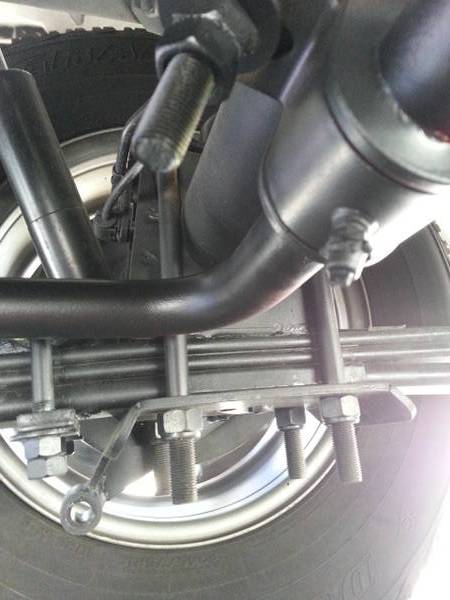

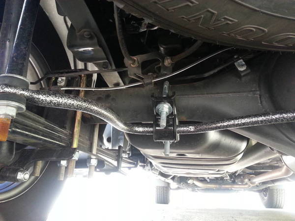

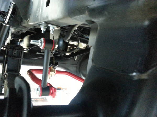

    This is the new setup. 1-1/16" rear sway and qa1shocks from XII performance. Mounting kit is from tundra racing. Both companies were awesome to deal with. Us Hawaii guys forget about time zones. Amy at XII was worried that everything wouldn't work which was kinda true. Out of the box, no go. But I knew that before I even decided to go this route.
    Sway bar was massive. Wider, thicker, and heavier than the hellwig. A lot brighter too. Not my thing but since they went through all that work I can't see myself painting it black ... yet. Came with the poly mounts. From energy suspension. Greasable. Worked pretty well with the tundra racing ubolt and mount. A little tight. Like it took me 30 minutes just to get em where I could thread the nuts on. The endlink-sway bar bolt doesnt quite fit in the sway bar. Gotta remove the powdercoating. Was a you gotta be shittin me moment. Then, never mind, i got this. Oh, and there's an up and down for the bar. Mounted the wrong way, the bar blocks the rear end plug. After I finished the first endlink-frame mount and was mocking up the second I noticed that issue.
    The tundra racing kit was pretty straight forward. Had to drill one hole on each side of the frame to mount the bracket. Took me about an hour and a half. I'm weak, had the wrong bits, had the wrong drill, first extension cord didn't reach ...etc. The end links are massive. The bracket will bend before they do. The hardware is all nylocks. And I hate nylocks. But nearly everything from tundra racing is nylock so if you want to run regular double nuts, let em know when you order. They also sell the kit with the Toyota sway bar but after I saw the XII bar I couldn't bring myself to get the Toyota one.
    Qa1s. I never had shocks I liked this much. You dial em in for what's comfortable for you. First I had em harsh around 11 clicks but worked my way down. Now I'm at 7 clicks and there's no harsh ride. Combined with the new bar, bushings, and end links, the truck rear end wise drives better than my 06 mustang gt. If I can get the front like this I'll be impressed.
    one week later. Noticing a bump sound in the back going over speed bumps. The sway bar-endlink bolt is a little undersized and has some room in the end link bushing. Can't just get a bigger bolt cause it won't fit through the sway bar. When I have time maybe I can see if I can change the bushing on that side to a smaller diameter. Spayed everything with plasti-dip and noticed the sway bar is actually moving side to side. Paint pushed back near the axle mount bushings. Ordered a couple of collar clamps like the fronts' to see if that makes a difference.

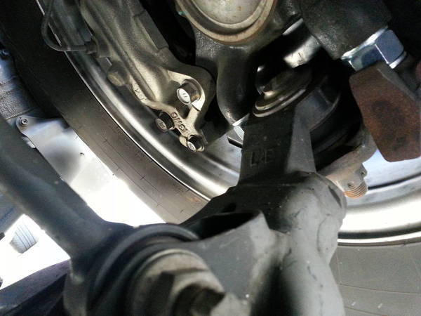

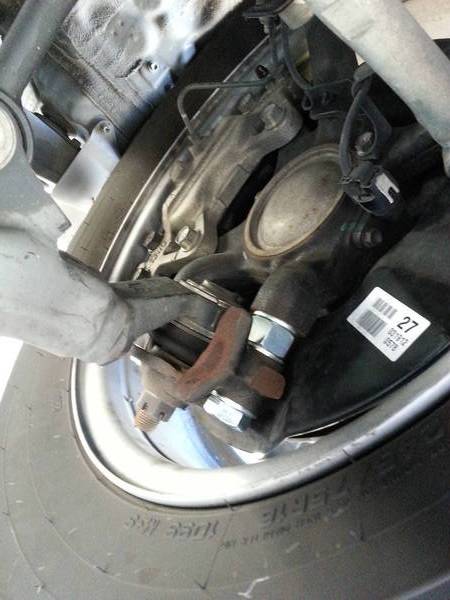

    Did the spindle spacer mod this morning. Kinda big difference both visually and dynamically. Camber is starting to make me uncomfortable but it ain't as bad as what those guys do to Hondas. Brought it down about an inch. Now my truck has rake. The caster is way off, especially noticeable when I turn the wheel. No word on my control arms, would like for those to come in soon to adjust the camber at least. Handling wise the truck seems to rock forward and back less. Less diving when braking and less rocking back when you step the gas.
    For the spindle spacer mod I used the 70 mm length bolts. M16-1.5 x 70 mm. For the spacer itself I used a 3/4" nut sandwiched between two 3 mm thick m16 washers. Came out to about 1". I started by breaking the two bolts to the spindle. Needed a breaker bar and a pipe. Then broke the lug nuts. Then jacked the truck up, took off the wheel and unbolted the spindle mount. Used a long bolt to maintain alignment in one hole and then used the pry bar to wiggle the spindle so I could get the three spacer pieces in. After that, loosely bolted that portion in before removing the other bolt. Repeated the prying to get the next set in and then tightened everything down. Repeat for other side.
    One thing I would've done differently would be to disconnect the sway bar. I dunno but it seemed it added a little tension. So far the sway bar isn't hitting the springs. Which was happening before I shimmed the sway bar mount. Might change when I put the bigger sway bar in.

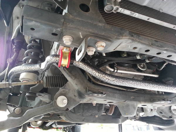

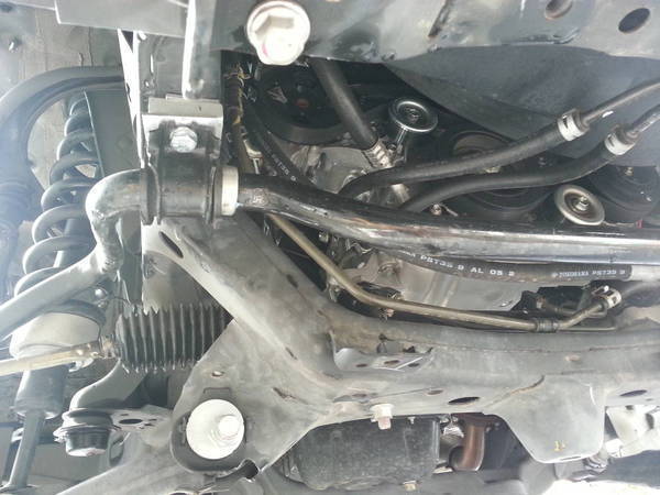

    Out with the old, in with the new. Old. Stock front sway bar. Mounted on a bunch of spacers. New. Hellwig 1-3/8" front sway bar. Had to get longer bolts. M10-1.25 x60mm. Had to make taller sway bar mount spacers. Temporarily a bunch of washers and 1/8" aluminum plate. Double checking that there's no interference while driving then going to ask a favor and get a correct one made. I'm hoping to make a custom sway bar end link. Currently running the skid plate bracket on 4 washers. Should've just removed the whole thing but ... where to store it? Will see where the sway bar sits after I figure out the end link solution.
    May switch the mount bushing back to the one that came with the sway bar. Running into some issues with the collar hitting the spacers. Wanted to try the energy mounts but they actually seem more narrow than the hellwig one.
    Handling wise the truck of course seems better. Definitely a nice flat ride. The truck feels a lot like driving a go kart minus the accerlation. Its easy to forget the truck is as long or high as it is. Kinda takes the fun out of driving. The opportunity to try it out hasn't presented itself yet. Can't really take too many turns quickly in kalihi.
    Hmm... the new bar appears smaller in the pic. Its actually 1/4" larger. And a lot heavier.
    switched in the bushings that came with the bar. They're wider and taller so I was able to take out all those washer/spacers. There is a clunking noise when I crank the steering wheel which I'll try check out tomorrow. A shim or two may have to go back.

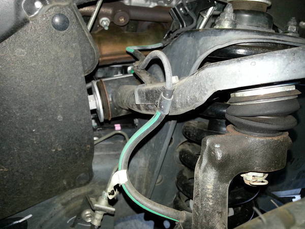

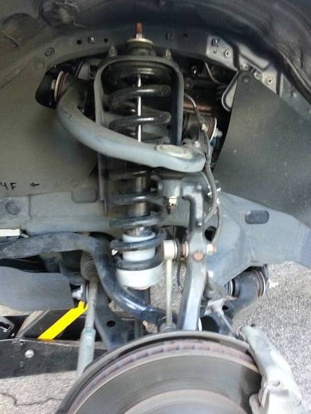

    Kinda skipped the pics for the tundra racing front drop kit. Its pretty simple and a straight forward drop in kit. If you can take off the shocks and take them apart then you can do this. You're replacing the original spring perch with a sleeve and another perch. If you're using TRD shocks there's a third sleeve since the of of those are smaller than the plain sr5 ones. From what I've gathered on here, the TRD shocks are the same but the springs are different between the of road and sport. I have an sr5 which is supposed to be the same springs as the sport. I found the sr5 shocks to be a little too soft so my next project is to swap out the shocks. Throwing my springs on some TRD shocks.
    The other part of the kit is to relocate the sway bar. In the kit is a 1/2" spacer I think. I still had some interference issues between the spring and the sway bar so in lowered the bar another 1/4". This maybe could've been avoided by rotating the spring a little in either direction but I was using a shops spring compressor and my truck was back at my house. Next time I plan to try to orient the spring a little differently to see if I can get away from using the spacers or reduce the thickness of the spacers.
    Here's what the upper ball joint looks like after. From outside since the wheels are so big, its hard to notice any camber difference. Can tell on the tire wear though.

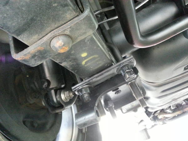

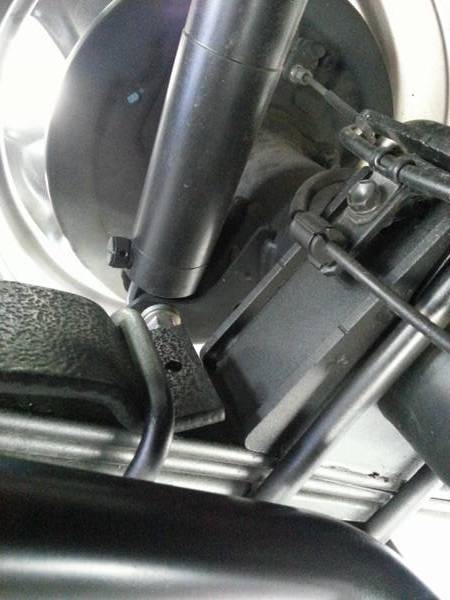

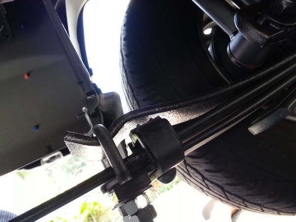

    Using the hellwig helper spring. It does bring the ass up a little but barely. Before and after bounce test on the rear bumper really shows how much of a difference it makes. Haven't hauled anything since I put em on but i think it helps to keep the truck flat. Bought it to try kill some of the forward-back rocking on the braking and accelerating which I don't think it did.
    When using with the tundra racing kit its difficult to get it close to the axle. Need to cut off some of the threads to allow the nut to get in there. Doesn't look that close in the pics but was a bit challenging when I did it. I wish I could cut off the unused threads on the rear clamp but being that its a spring, it'd be impossible to bolt it back together after. If you were planning to never adjust them or remove and reinstall then I guess you could do that. Wouldn't have all these bolts hanging off the bottom of the truck like cow udders. Bugs me every time I walk by the truck.
    Given the time and money I would've gotten airbag helpers instead. Out of the box they won't work with tundra racings kit but I believe only the bottom plate of the airbag kit would have to get modified. I hope to give this a try soon. Been putting off the camper purchase for a while now so I really need to start saving for that.
    added couple more pics showing the interference from the bottom plate and the forward set of clamps for the helper spring. Gotta use an open end wrench 11/16" to crank those down. Helps to start the nuts with the spring a little back then slide the whole thing foward just before it comes snug.
