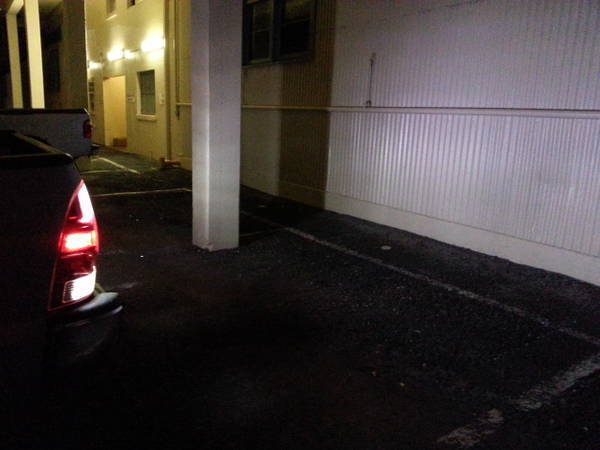

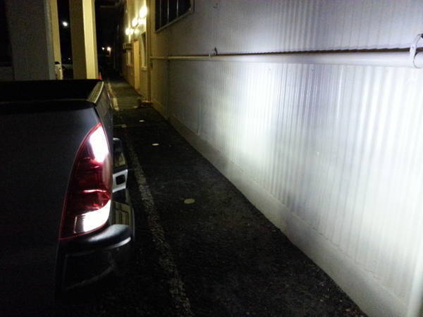

    Headlights and reverse lights on
    Reverse lights only
    Reverse lights, headlights, and hazards
    Camera view

    It converts the rear turn signal bulb into an additional reverse light but still retain the amber turn and hazard ability. So now, in reverse I have double the light without adding any additional lights. The offroad guys will just add another light under the truck. Wouldnt work so well when the truck is low right? Not sure if this as good as mounting another light but its a lot cleaner and you're modifying a system already in place as opposed to adding another system.

    ok i get it! sorry kinda slow somtimes lol! so did it make a big difference while reversing. A lot more visibility?

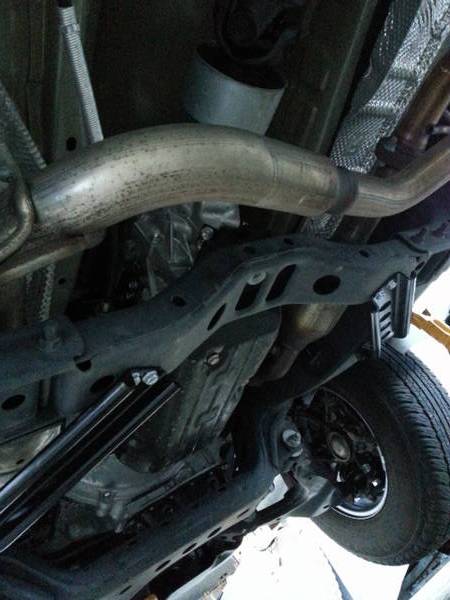

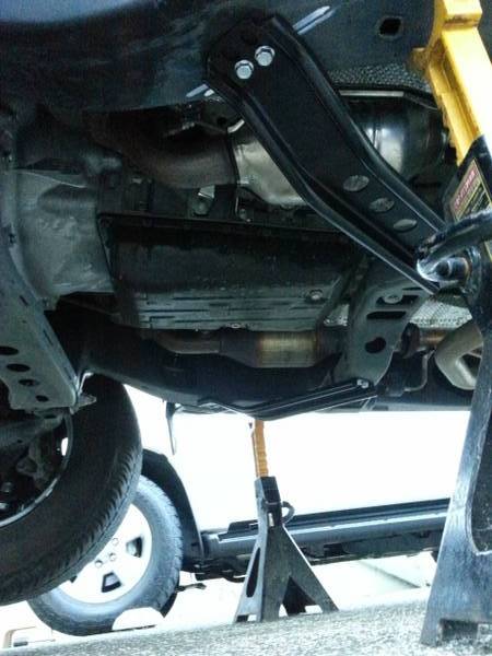

    More cross member brace shots. I like em even though I think they might not do anything. Damn, they look way cooler in pics than in person.
    The correct ball joints for the light racing control arm came in today. If I had got them the first time, that would've been one of the easiest major components I've ever swapped out. Almost as easy as swapping out the rear shocks. And looks like we can get the camber and caster taken care of. Will take the truck in to get alignment and see where it stands. Fat bobs garage is pretty good about taking care of their customers. For us guys in Hawaii its a big deal when a company finds out if they can squeeze parts into flat rate boxes instead saying we only do fedex or ups. Plus the follow through on fixing a mix up from when the parts were packaged in china. A little stressful experience but not enough to piss me off. Gonna add a list of cool companies/people to my first post.

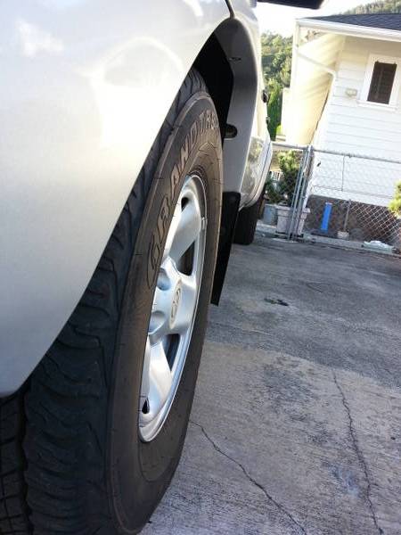

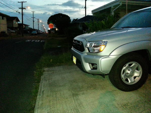

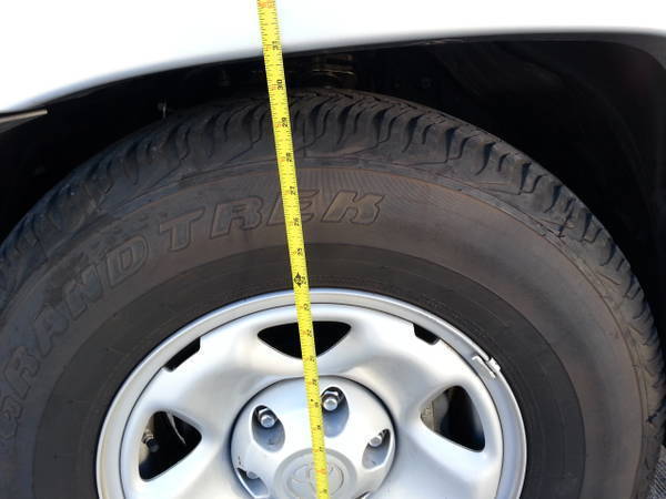

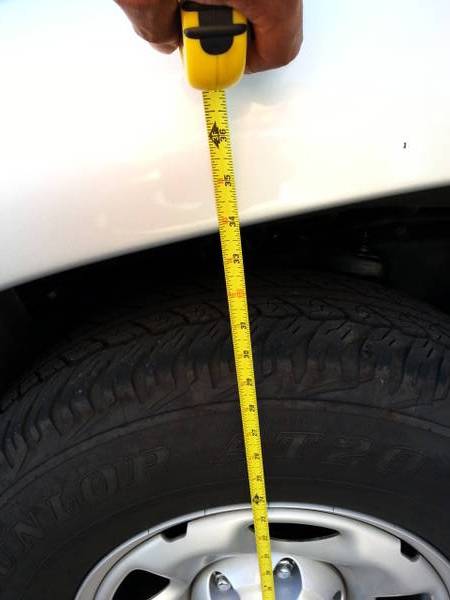

    Yes and no. I've decided what size and what color. Have couple ideas but id like to adress the front shocks/springs.
    The factory ones don't dampen enough and I think the springs are a little too soft right now. Don't want piss in blood stiff but going through certain turns, especially if there's a dip in it, you can feel the springs oscillating a little in the front. Stiffer sidewalls might help but dunno.
    Was looking at the TRD bilsteins and noticed there's a 2-1/2" extension on the bottom. The xrunner doesn't have that. Trying to get in touch with buck and amy at XII performance to see if their stock height performance springs will fit ID and profile wise. If the compressed spring length is the same and the shock length is different by 2-1/2"'s maybe I can figure out a way to get that firmer ride by throwing those on the TRD shocks.

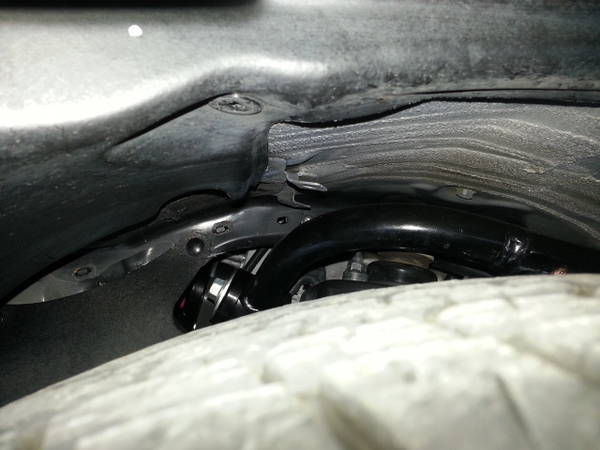

    Camber. At the inner most position on the upper control arm so there's a lot more adjustability available for the alignment shop to work with.
    All in all, almost there. Over budget but getting better handling and ride than I initially expected. Think my wheels will have to wait til next year. Plus gotta find money for a camper. Been putting that off til I get my front height set. Then the camper and then set the rake in the back (maybe helper bags). Then suspensions done.

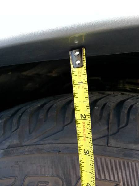

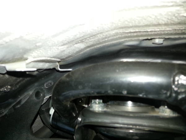

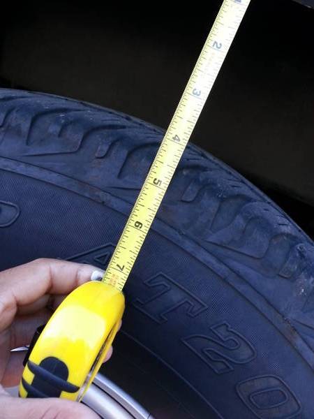

    Stuck my head in the front wheel well and found out I don't got much more room before my upper control arm hits the inner fender. Was going to add a half inch spacer to my spindle mod but I'll be banging the fender. So, don't think I'm going any lower except for smaller tires. There's no way to catch up to you 5 luggers ... without taking drastic measures. Anyone cut and weld a spindle before?
  20. Aug 27, 2013 at 8:33 PM
    #60
    CBoy808
    CBoy808 Sticker Making Dude
    Mar 21, 2013
    #100265
    1,717
    Tacoma Mall Crawler
    looks good man! Yea if you wanna go lower gonna have to go lower profile tires hehe.
