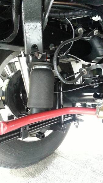

    Got ahold of some 3 leaf springs and got around to installing them. Also threw on the airbags to see how they look.
    Brackets for airbags
    Airbags installed

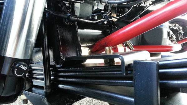

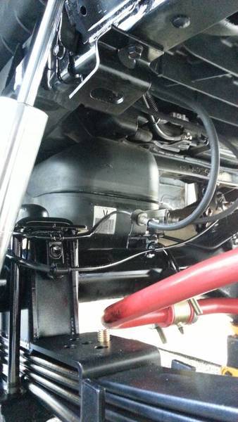

    Install went pretty smooth. No actual problems. I did change out the rear bushings on the leafs just because I had the energy suspension ones.
    The current setup for the bags:
    airlift kit 59564
    I am using everything except the bottom plate. I thought it couldn't be salvaged but its working so far.
    Ridetech
    2.5"leaf bottom plate
    I bought the whole damn kit and ended up only using the bottom plate. but good news for anyone else. they sell the plate separate.
    Issues
    The leafs brought back about an inch of height so I'm debating the best solution. I'd like to add a 1" block but there's a bunch of issues. I'm not sure how low the springs will end up and I'm going to have to pick up longer u-bolts. it will also bring the sway bar very close to the bags.
    The bags currently aren't long enough to lift the truck by the frame. if I take the truck to get work done I'm going to have to remember to remove the bags. I can't use a plain free floating bag and cup setup because there isn't enough room. I have an idea similar to that but I gotta see how much room I got.
    I still haven't put in the coilovers in the front so I'm probably not going to mess around with the rear too much until then. planning to put some miles on this setup first to see how it runs.

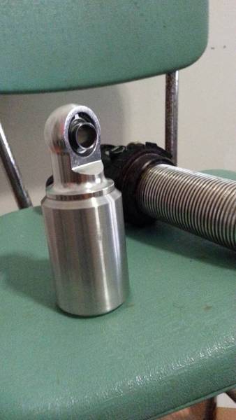

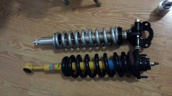

    Couldn't install the coilovers because their overall length was too short. Came up with a solution (which we haven't tried yet) and one of the local TW machining specialists cleaned up the design and fabbed it up. So here they are assembled and ready to install.
    And next to a stock strut.
