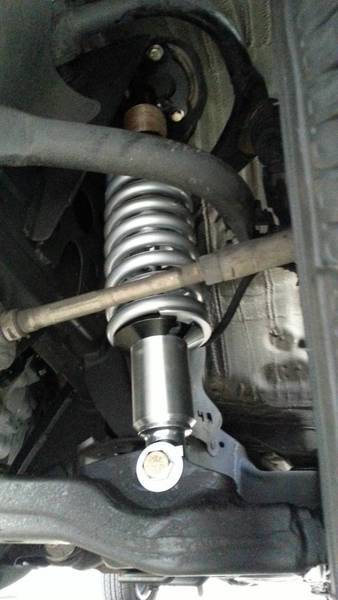

    Yup. 3" long 2" aluminum roundstock. its pretty hefty but the whole setup is still lighter than the stockers. without taking anything else into consideration, I will be starting off with 2"s of drop because of the shorter than stock overall length. no, engineering on this puppy. just trial and error.
    Heads up on the bags situation. the bags were rubbing the abs sensor wire clip on the back of the blocks. got 1" spacer blocks in the mail from TR's tom. if that don't help them clear, I'm going to move to the next hole on the bottom bracket. also trying to get in touch with airlift and ridetech to see if they have longer 4" bags.
    Going to also revisit the cut spindle project. I figured out a way I think would fix the steering tie rod angle, sway bar endlink location, and upper ball joint location. hopefully I can get to it in a couple weekends.

    mean build, I was wondering how much you additional length you needed? I wonder if a front strut spacer from a leveling kit would have worked.?

    If you're talking about the ones that go on the coil and under the hat then that won't work. The shocks max extension would still be too short. If I got the ones that go between the frame and strut then those won't work either. The pivot at the top of the coil over would end up changing the strut angle which would add a lot of sideways force. Kind of like how people bend the bottom of the factory shocks.

    Damn!!! Iven made that? Sick! I saw the blank stock at his place before it was fab'd. Looks like it came from a factory!!!:cool:

    Haha. It did! TW east side factory. The sad part is, I haven't had a chance to put them in yet. Was planning to wait til Thursday night but thinking of pulling an all nighter tomorrow.

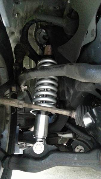

    Installed!

    Feels pretty good. Just added 1" spacers to the rear so I'm sitting pretty level. 30-1/2" front 31-1/2" rear ground to middle bottom of fender. Finally got to use the qa1's the way they are supposed to. Adjusted both the fronts and rears to match. Before, because of the nature of the suspension, one always felt looser than the other. Now, it's dialed in to a pretty firm ride without being stiff and jarring. I believe I'm at 10 in the front and 8 in the back. Still bottom out occasionally but fairly rare. There's no rocking on acceleration our diving on braking. I'm actually really happy so far. I can't pound the corners just yet, i haven't fixed my spindle angle issues so I'll probably clean of all my wheel weights with my sway bar if I try. I am going to be trying out a different airbag but I probably won't get to it for another week. Those are my expensive ass bump stops.
    Really happy with the parts and work so far. The end seems near (suspension wise). Wish I could've taken a pic but no chance for photo op this evening.
