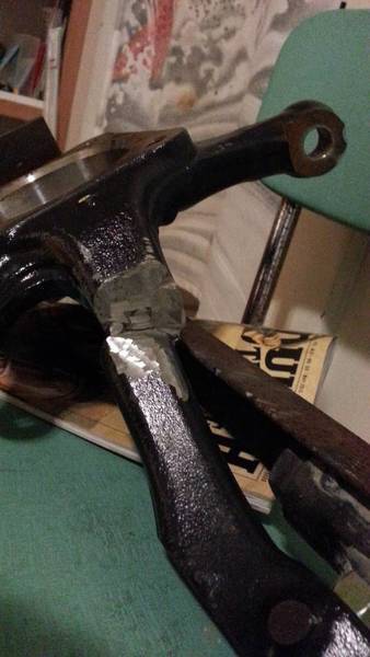

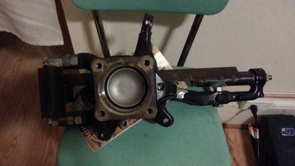

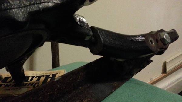

    New piece cut and bolted into fixture. took out about an 1-1/4".
    Two of these nuts are part of the fixture. the other two simulate the spacers already on the truck.
    This shows the offset needed to keep the upper and lower ballpoint in their original alignment. kinda dramatic but can't help. going to see how big that weld will have to be. also probably adding some guesses later.

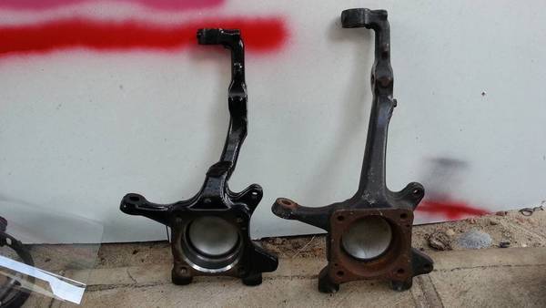

    Chopped on the left and factory on the right.
    One side down, one to go.
    Updated.
    Side view of original, first try, and current version.
    All next to each other.
