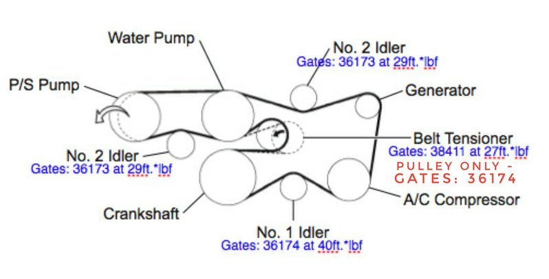

    I doubt your alternator pulley is bad.. Take your belt off and spin each one by hand . Here's a diagram to put it back on(v6) and the Gates part numbers.

    4 idler pulleys, one of them is on the tensioner arm.

    The tensioner certainly can have just the pulley replaced. I did mine. The diagram I posted has both part numbers.

    awesome info ... I read from page 18 to page 28 (last). Seems pulley number one (lower) can be used to replace the tensioner pulley when used without the back spacer.....Right? Good.

    Yes, use the other pulley for the tensioner. That's where I got the number for my diagram. I did not use any antiseize or thread lock, just torqued them.

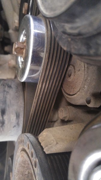

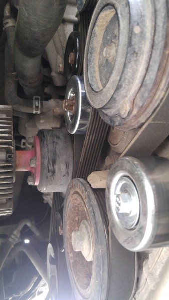

    Uhhmmm . . . Why is it only sitting on half the pulley ? 20161103_150714.jpg 20161103_150703.jpg

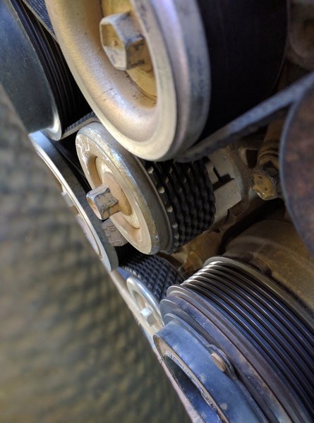

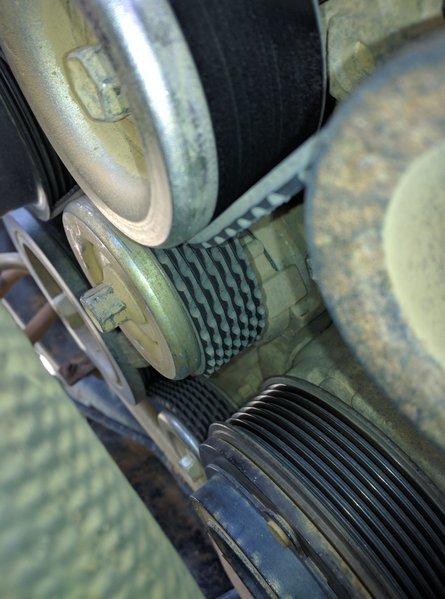

    You use the right pulley? Some people on the FJ thread had an issue. I did not.
    A couple shots of mine. The belt sits towards the edge of the pulley but it's fully on it.
