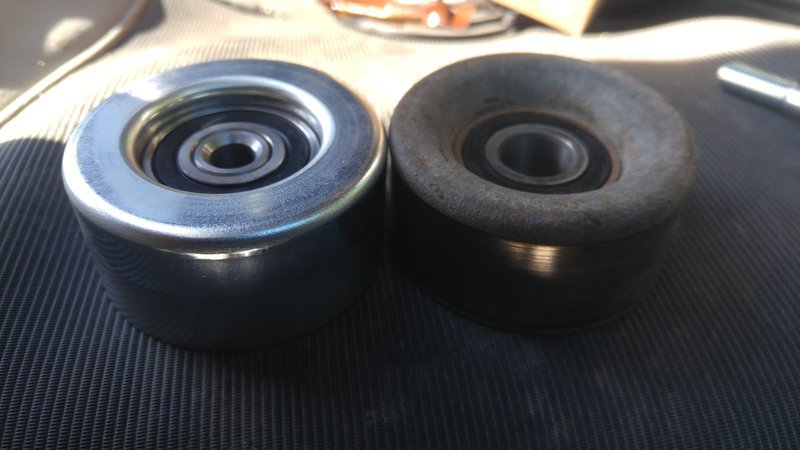

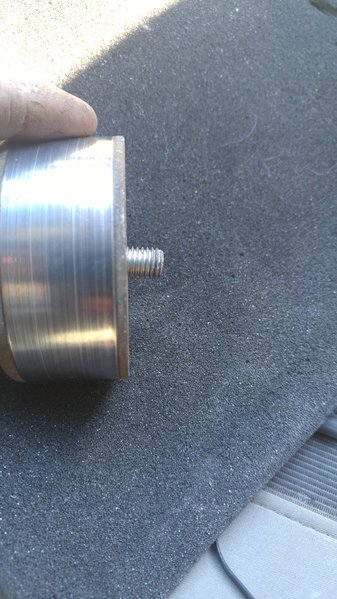

    Second pic shows that the tensioner pulley is the same as the lower (#1) pulley

    What order did to put the spacers/bushings on?

    There are no spacers or bushings installed just the double bearing pulley

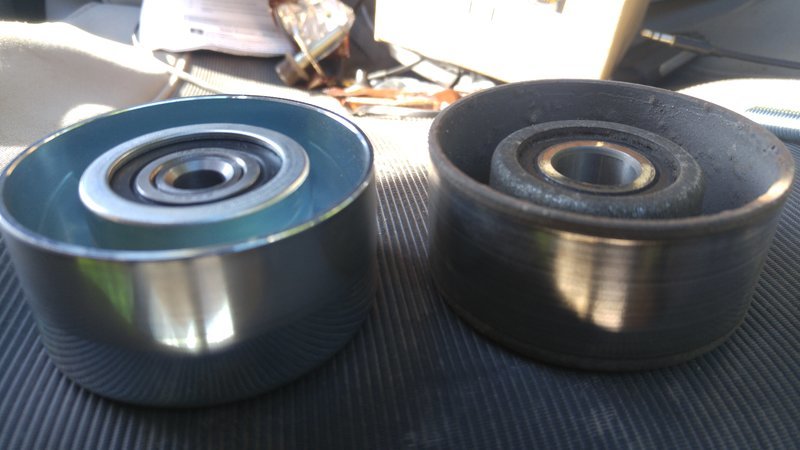

    The offset of the original is much shallower than the new one.
    Also had to use the original bolt as the new one was too long and a different thread

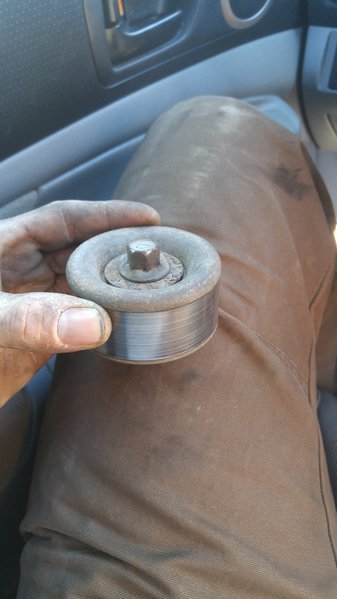

    Can you pull it off and take a picture? Specifically with the old bolt through the bearing, front and back.

    Itll have to wait till Monday... headed out to Niagara falls early tomorrow morning.

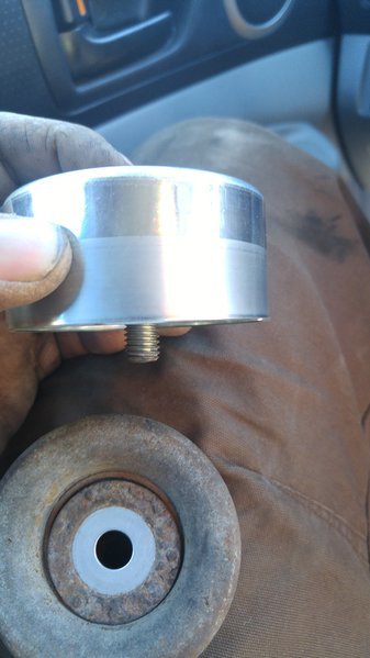

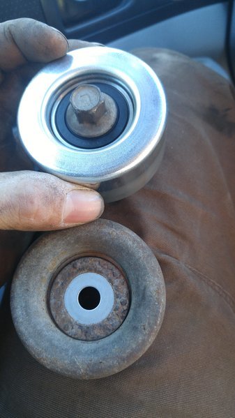

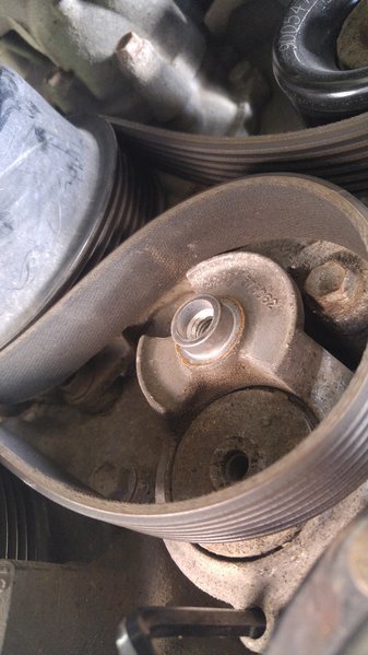

    Ok I'm back. Here is the new #1 pulley and the old.
    20161106_122539.jpg I figured out that the old slots over this thing on the tensioner arm
