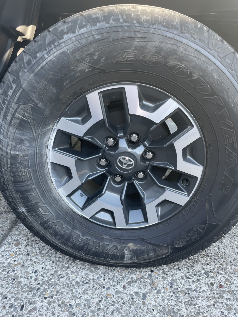

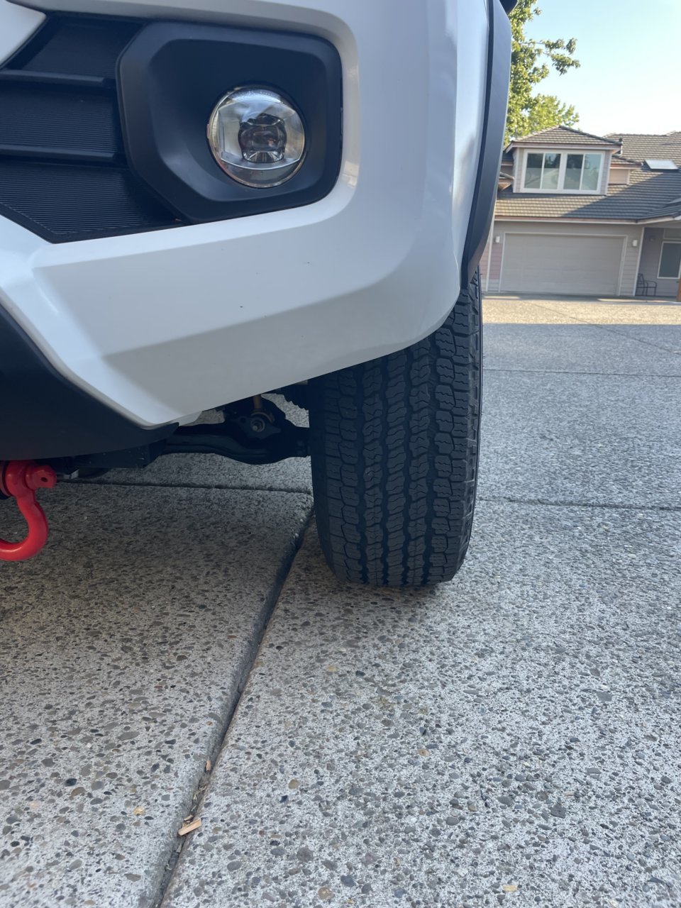

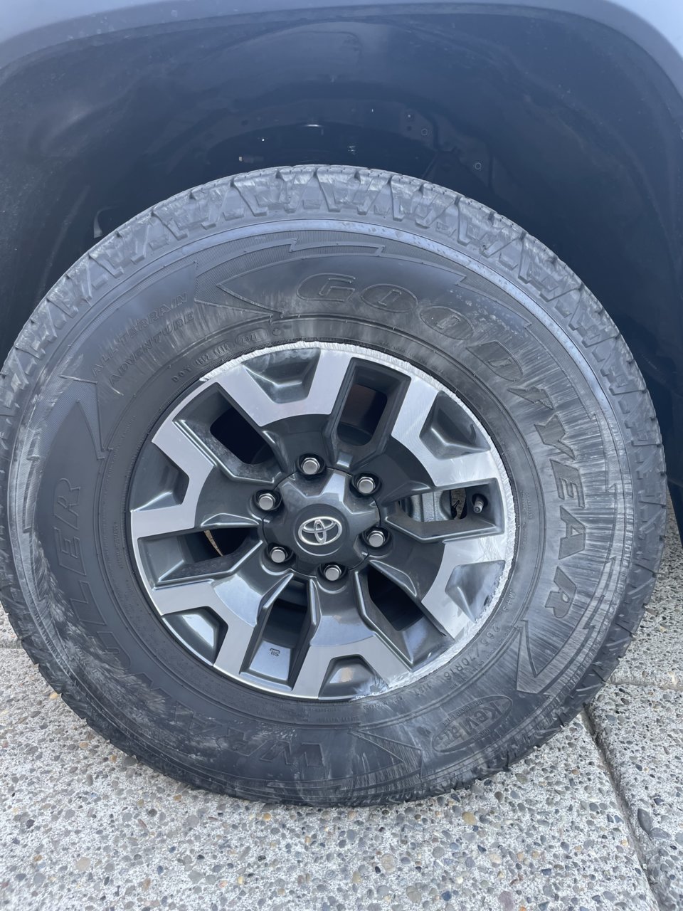

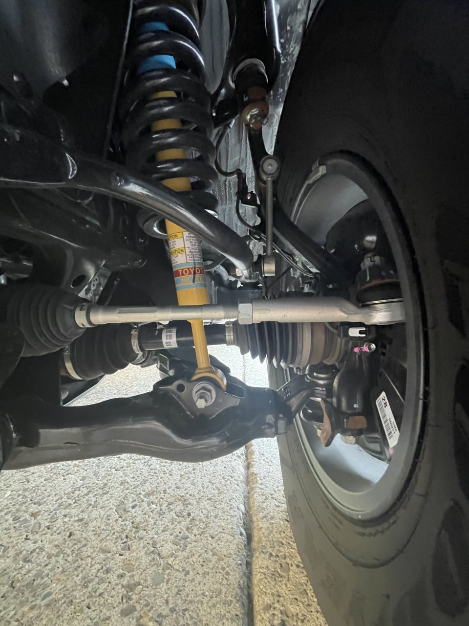

    Hi everyone,
    I hit a curb going about 50, scratched my rims pretty bad and definitely threw my alignment off. Now my steering wheel is crooked when I’m driving straight. Truck pulls to the right. Also after impact my vehicle stability control system and pre collision system started flashing on my dash and said “go see your dealer”. Not sure if anything is broken or not. Toyota can’t get me in their shop until next week. Anyone have an idea of what I might have messed up?

    Is your spindle bent?

    That first picture, take it exactly like that to compare to the other side.
    To see if the knuckle is bent, compare the distance from the tire to the knuckle on each side.
    The truck is unhappy because it wants to know that straight is straight, the abs sees a crooked steering wheel.

    I slid into a curb long ago with a toyota pickup, same damage as you. It actually twisted the frame where the lower control arm bolts on and needed to go to a frame shop to get it straight. New left suspension also.

    Get an Alignment and chick your spindles to see if they are bent or not.
    As for a flashing light, vehicle may think you were in a collision and the only way to reset is is by going to a dealership and having them do a calibration test.

    Alignment is out and that's the cause of the VSC alarm. Beyond that just check for what's bent. Tierods, knuckle/spindle, etc.
