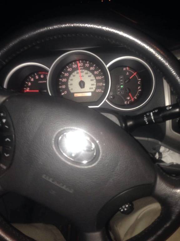

    Hit a deer at about 55 mph, most of damage was done to bumper and front driver side tire. The VSC started beeping on impact and now my VSC light is permanently on. I can't tell if the vehicle is out of alignment or if something is bent, the pic of the steering wheel is how much I had to turn the wheel to stay on road to get to town, what's y'all's opinion?
    Thanks

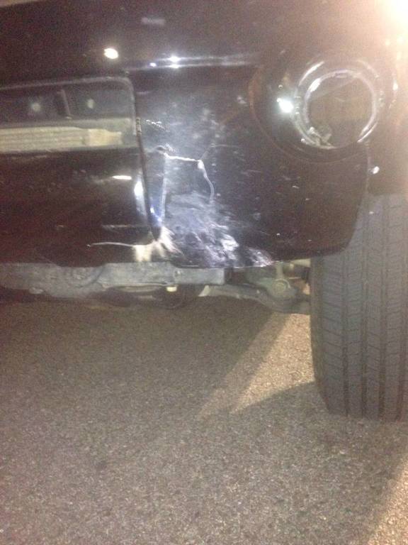

    Thanks didn't know I could do that but it was dark sorry for the quick pics. Nothing looked bent I have the 5100s at 2.5 and everything seemed tight I had no vibrations which makes me think it's just out of alignment

    Take a look at the LCA alignment cams, my guess is the tabs are flattened. Just get under there and see what's going on.

    Yea I had it towed to the local body shop didn't want to risk it. My main concern is why would the stability control activate/beep when I made impact?

    When I had a wreck and my steering wheel was like that i had bent my steering knuckle

    Damaged wheel speed sensors?

    Good input I will check that out for sure impact was hard enough that I my fog light got punched out, literally searched for it for 2o minutes and couldn't find it.

    Update couldn't get it to hold an alignment so next step is replacing steering knuckle and see if that helps. Fender has to be reshaped and after all body work got quoted around $4,200. Let's hope insurance covers it all
