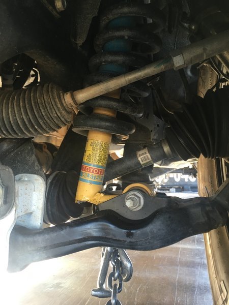

    How fast were you going and how big was that pot hole?
    Gotta be another reason for that happening?

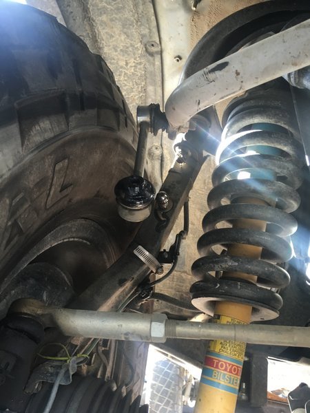

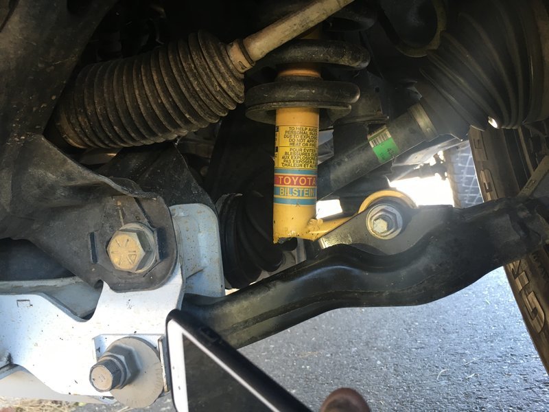

    From the photos, the bumpstop extension blocks that came with your 6" lift weren't long enough, so all the compression forces went through the shock instead of through the bumpstop. When you get Kings/Icons, also look into longer urethane bumpstops, example: Additional spacers:

    45 and didn't see the pothole and yes 6 inch lift at first I thought it might have been the spacer that broke or something with the lift but it's all fine.

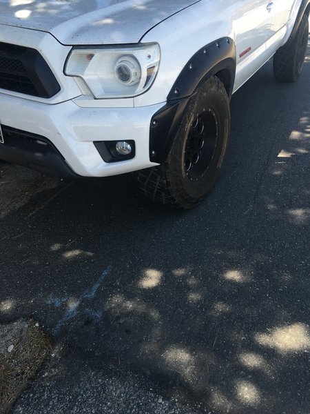

    It felt fine just weird driving sideways the only thing that rubbed was the tire and the flares

    Good Lared that musta been a nasty deep pot hole to do that at 45mph!
    Busting the Bilstein and the Sway Bar hook up? That's some serious impact.
