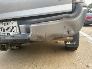

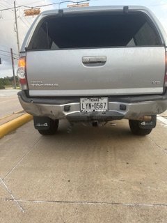

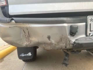

    Just got rear ended by a little ol Lexus. Smashed them up good, but my damage is only bumper, maybe some, trailer hitch connections, and a camper shell back glass. Wondering what else I need to be on the look out for? Going to take it to Caliber Collison repair shop here soon. Anything I should request? Love my Tacoma!

    Do a 4 wheel alignment check to see if the truck is still straight. They may also call it a thrust angle alignment check.

    The trailer hitch on these trucks hangs below the frame and applies a lot of leverage in a rear end collision with car. A quick way to check for damage is to inspect the body lines between the bedsides and the cab. Another method is to measure your wheel base, if it's not factory spec or it's different from right to left something is bent.

    Unless you know and trust the Caliber franchise manager, you might shop another vendor.
    They are kinda like going to HD for lunch on a Saturday because they have a hot dog stand set up when you really have a craving for a proper Chicago dog
    We see a lot of buckled frames from hits like that, so proceed with caution.

    We see a lot of hitch hits that actually bend the frame!
    Find a good shop!!!

    Totalled maybe if the frame is bent.

    I've been driving it since and seems ok, but I know that doesn't necessarily mean it's not buckled or bent. I don't know any good shops and am just using Caliber because it's close, convenient, and on the State Farm Insurance selected list. Anyone know a better shop in NW Houston around Cypress?

    Happened to me....The other guys insurance paid me $2800 dollars. Caliber Collision told me the frame was fine. I bought a used Hitch Bumper combo for $100. Good Luck!

    just get an RCI rear bumper. Skip the collision shop and take the payout yourself :D
    Can't get a 4 wheel alignment with a solid rear axle. But any alignment will show thrust angle.
    Tell them you want the payout. Insurance will tell you that you can't.
    Notify the state department of insurance (state not federal) and wham your insurance will pay out ASAP.
