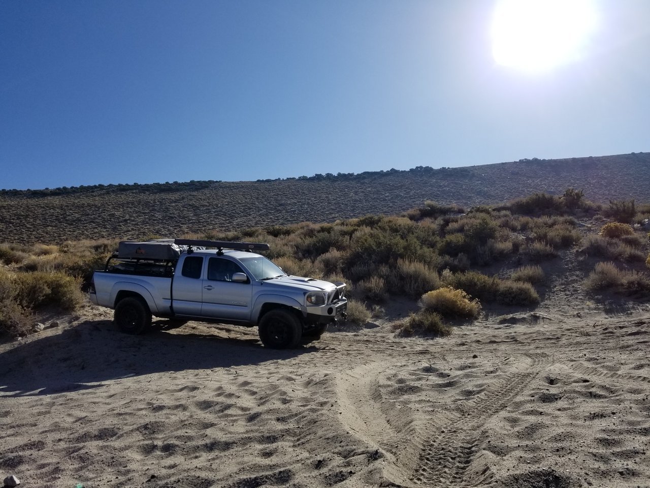

    Actually in a middle of a road trip. Hit a pothole going about 20mph. Steering wheel is way to the driver side. Truck still drives straight but having the steering wheel like that bugs me. Is there a way I can straighten it out? I will take to alignment shop when I get back home. Did visual inspection 20171012_101030.jpg and nothing looks abnormal . 2006 taco 4x4.
