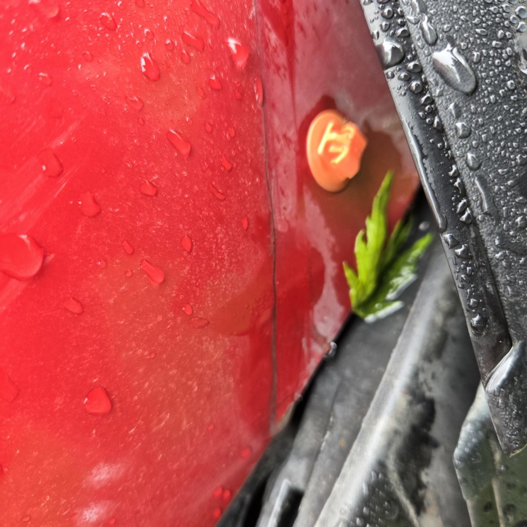

    Looking at the pics & BS parts list, the left fender is ok? I can see what appears to be some minor alignment issues but may be nothing
    Like front grill to hood & fender to hood?
    Looks like some scuffage in the fender paint up front, repainting?

    It looks like the fender pushed in with the bumper cover which broke the headlamp housing :notsure: the repair facility probably wants to bend it back and repaint it

    condition of the lh fender.

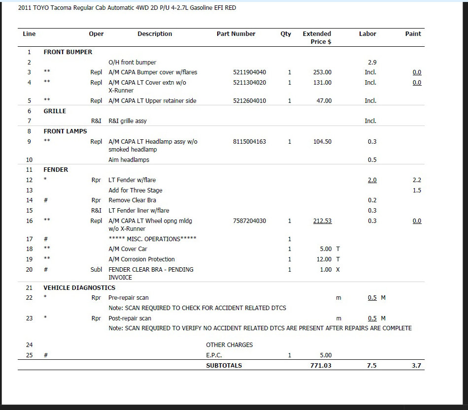

    preliminary estimate with intended parts to be used...
    any genuine comments about this?
    i have a number of concerns

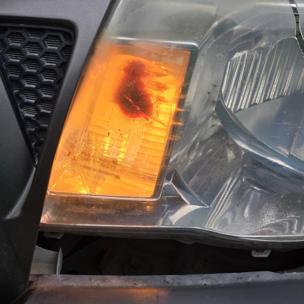

    The conventional bulb for the parking, turn-signal and DRL's in the 2.5 gen lamp units is: 4157NAK (wedge base). I read somewhere that the "K" stands for "Krypton" which is supposed to help make them run cooler, to extend the life of the lamp. They were in there when I bought the truck: assuming they were the OEM bulbs. I replaced both at the same time about three years ago. The DRL's are on all of the time during the day and they are still working fine. No inner lens deformity so far, but don't really expect any a 2.5 gen headlamp unit. They (bulbs) were a little harder to find than the usual 4157NA.

    I am remembering the RH front turn signal went out couple years ago
    Picked up a new bulb from the dealership using parts diagram I had.
    I wonder if that bulb was the new and improved under the TSB :confused:

    I suspect the inner lens was improved. I remember the bulbs were a p-i-a to r&r. Very difficult to remove (I thought the sockets might be melted) and then kind of a two-step process to push in with a "click" when fully in place. They will hyper-flash if not fully seated.

    You do realize that they're using all aftermarket (not OEM) parts according to that quote, right? For many people - and all insurance companies - that's good enough. No matter what your insurance company tells you, aftermarket parts - even CAPA Certified parts - are inferior to what came on your truck. How do I know this? I deliver OEM parts for a large dealer group in New York State. I deal with collision shop parts managers all day long and all they do is complain about the quality of aftermarket parts. But the insurance companies really push them because they cost less. Why do they cost less? Because they're inferior.

    If you get new ones I'd install LEDs in there to prevent it from doing it again.

    TSB: https://static.nhtsa.gov/odi/tsbs/2011/SB-10060761-2280.pdf

    50+ years of auto policy covering many family vehicles over the past half century and the fuggers will NOT budge on an extra 200$ for Toyota grade headlamp housing...not even an extra 80$... which is what i paid (180$) for the right replacement housing from the discounted yota parts dealershop i use for genuine parts
    perhaps they know better that a keystone sourced a/m part is of superior quality and better fit form function than a genuine toyota part?
    it remains to be seen, i suppose...
    they are in the business of risk assessment and ought to know that anything that is Off from the original likeness, even the shade of gray plastic it is made of to any premature abnormal surface wearing (as compared to the toyota grade housing) will cost them anywhere from 500$ to 700$ estimated to make proper
