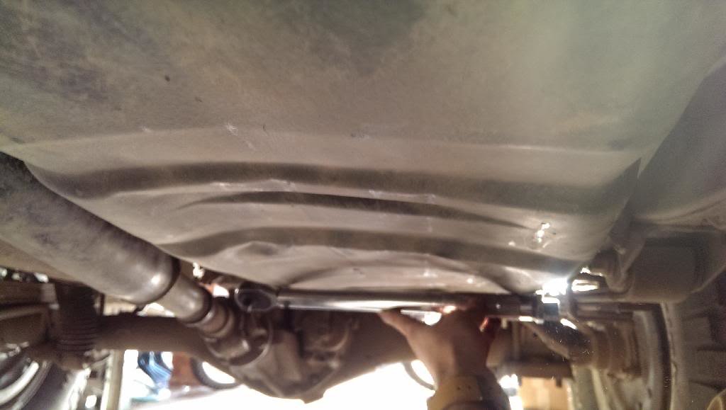

    That tank is repairable. It looks better than mine did.
    I 'modified' it slightly about a year ago:

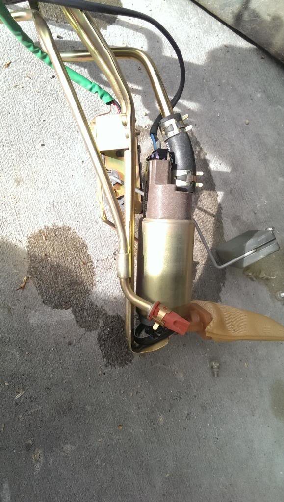

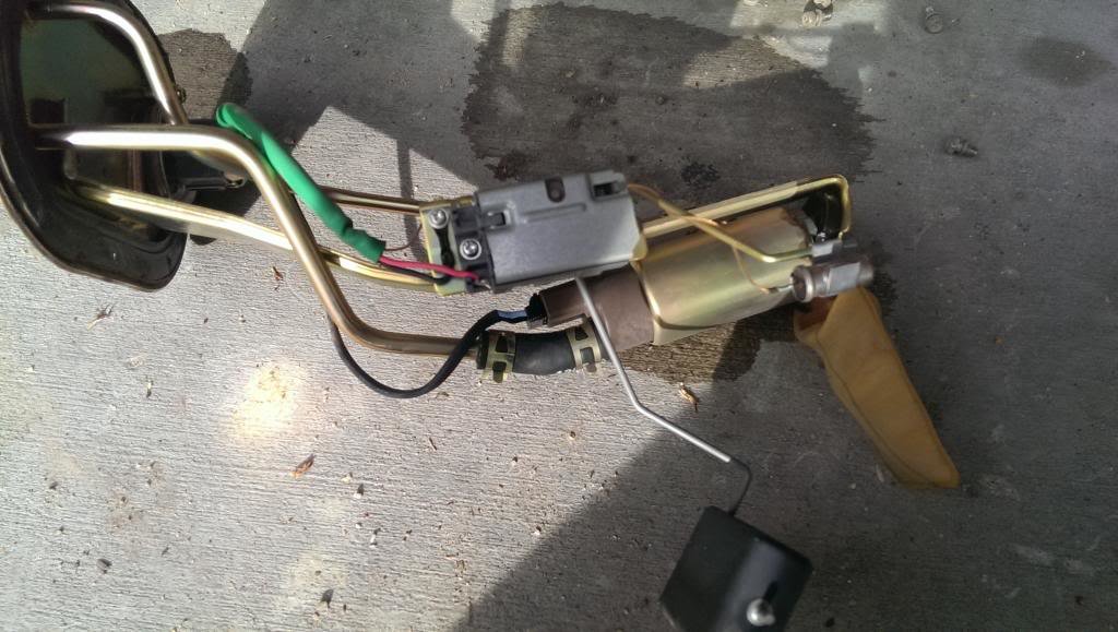

    And here's what the sending unit looked like (very bent):
    Drop the tank to get a look at it, really not to hard of a job. From there you can pull the sending unit and determine what needs to be done to it. I bent it back so the pump was for sure at the bottom, and then it took a little work to get the gas gauge float to function properly. There is a plastic baffle that the sending unit sits in, and my float was hitting this. Tied a string to it, bent it, and checked to make sure it wasn't hitting the baffle before reassembling. I was also able to pop a quite a bit of the dent out of the tank while it was off.
    Been problem free since then.

    I found some guy selling an entire gas tank assembly on craigslist for $180, do you think its worth getting? I haven't had a chance to look at mine now and probably wont until this weekend.

    just make sure you look inside to be sure it isn't rusty in there.
    I think the odds of that are low but better safe then sorry so bring tools and know how to pull the fuel pump to look inside.
    as to the value, I will leave that to others if the price is fair but as a rule, whatever they ask on craigs list I offer a lot less.
    so assuming others say this is a good price, my approach would be to offer $100 and hope to settle on $125 or $150 tops, I never pay full asking price and people selling never expect to get full asking prices.
    all that said you may not even need a tank so I wouldn't run out and buy it just yet, get under there and take several more pictures from different angles so the mechanics here can give you a better opinion on what to do.

    Pull the tank shield and inspect the tank. IF excessive tank damage is noticed ( which it doesn't look like it from the pictures) replace or repair tank.
    Replace tank shield.
    The transfer case plug......just leave it and make a note to replace it when you do the next TC fluid change.
    Everything else.....spray some paint and call it good.

    So i'm finally getting around to fixing this issue or at least attempting to straighten the sending unit and pull the dent out of the tank. I was curious if anyone knows the proper procedure for dropping the tank and pulling the sending unit out? Will I need a replacement gasket or anything? I'll take pictures as well in case anyone has this issue in the future!
    Thanks for the help --

    I pulled the tank, straightened the sending unit and knocked the tank out far enough that the sending unit can fit in there again being straight. I swear the dent was maybe 4in up in the bottom of the tank. The top of the sending unit was sitting about 4in out of the tank. No wonder I lost almost a gallon of volume from the tank.
    Does anyone know of any way to check the unit to make sure its working before i put it back in? Just in case It is just totally broken rather than just bent. then I can replace it now while the tank is off. Thing is a bitch to drop.

    ^This. Your gas tank looks just fine. I would suspect that the wiring from your sending unit got broken. Also, same as others said, the rest of your truck looks fine too. If it were me, I'd make sure the t-case drain bolt is still torqued, clean it and see if it continues to drip. If it does, be sure that you don't have a crack in the case housing. You may just need to a new plug.
    As for gas tanks... check out this thread. These guys ran bashed tanks waaay worse than yours for long periods of time.

    I bent the unit back, fixed the tank, and put it all back together but still no fuel reading :(

    In theory, the level sending unit is just another variable resistor, not unlike the throttle position sensor to the volume dial on the radio. Ive havent looked at one of these before but i am assuming there is a two wire plug for it, one with a sensor voltage (5V or less), and another for variable ground that is read by the DME or PCU (though some Asian makes supply the B+ voltage from the PCM and have a constant ground). So using a voltmeter you should be able to see some reading between 1V or less and the maximum voltage whatever it may be as you manually move the float. Only issue is, im not sure what your reference should be to what the correct voltages are.
    EDIT: I just re-read your last post. I wish i still had access to AllData for the wiring diagram from this car, you could easily find the corresponding wires on the chassis harness to trace the issue, though testing the leads on the plug for the sending unit will be your best bet.
