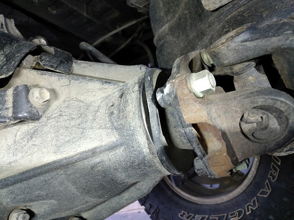

    Maybe the water pressure bent the rear pinion seal debris guard. I had this happen rock crawling. The guard then rubs on the diff housing with each driveshaft revolution. Once you get up to speed, the sound gets lost in the tire road noise.

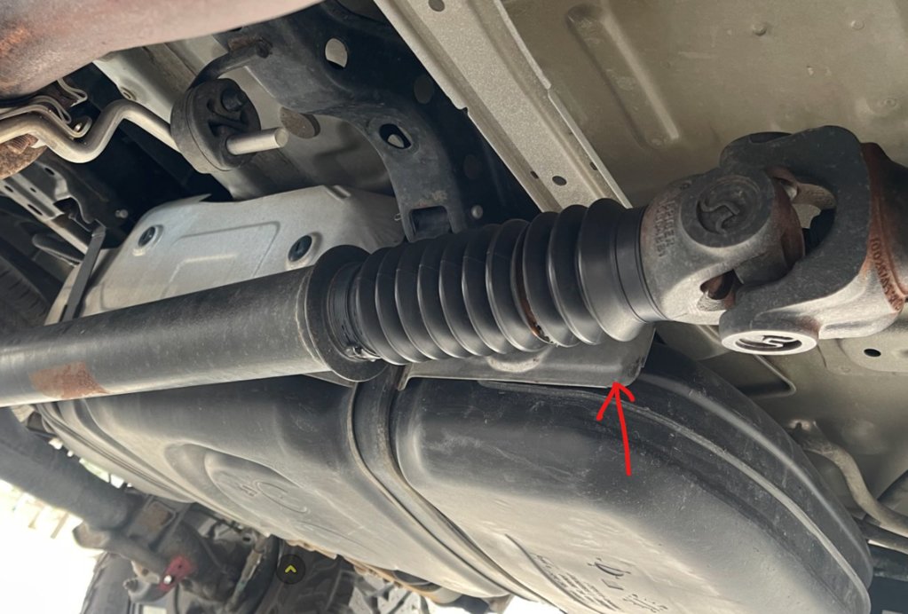

    Here's a post about it:
    https://www.tacomaworld.com/threads/drive-shaft-boot-torn.825366/#post-29595752
    This part does the cutting. Kind of odd that there are marks on this one but no evidence of being bent.
