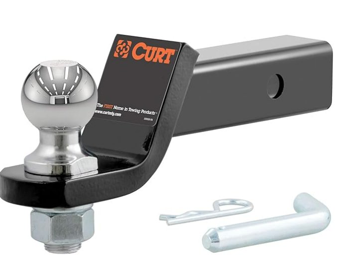

    Tongue weight the truck is rated to handle is based on a hitch like this:
    Not like this:
  12. Jun 26, 2025 at 1:18 PM

    The weight from the bikes is centered roughly directly between the bikes, so that is the point where the leverage matters. In this case, that's around 3 feet from the back of the truck. That is a massive difference. (talking about the pictures I supplied)
    A dumbed down example from Curt's website:
    "Additionally, it is important to consider the leverage placed on your receiver hitch and vehicle by heavy cargo. As a general rule, the use of extenders (and hitch adapters) can reduce the tongue weight capacity / vertical load capacity of your vehicle’s receiver hitch. Extenders under 12” long reduce load capacity by 25%, and extenders over 12” reduce load capacity by 50%."
